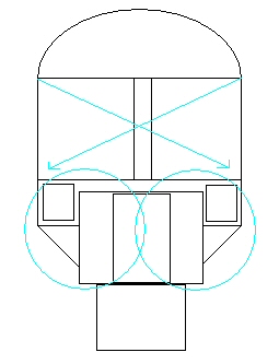

I have just completed the installation of two 5 lb. halon bottles. One bottle has two nozzles with one located over each of the wells adjacent to the back ends of the fuel tanks where all of the plumbing ports, fuel filters, tank supply/return/sender selector and fuel pump are located. The other bottle which is mounted under the dash also has two nozzles. The are located on the legs of the dash and are pointed, in criss-cross fashion, at the chest of the occupant on the opposite side of the car (see diagram below.) These four nozzles should provide a fire free exit path at a slight rearward angle from either side of the car. The front bottle is activated by a pull handle located on the console just above the ignition switch. This should make it very difficult to forget to remove the safety pin. The rear bottle is activated by a pull handle located on the firewall just to the left of the drivers ear. As one enters the car, the T-handle is right there and there should be no excuse for not removing the safety pin prior to getting underway.
Lynn

Lynn,
I like what you you have decribed in you Halon fire system. When you get a chance post some pics. I will be installing one soon and would love to see your system.
