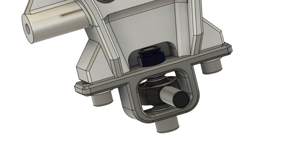

Anti-dive?

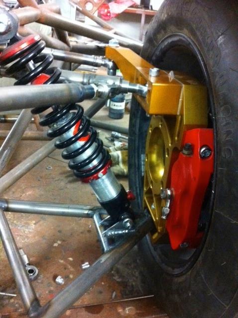

I’m not getting my head wrapped around that. It appears that the rear mount is maybe 1” higher than the front mount and the mounting holes do not share the same plane. So how will the control arm properly pivot?
Neil

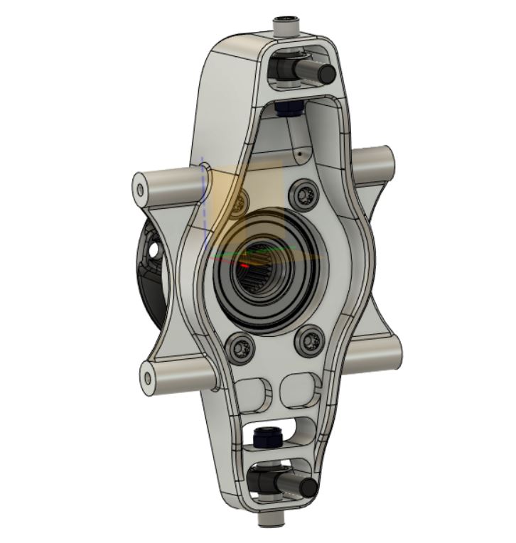

Randy, with spherical rod end bearings, the pivot points do not have to be in the same plane. As shown in the photo, the lower end of the rear upright will move forward as it goes up. Think anti-dive & anti-squat.
Watching again at your post 15th showing your cad front upright ; be aware to choice a sufficient diameter rod end in order to be sure you will have enought travel on whishbones ( 18 mm ID with hight reduced spacer is a good solution )
And why also not trying to have on top and lower bolts "double shear " arrangement (so you can go with very small bolt ?
And may be too have aprovision on upper or lower point for (double opposite threaded bung welded on the whisbone end) to help fine setting
This is a sample I did (years ago) for some UK good friend builder
This is asample
At the moment I plan with M14 rod-ends, my CAD says that gives me 158mm total travel.
I will go a bit bigger on the wheel carrier - we'll see
Hi
M14 will not for sure be Ok on uprights
1/ I doubt the travel will be ok ( beside you did a check :oops: )
2/ Means that in that area load will be "sustain" by 14- 1.5 mm say 12.5 real material diameter ... means really to use aerospace stiffness rod ends ( that are very very pricy )
A minimum of 16 x150 rod ends will be a safe decision
Hello Michael,
do you mean like this?
I use Fluro Motorsport rod ends

YEESSSSSSSSSSSSSSSSSSSSSS
Perfect !!!!
Where do you intend to locate the steering arm ?
Another "trick" I may suggest you if that arm is more or lest on top you can separate the top rodmount from the upright and join it to the arm and then do abolt arrengement onto a machined space on top of the upright ; so you could do your positive or negative set up caster without having to redo track set up ( look at the top of the front upright I posted)
Problem is ; with your kingpin angle ( very very unusual!!) it will be perhaps difficut
Apologise to go so deep on your design but have you really checked your scrubradius ??Aminimum " kingpin angle" of 7 to 9 degree is commonly used and from the view you posted seems you do not have such set up ... but again I am maybe missing something :rolleyes:
I just received Fluro rod ends today ; seems they are very good product for the price

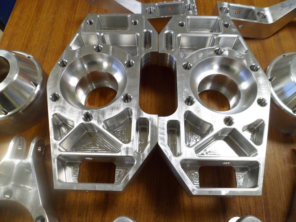

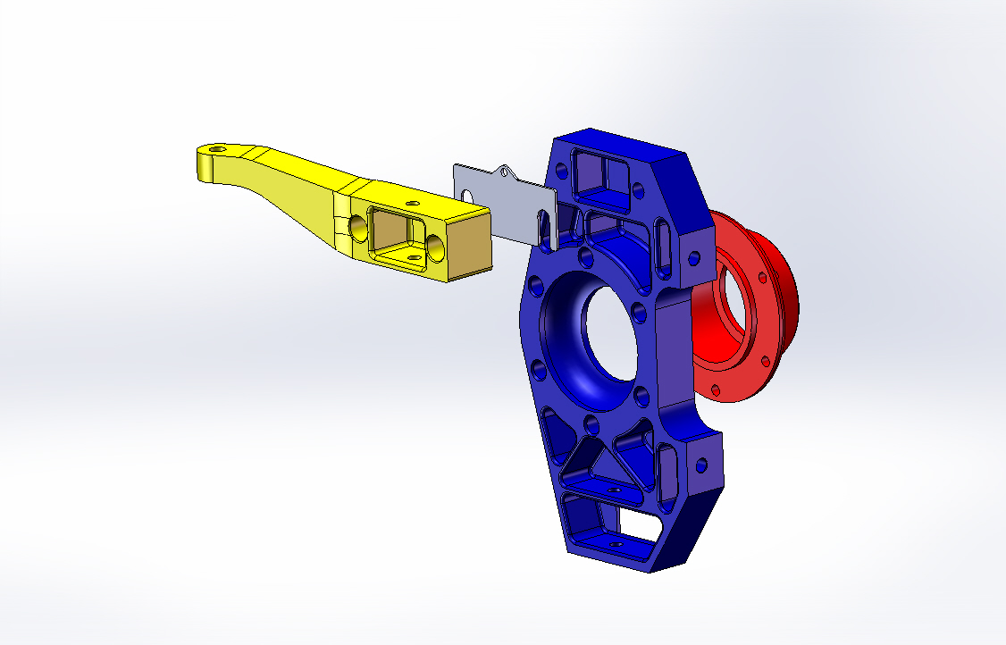

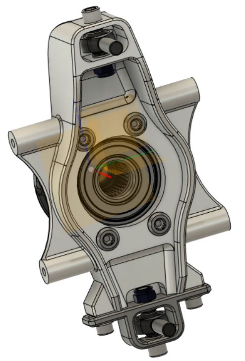

what do you think of this option to adjust the caster directly on the hub?
Hi
Apologise
On that post I writed "so you could do your positive or negative set up caster"
I did a mistake speaking of ajusting the caster !!! My fault ( english terms mix up)
caster can be set up easily with wishbone location and washers or eventually with a sort or trackrod on the lower wishbone
It is the camber !!!
Your drawing could be ok if you place your idea on top and not on lower part and allow the part to move perpandicularly to the axle of the car
It's more securitive than sliding like you did
Just check at what I did on the pics
You will notice that the part bolted with shims to the upright is also the steering arm ...
So when you add or take off laser cut shims in beetween the upright and what we name on racing world the "akerman"you set up your camber and do not alter the steering toe

Ahh now I understand :)
Thought I had overlooked something ...
Well the camber I can also simply adjust the upper Uniball outside.
All right - thanks for the clarification!
"Well the camber I can also simply adjust the upper Uniball outside."
Yes of course ( it's the old fashion !!!) ( doing so )
1/ You will have to lift the car ,undo the top whishbone nut ,unscrew the rod end ,etc etc
2/ You will have to redo your front toe ( modifying camber will increase or decrease toe )
Using shims is much more easy

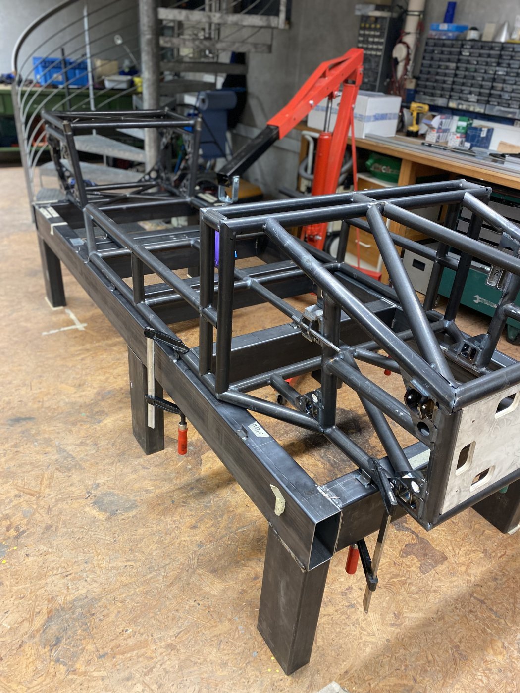

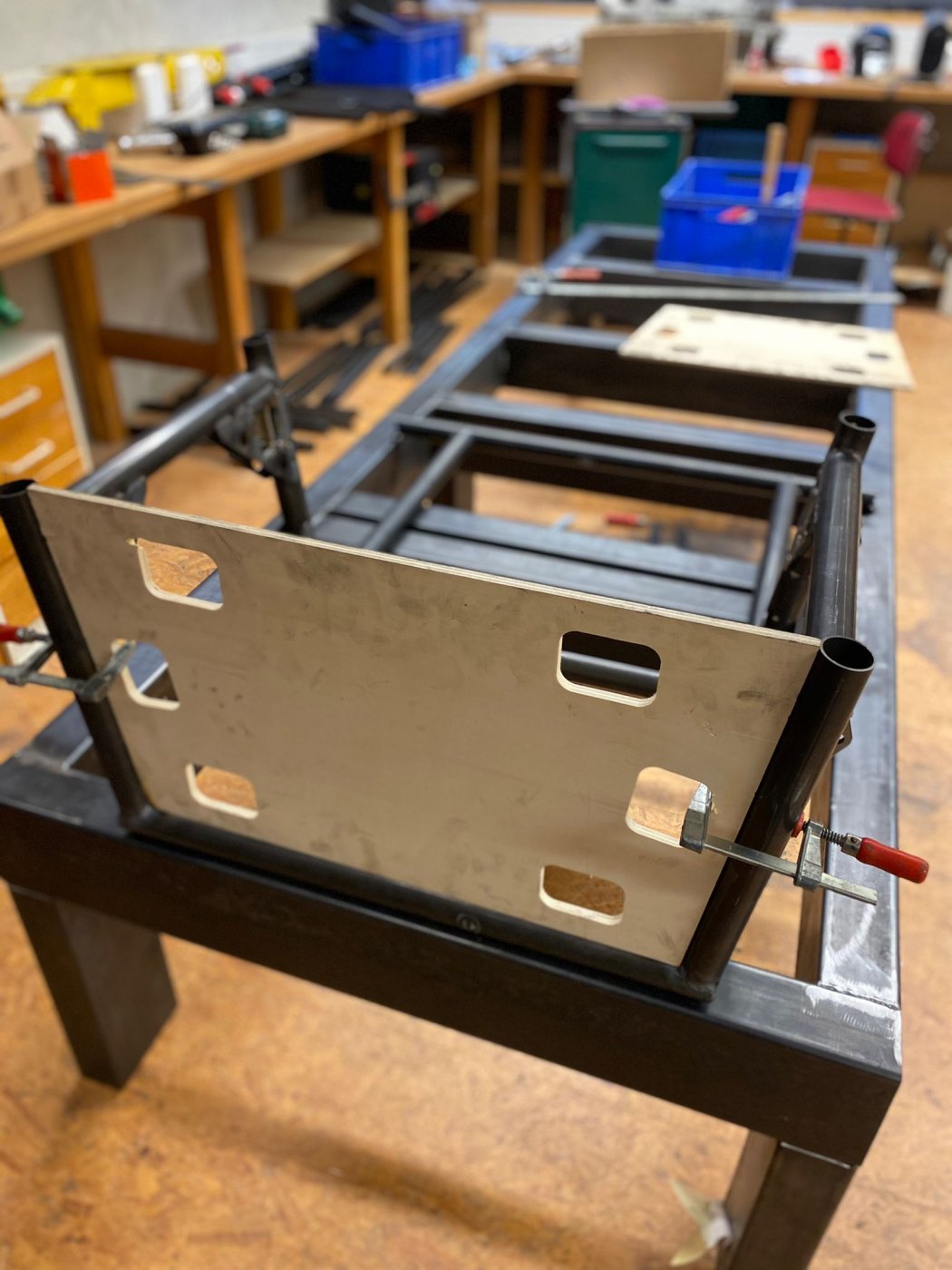

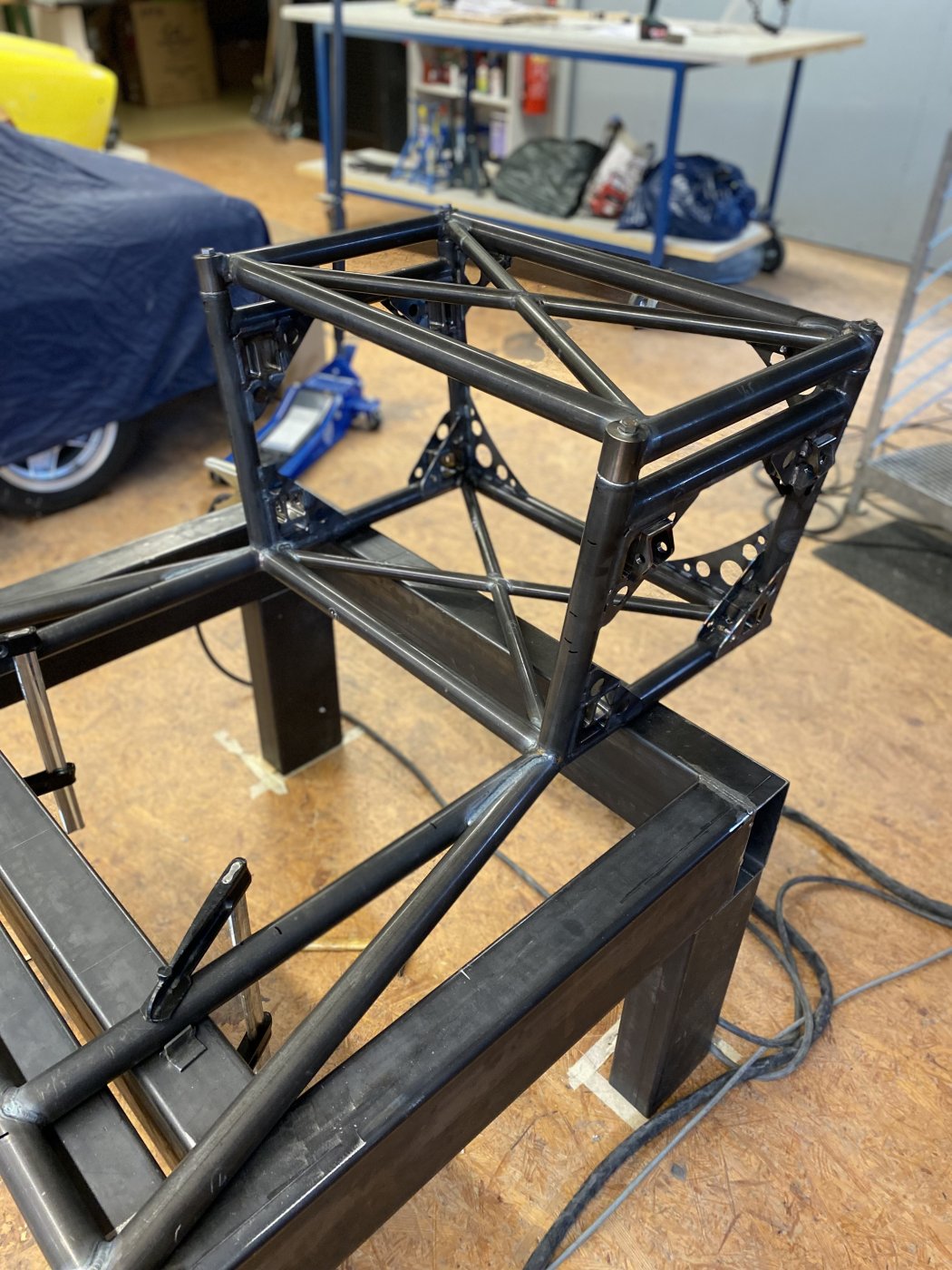

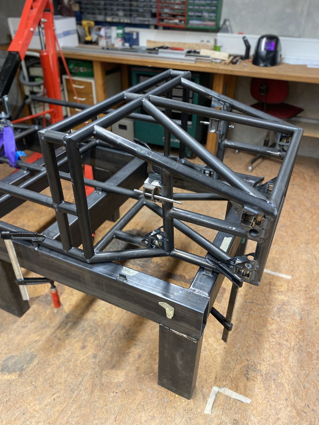

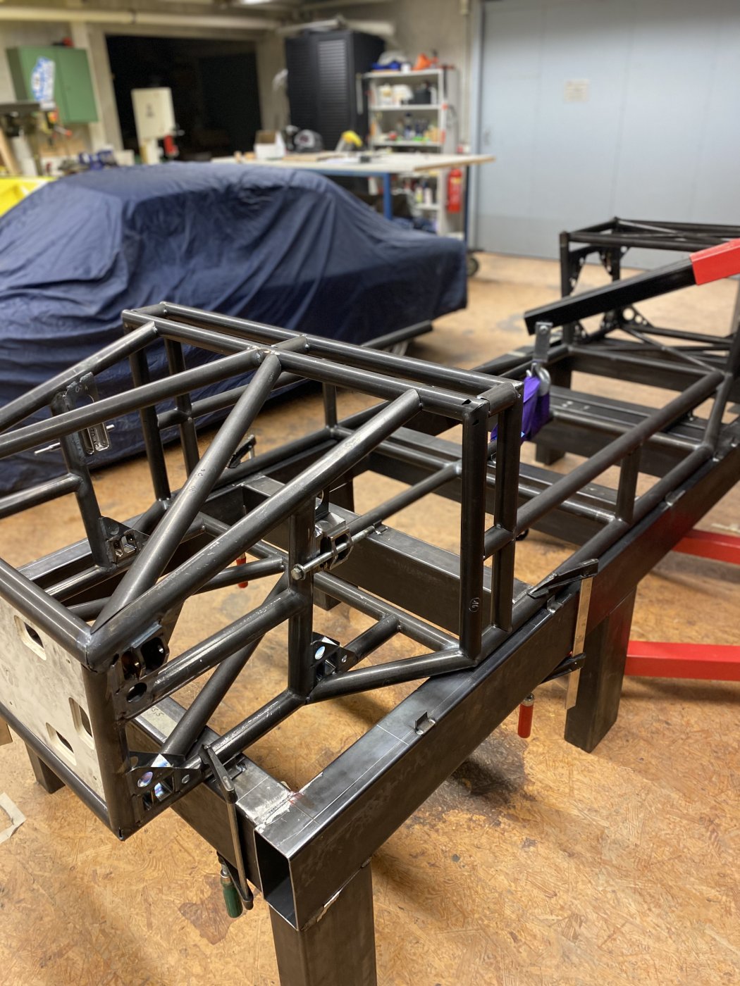

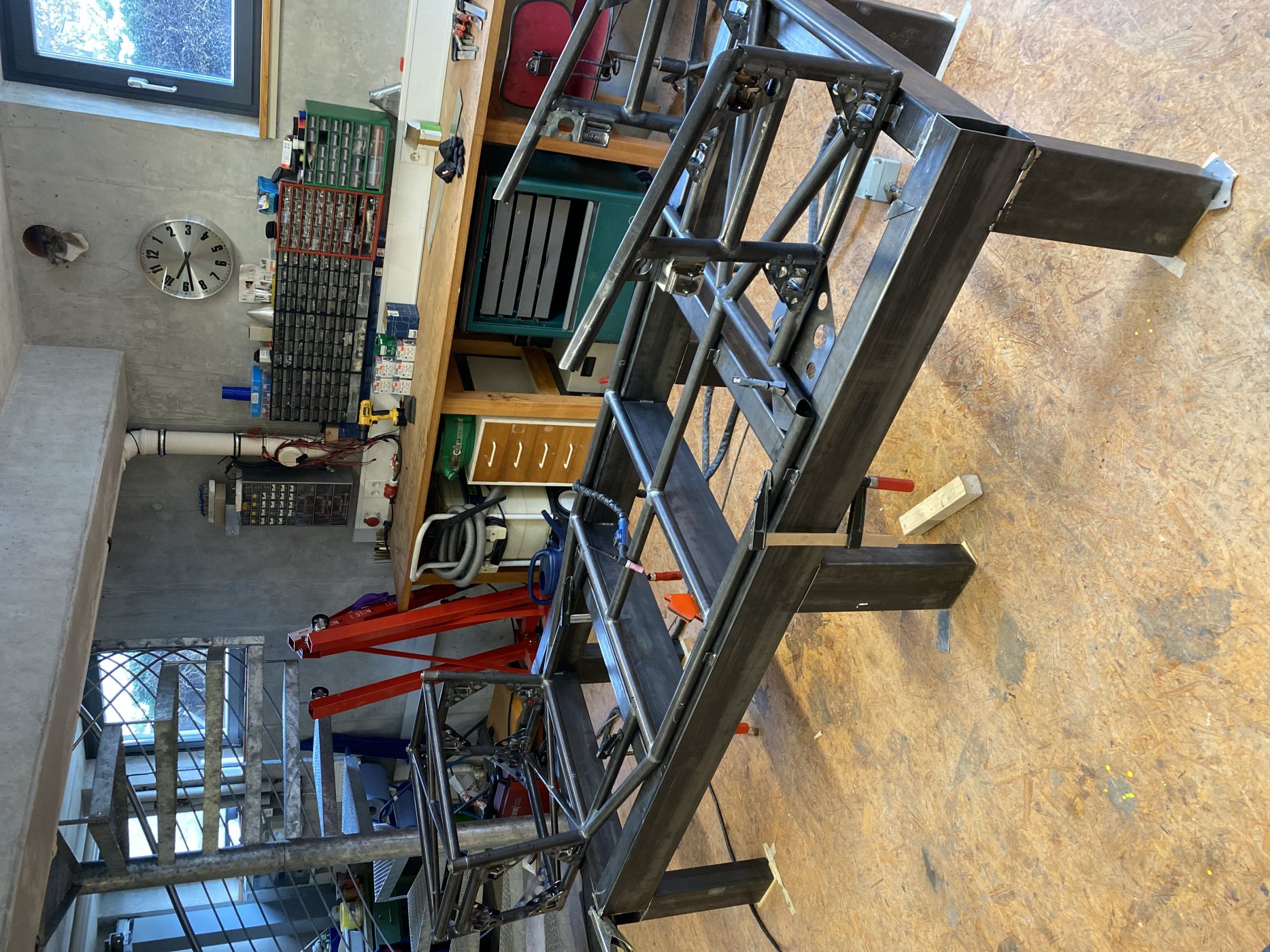

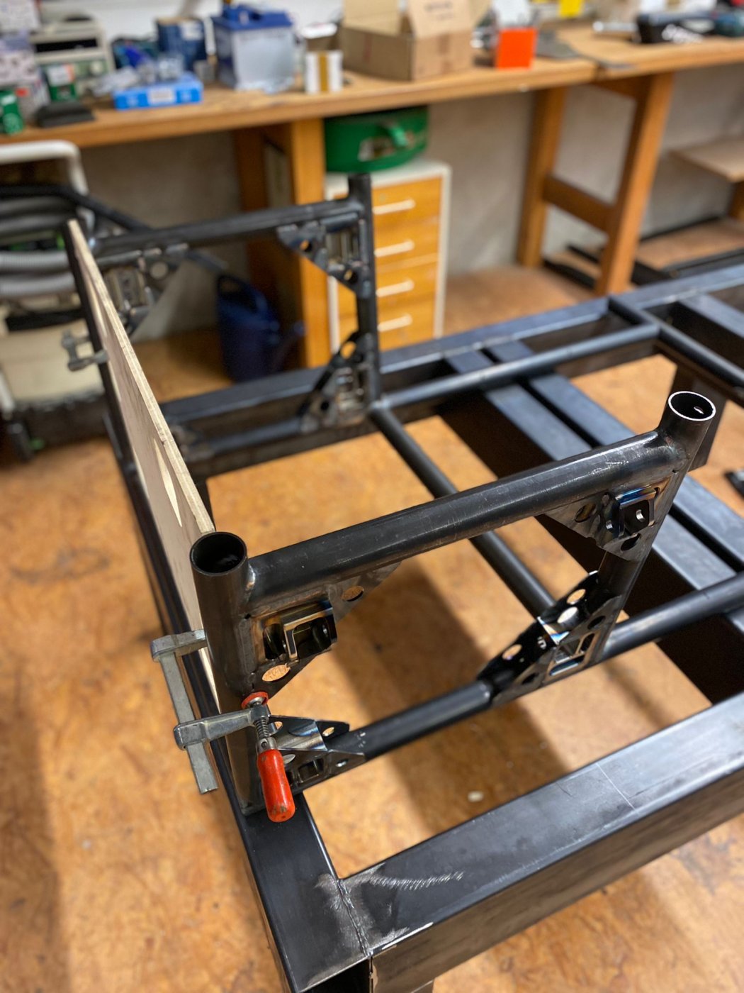

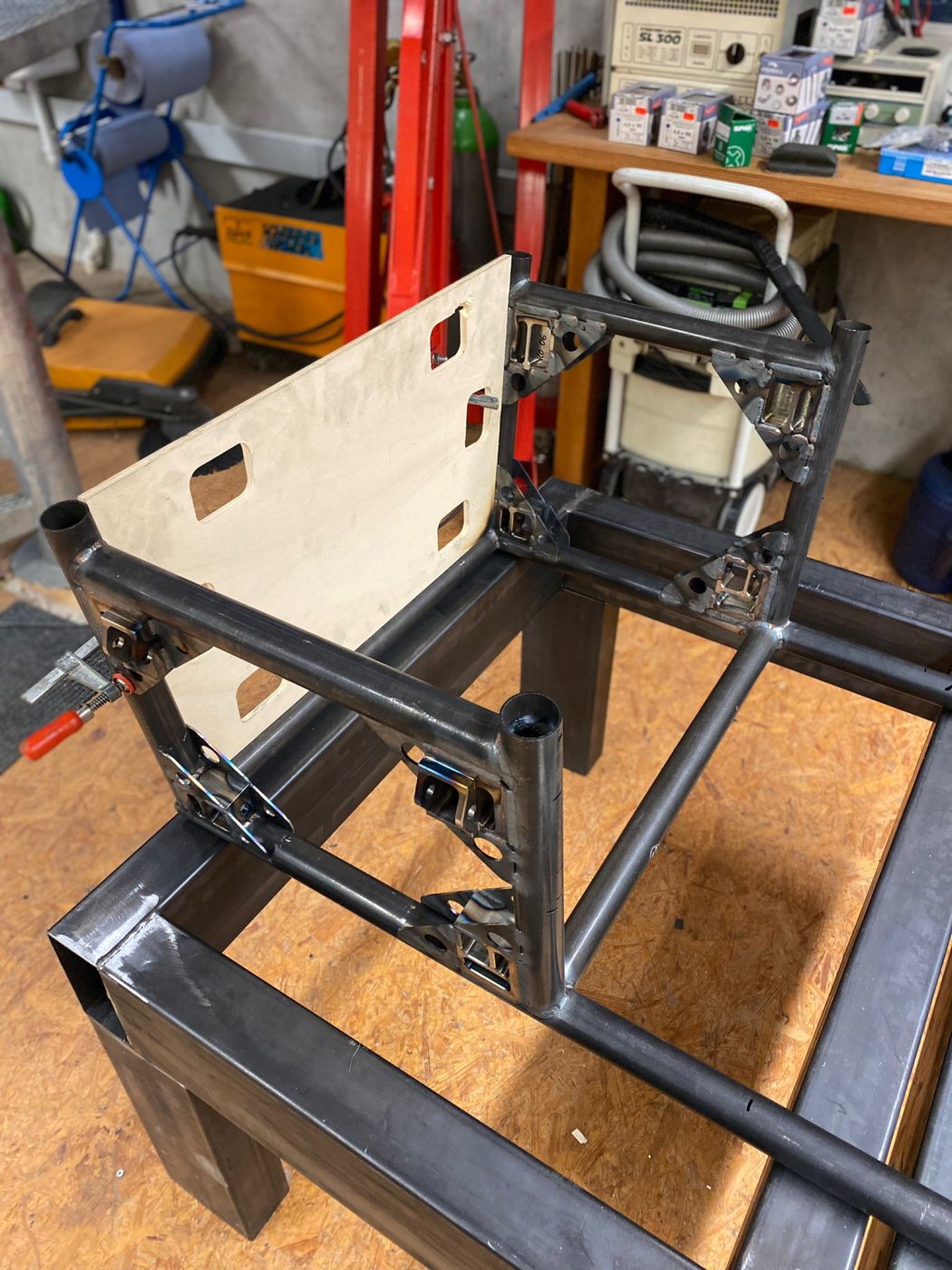

This weekend I started with the trickiest part of the frame.
The position of the 4 wheel mounts to each other. Looks good so far

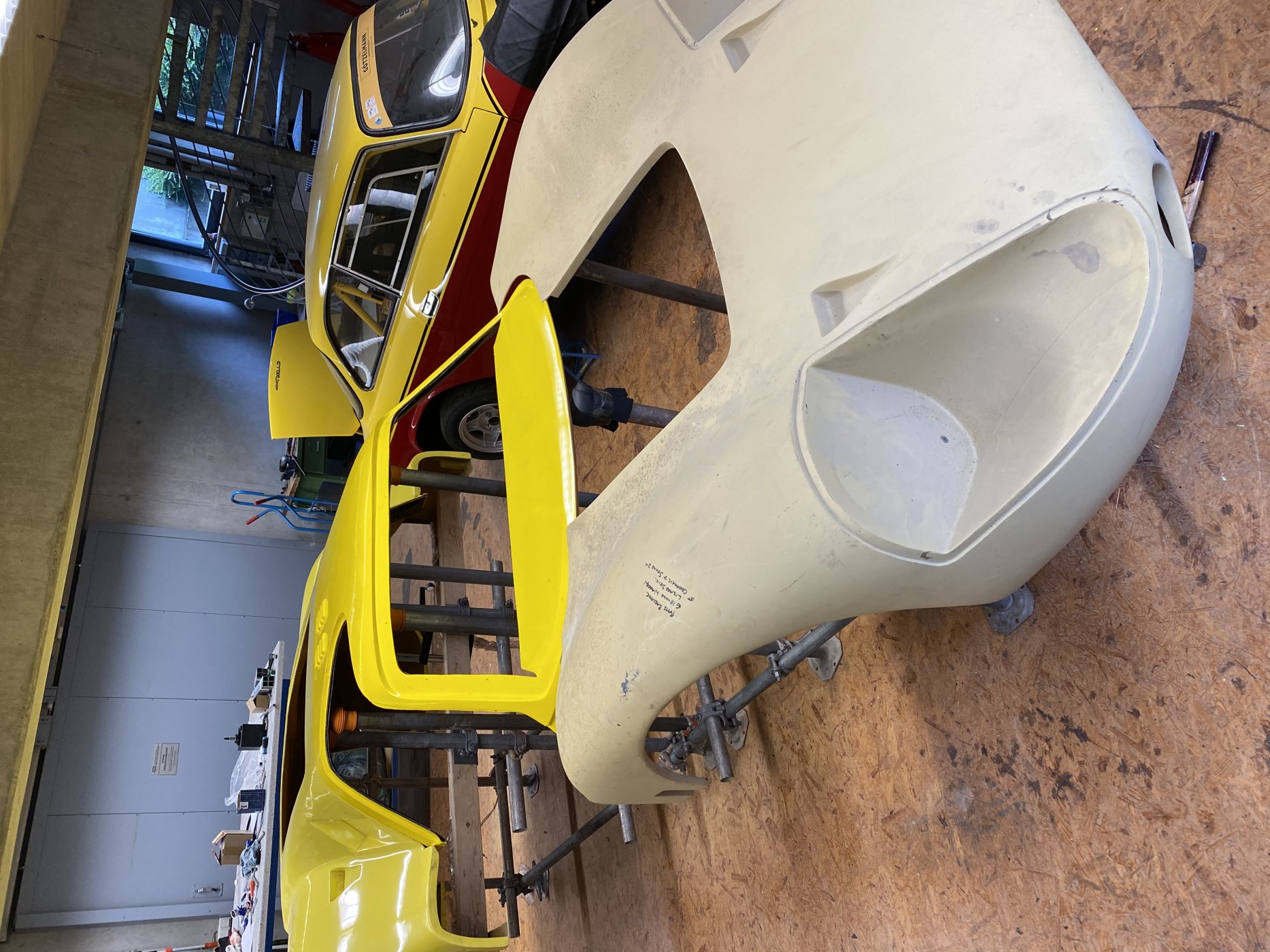

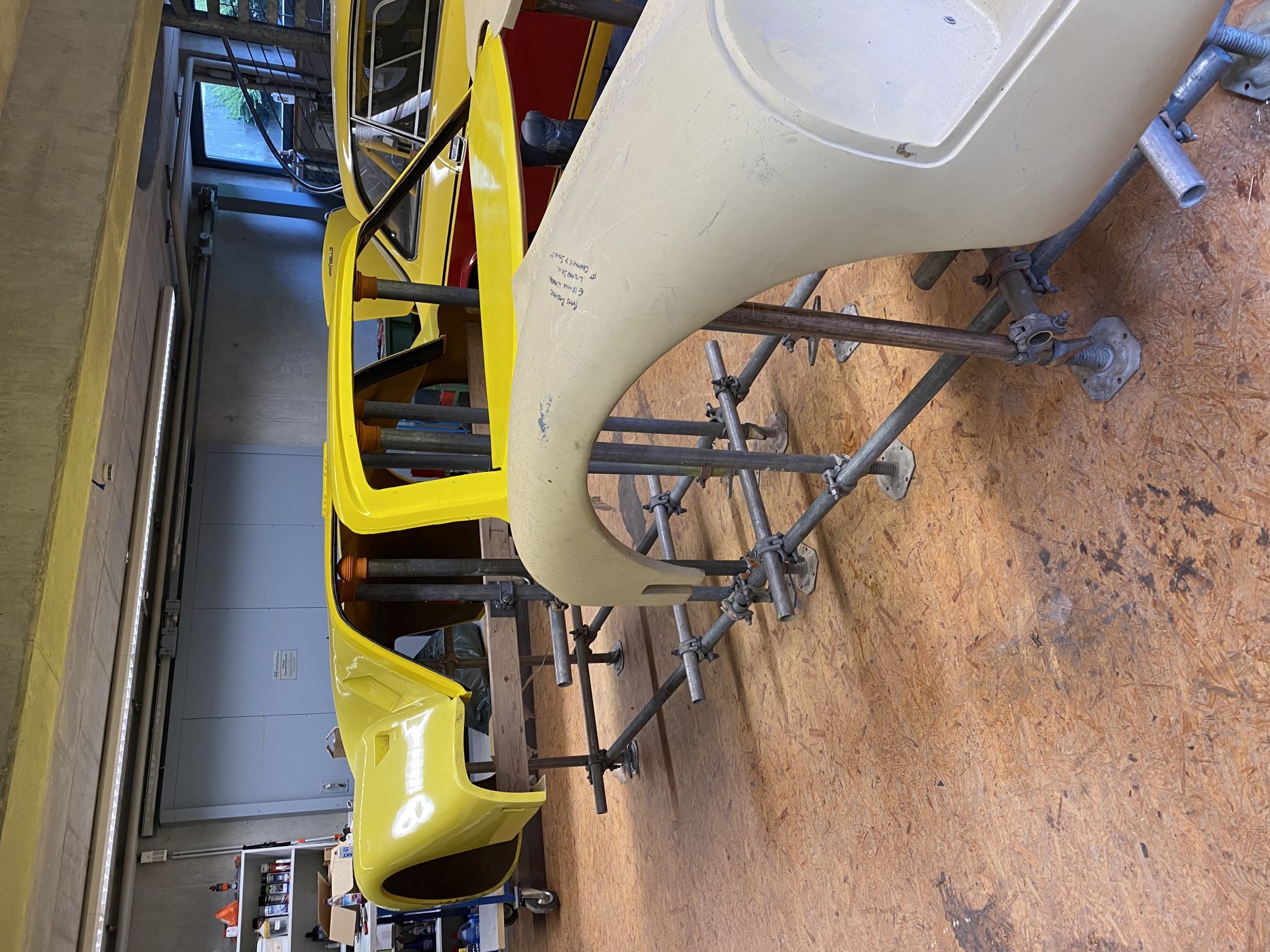

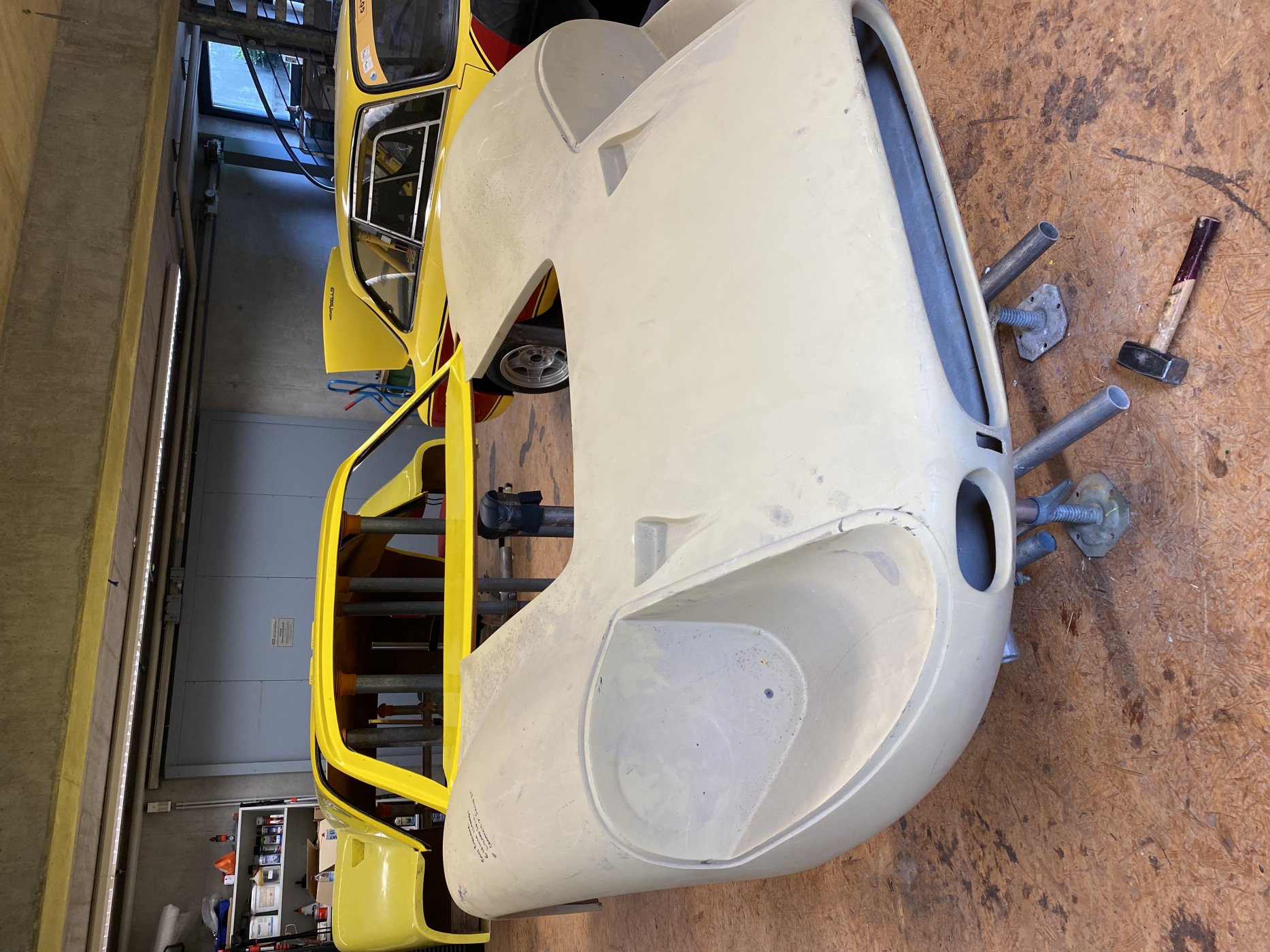

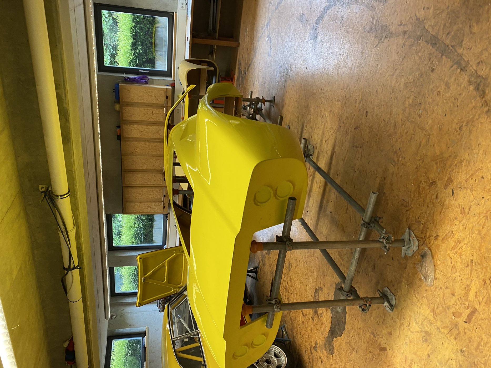

After 30 years of dreaming, 12 years of reading here in the forum, I can finally start to realize my dream of the MK IV.
I know it's going to be a very long race, but hey what the heck if not now then when.
For a long time I thought I wouldn't get any parts, but thanks to the forum, it still worked.
First I put some of the parts on a rack to see how they fit together.
So I can now take all the measurements I need for the tube frame.
Maybe I will bring everything with a 3D scanner into my CAD program
I hope the whole thing will be riding sometime - keep your fingers crossed for me :cool: View attachment 107417View attachment 107418View attachment 107421View attachment 107422

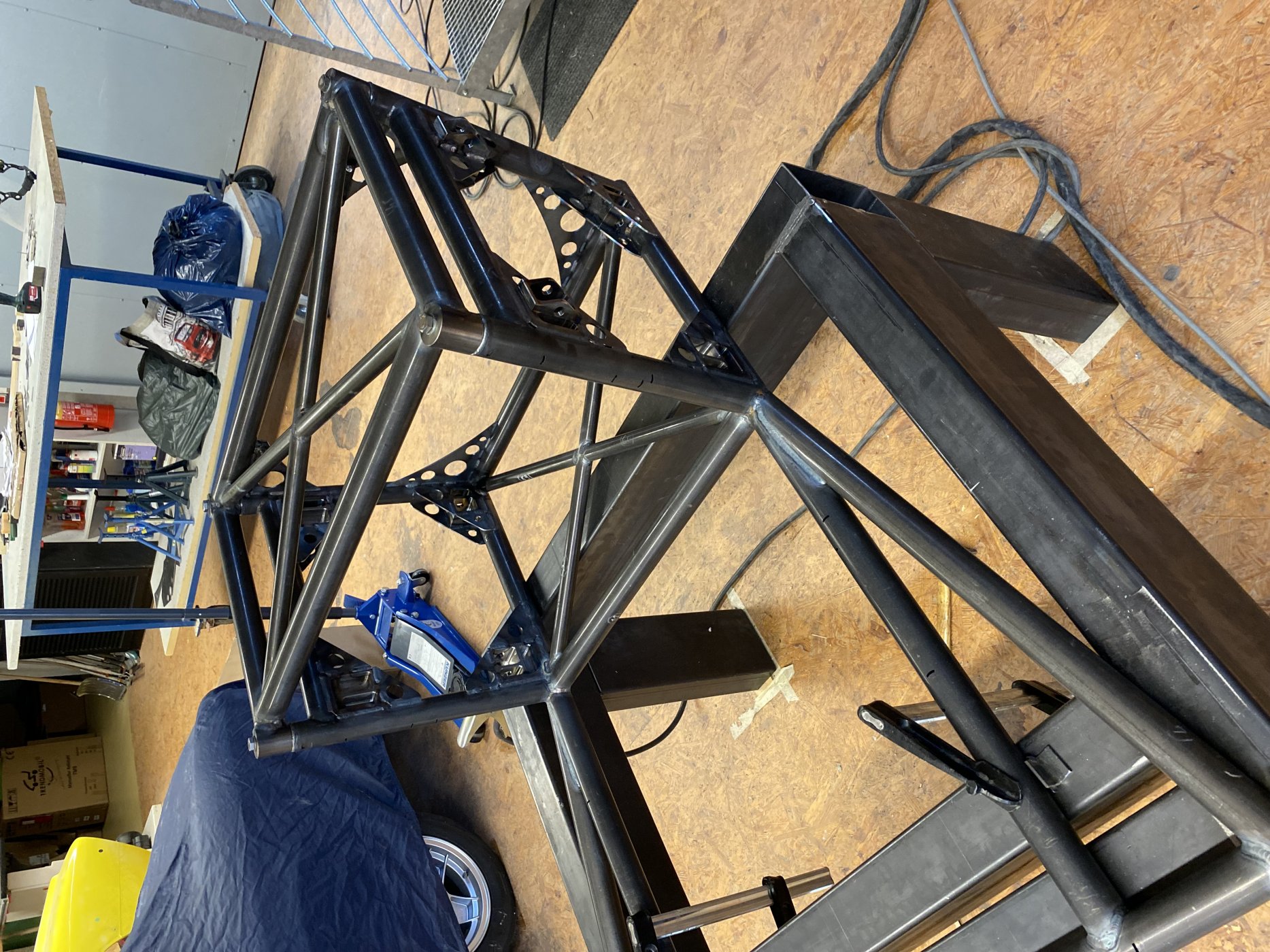

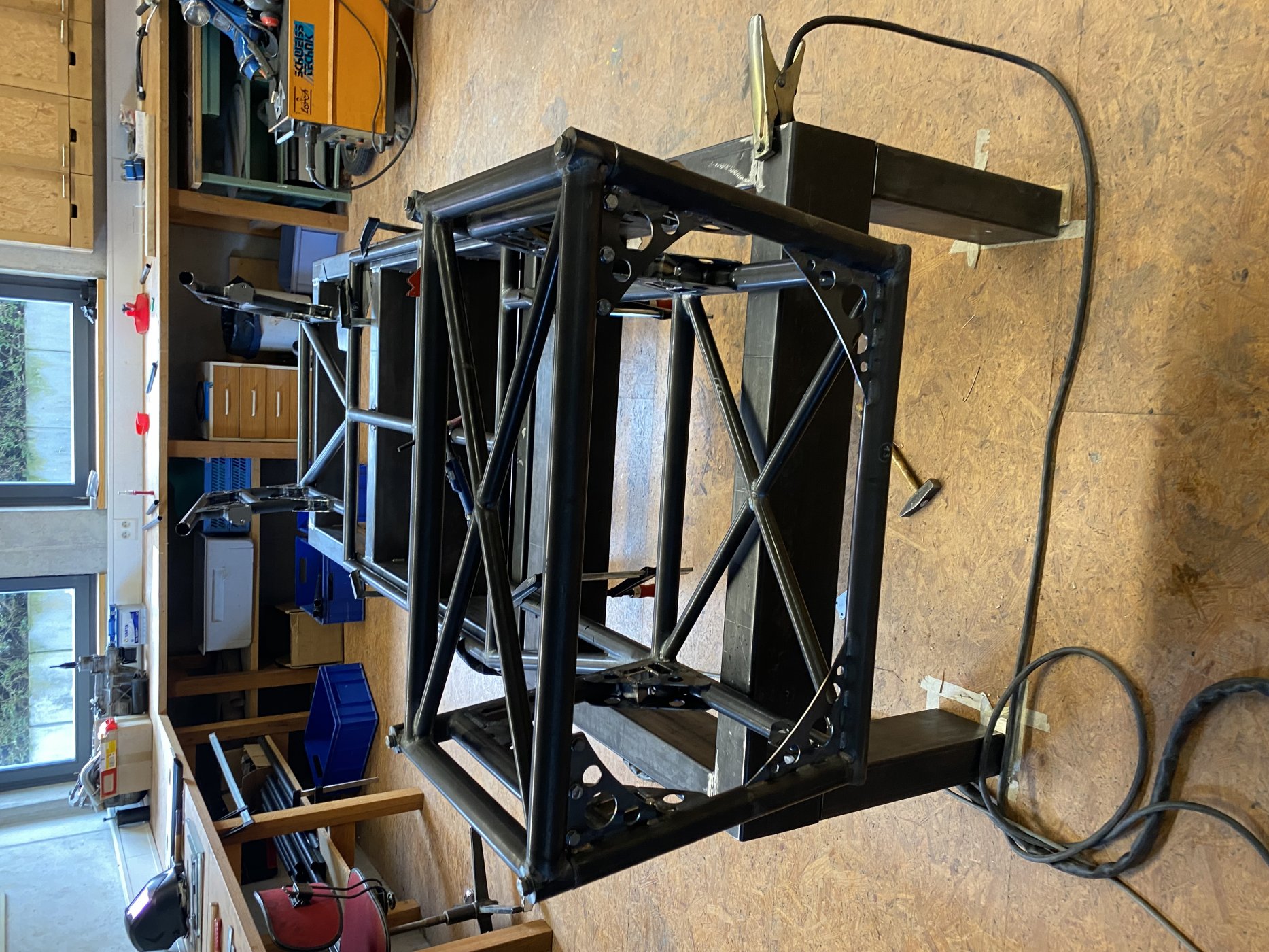

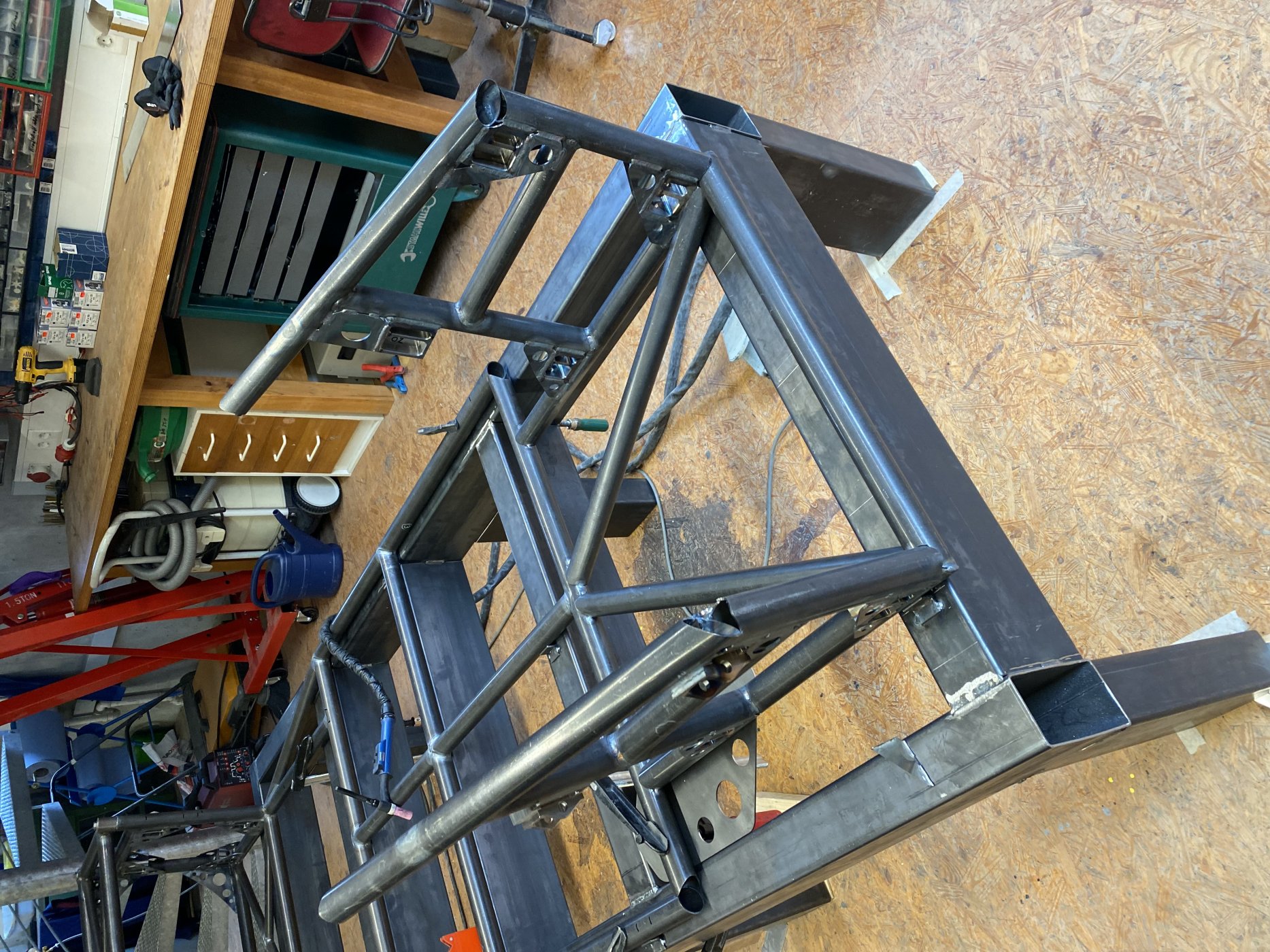

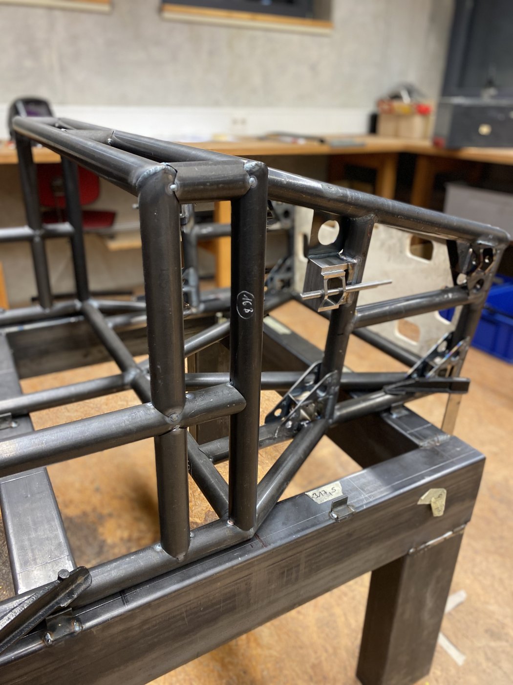

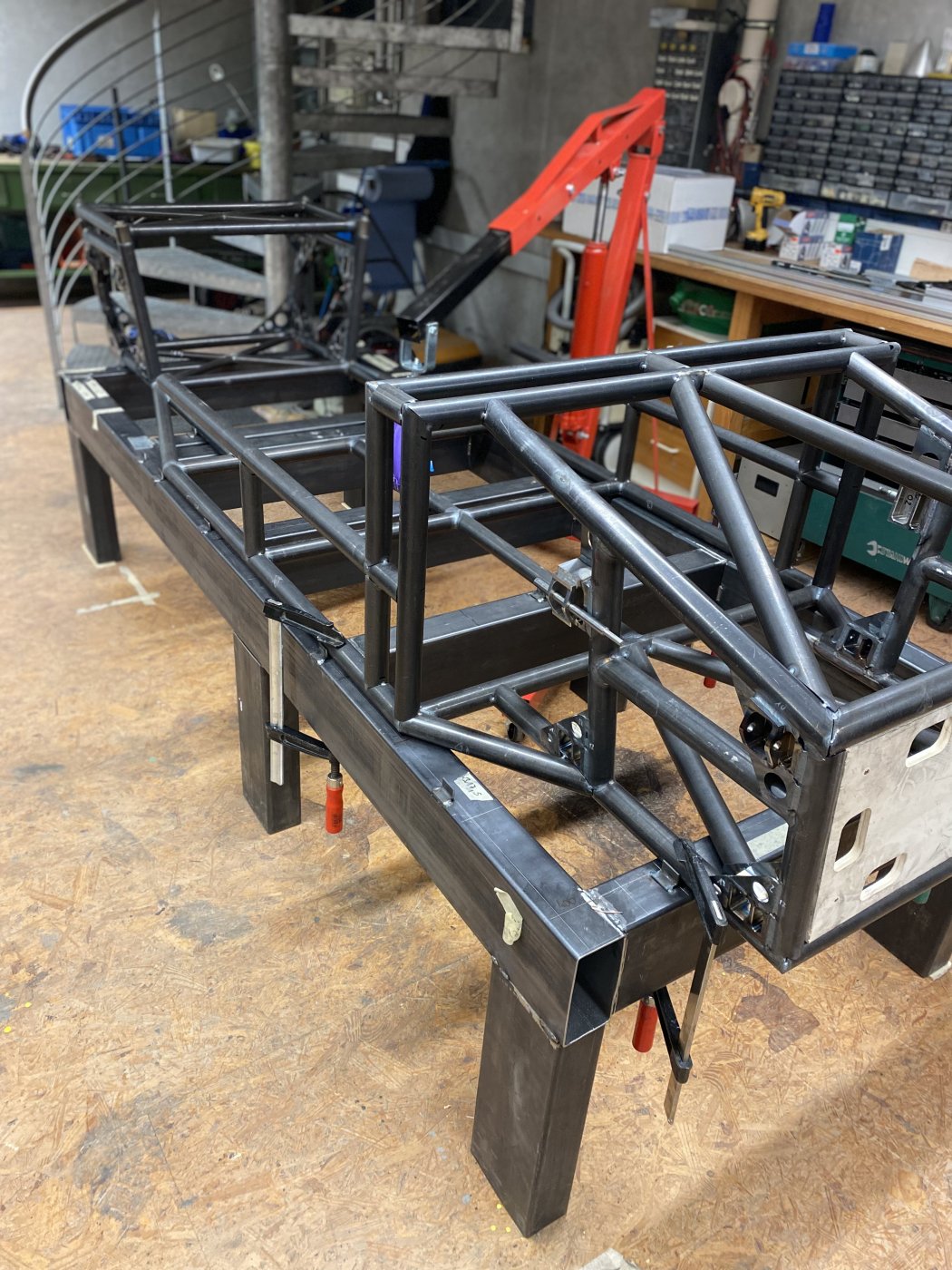

Tedious but it goes forward…
