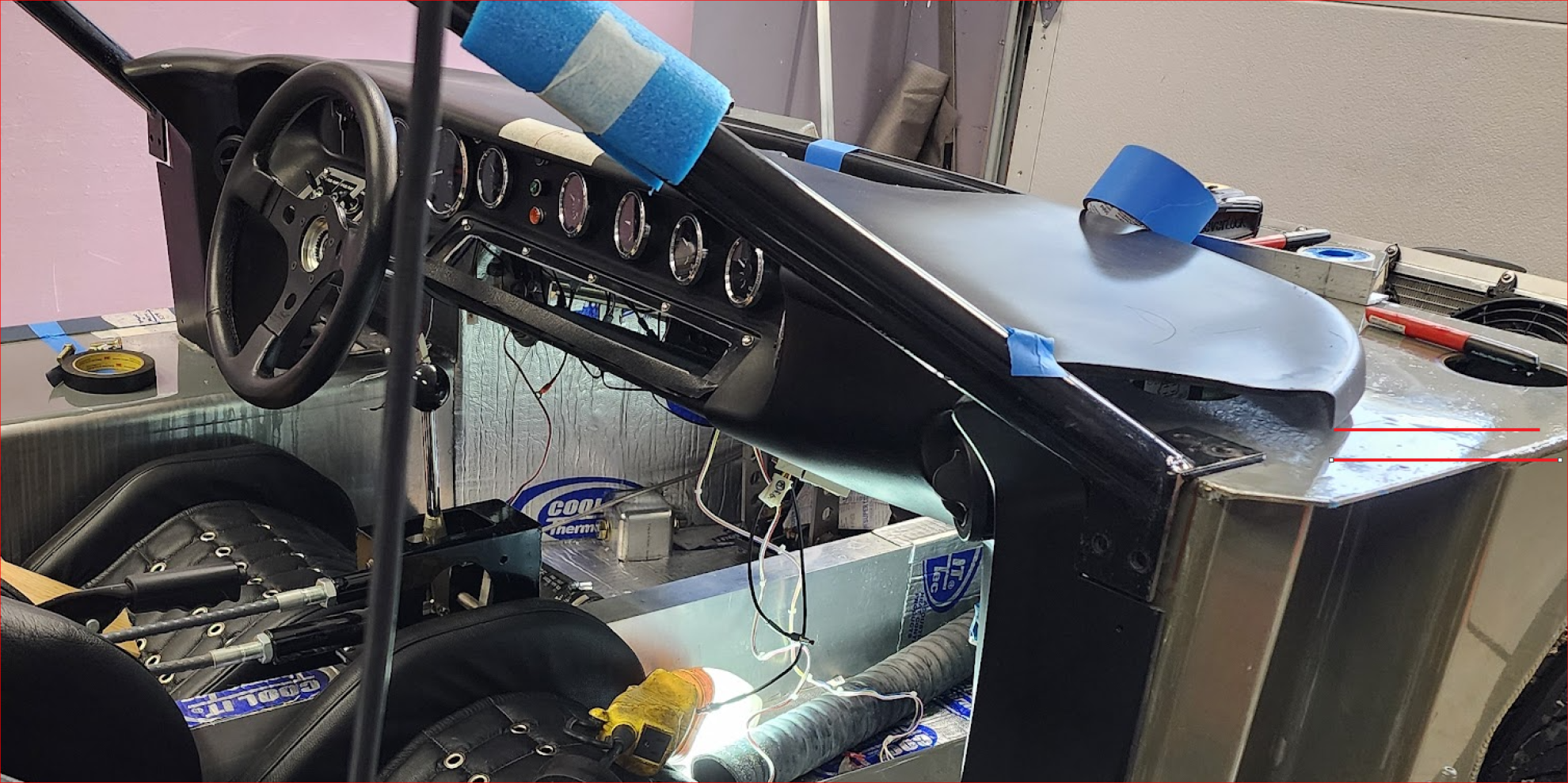

Question: How are you going to mount the DASH-to-frame ?
According to RCR instructions, looks like (2) x 2 screws on doorframes? Really, 4 screws, thats all? (and weather strip to spider ?)

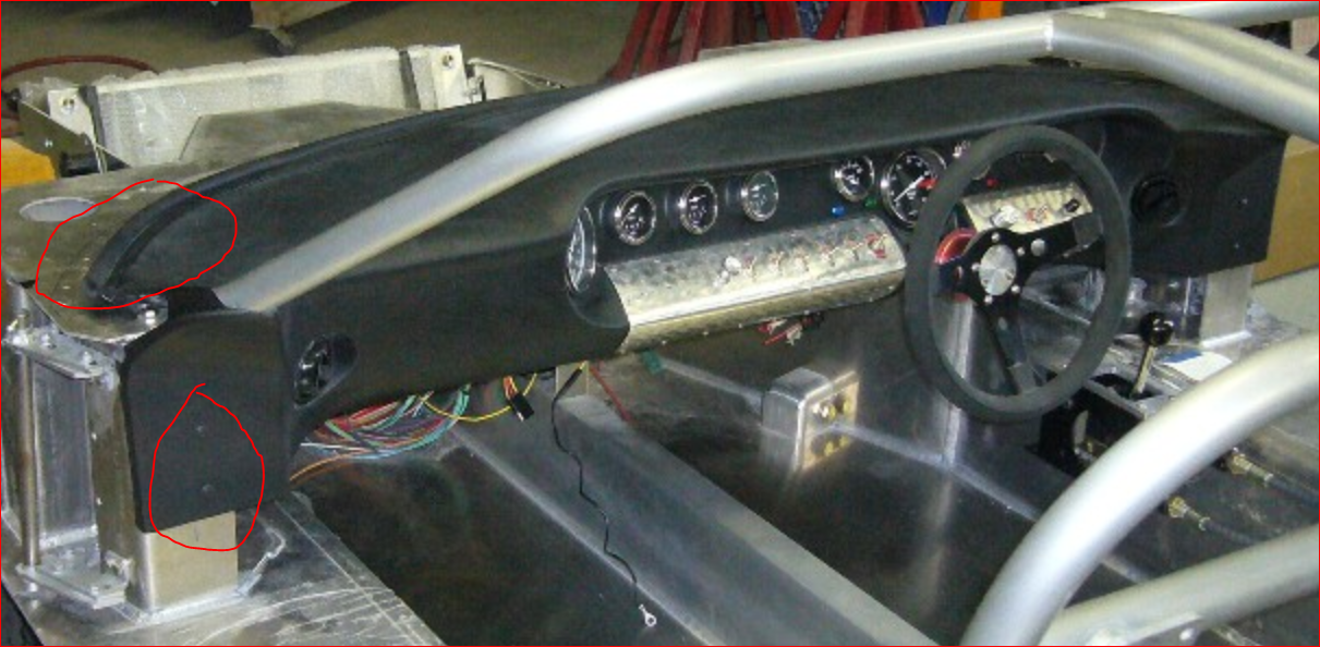

Getting to that stage myself (last photo).

Getting to that stage myself (last photo). View attachment 141942
Sean,
My plan is to glue wood to the underside of the dash and then use screws under the dash deck to pull the dash down to the deck. This will ensure no rattling and flatten warped sections. I have not received my AC yet so don’t know exactly where to place the screws. Fortunately, I can make the blocks quite expansive so it will be easy to get the screws in. On the cut off ends of the dash, I will extend the wood past the edges so that I can use top down screws at the ends of the main dash.
