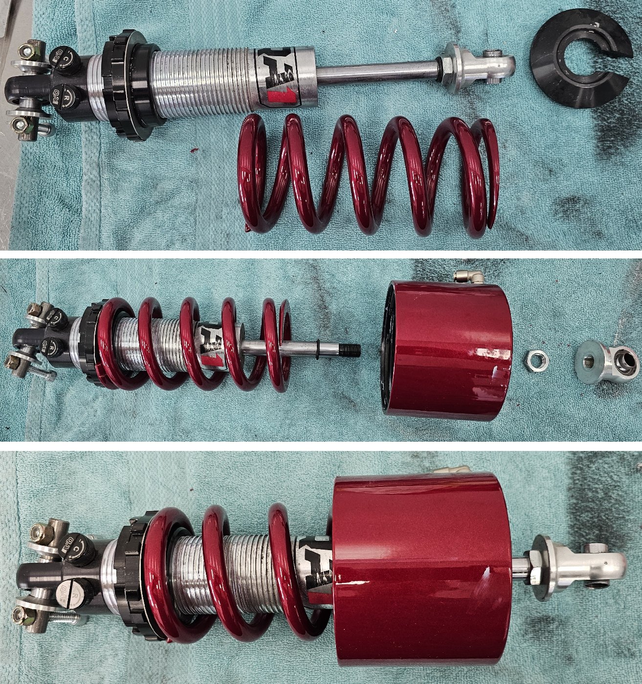

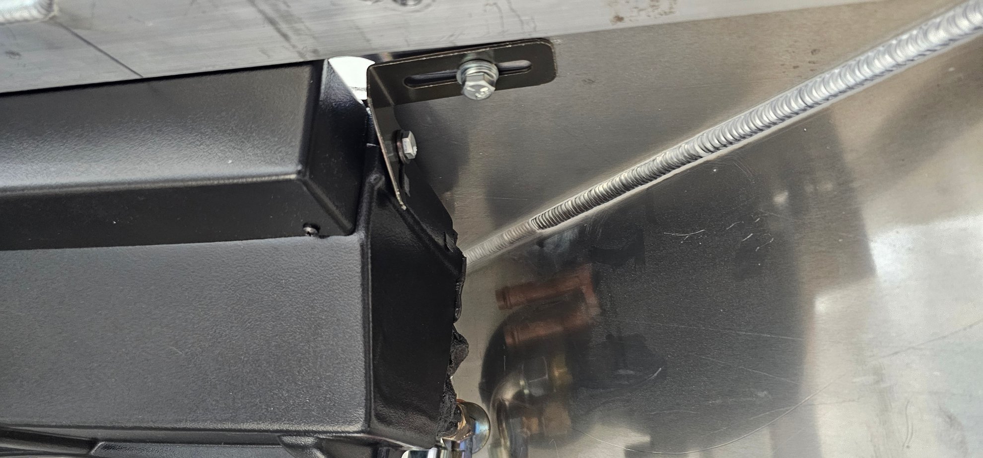

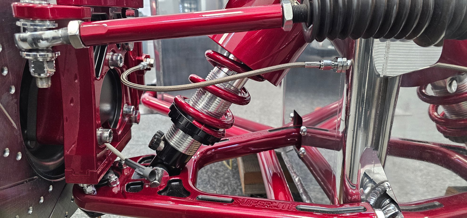

Here is how I assembled the StanceParts cups.

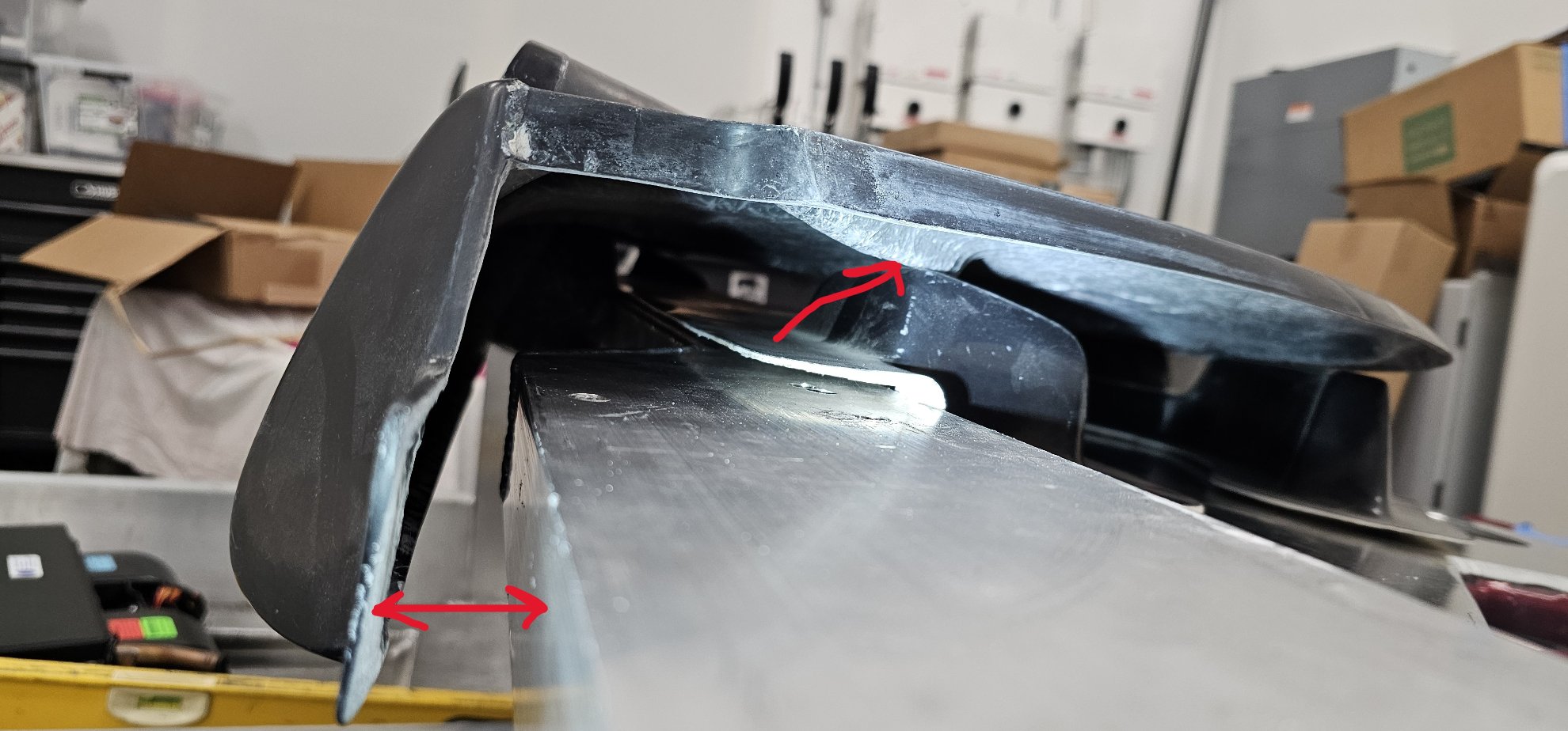

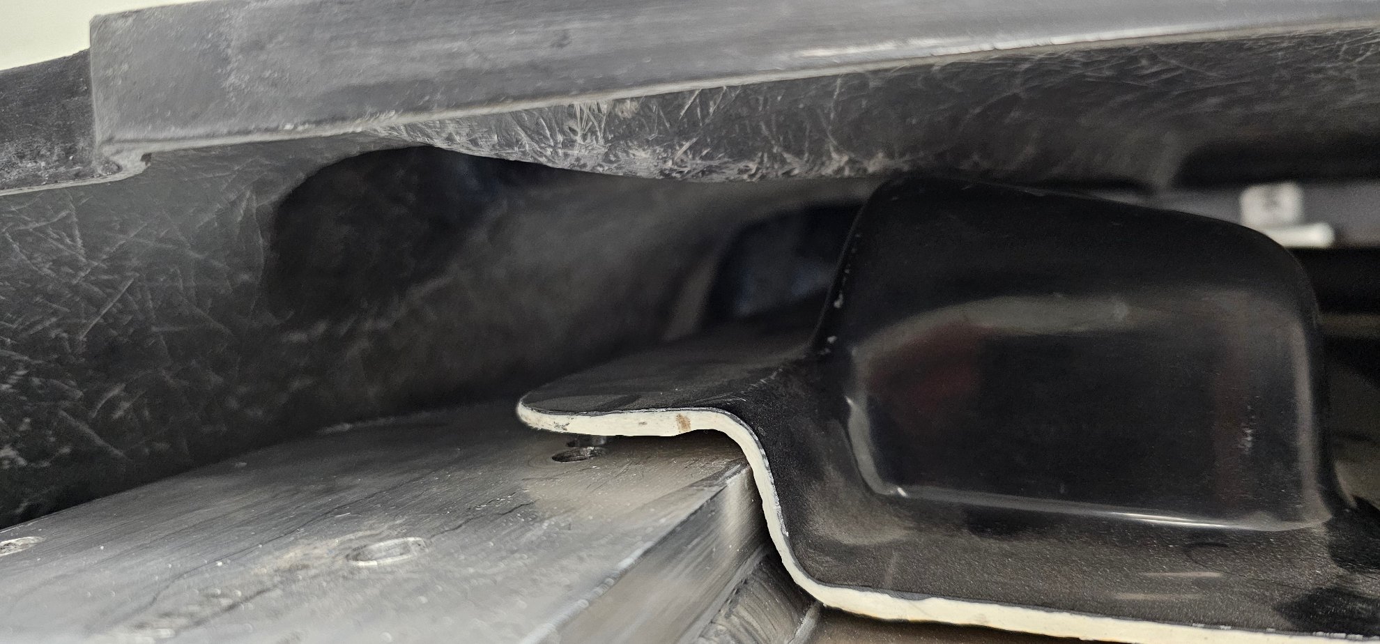

I used these LED light bar clams. I think they worked really well. I might have to cut a little bit of the body but it should work.

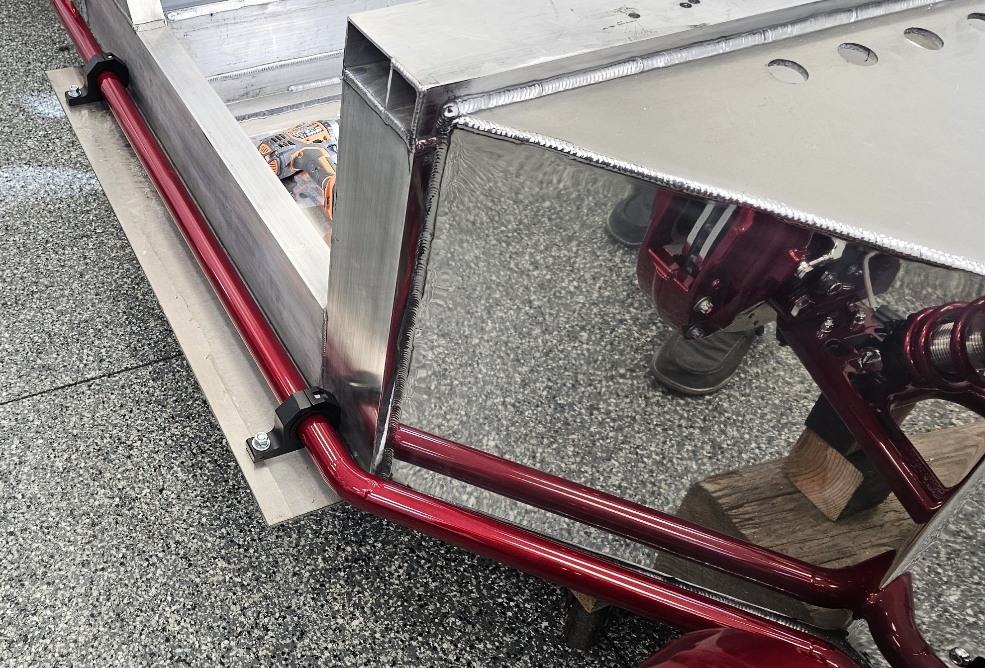

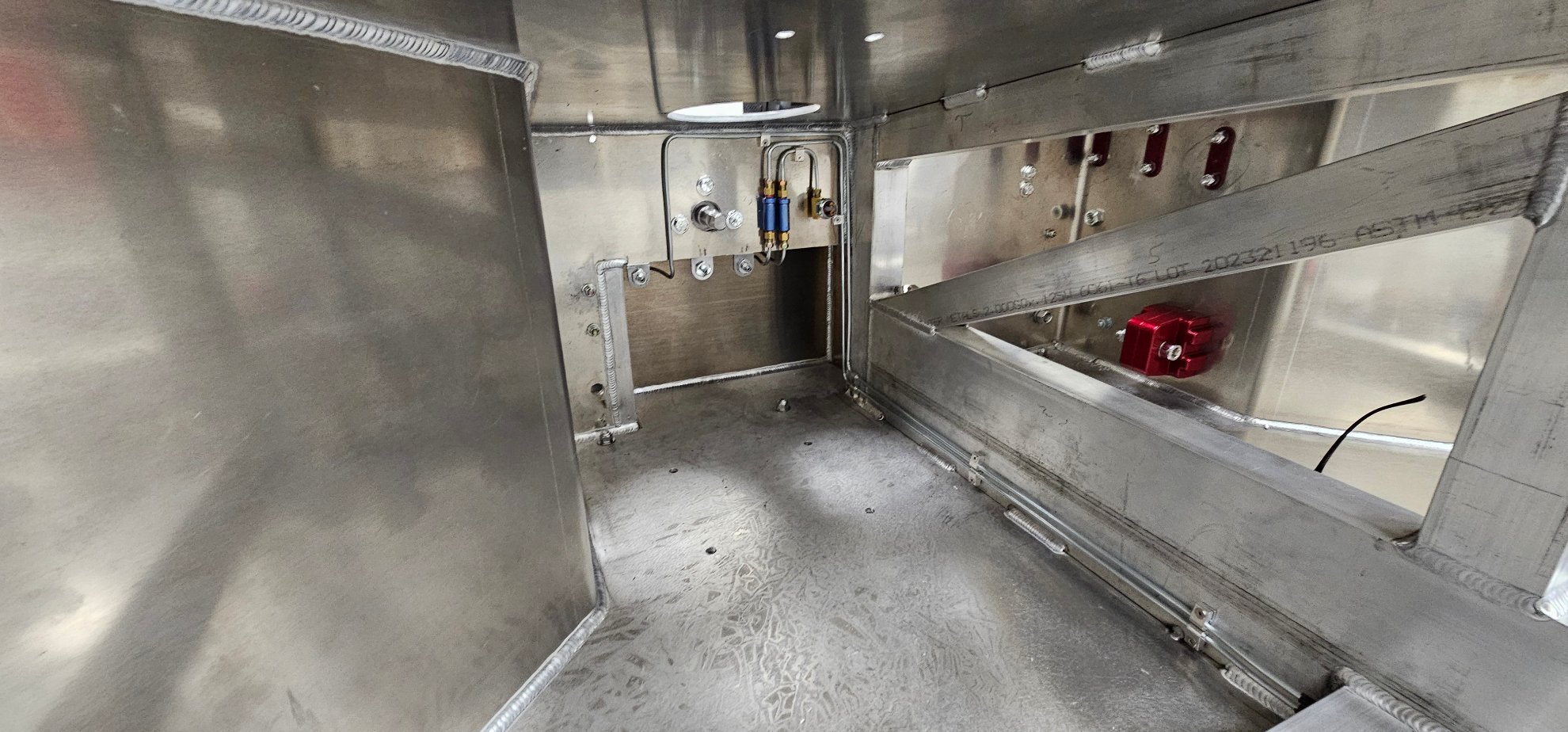

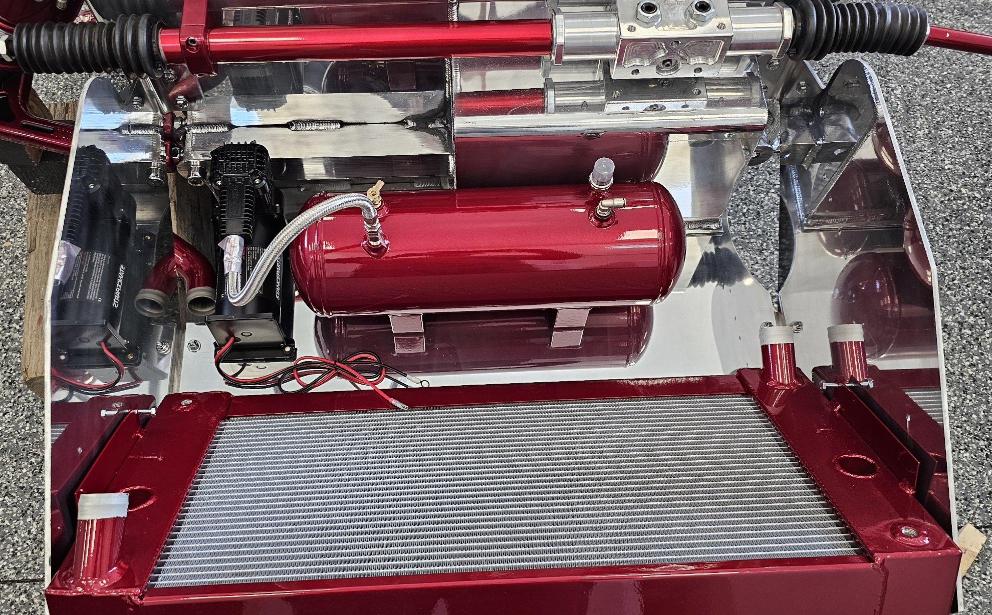

Does anyone see any problems with mounting the StanceParts tank and compressor here? I am going to put all the brake lines inside.

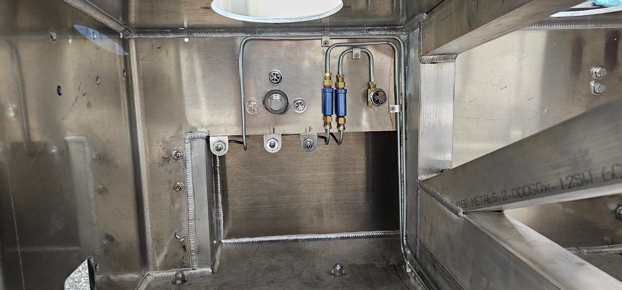

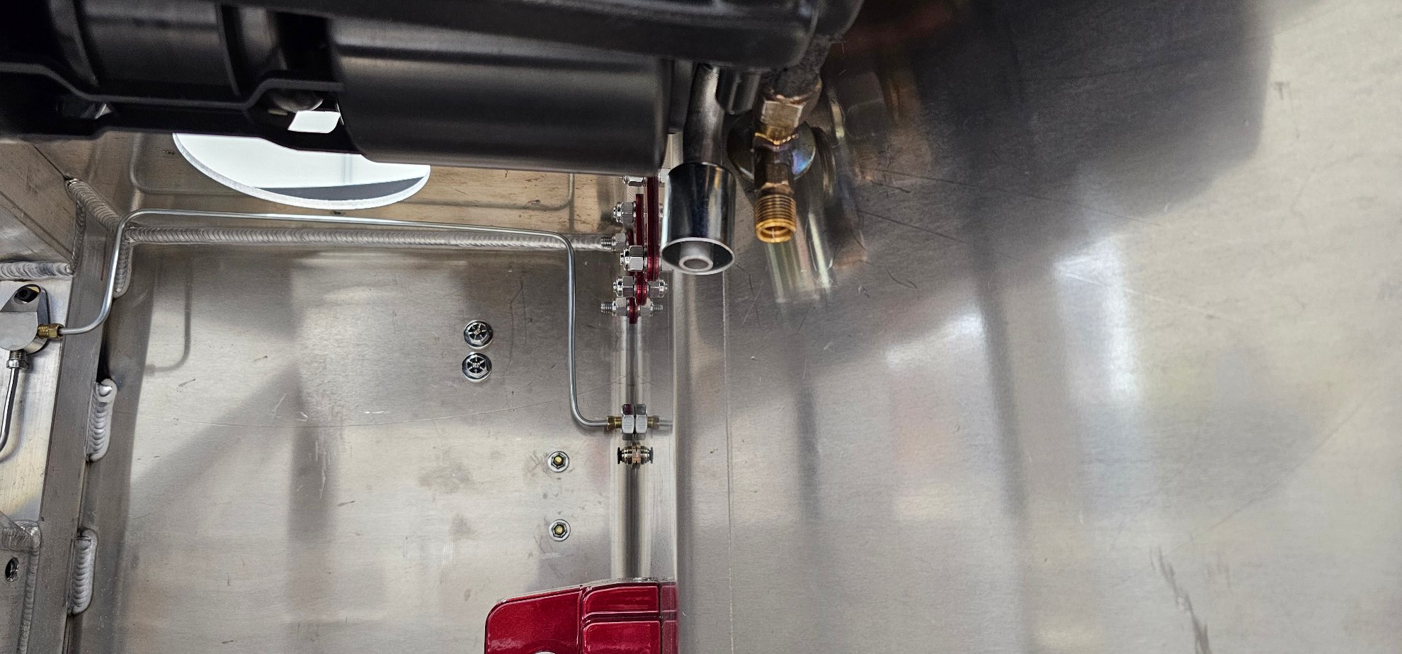

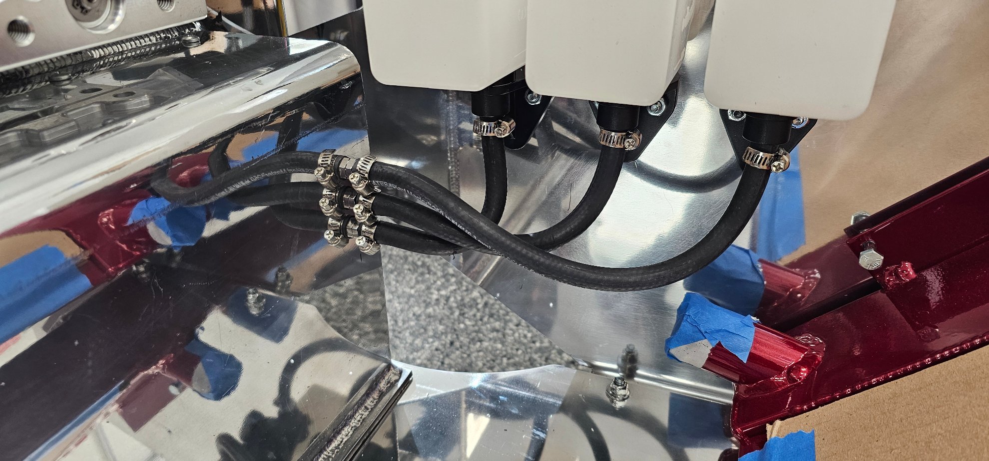

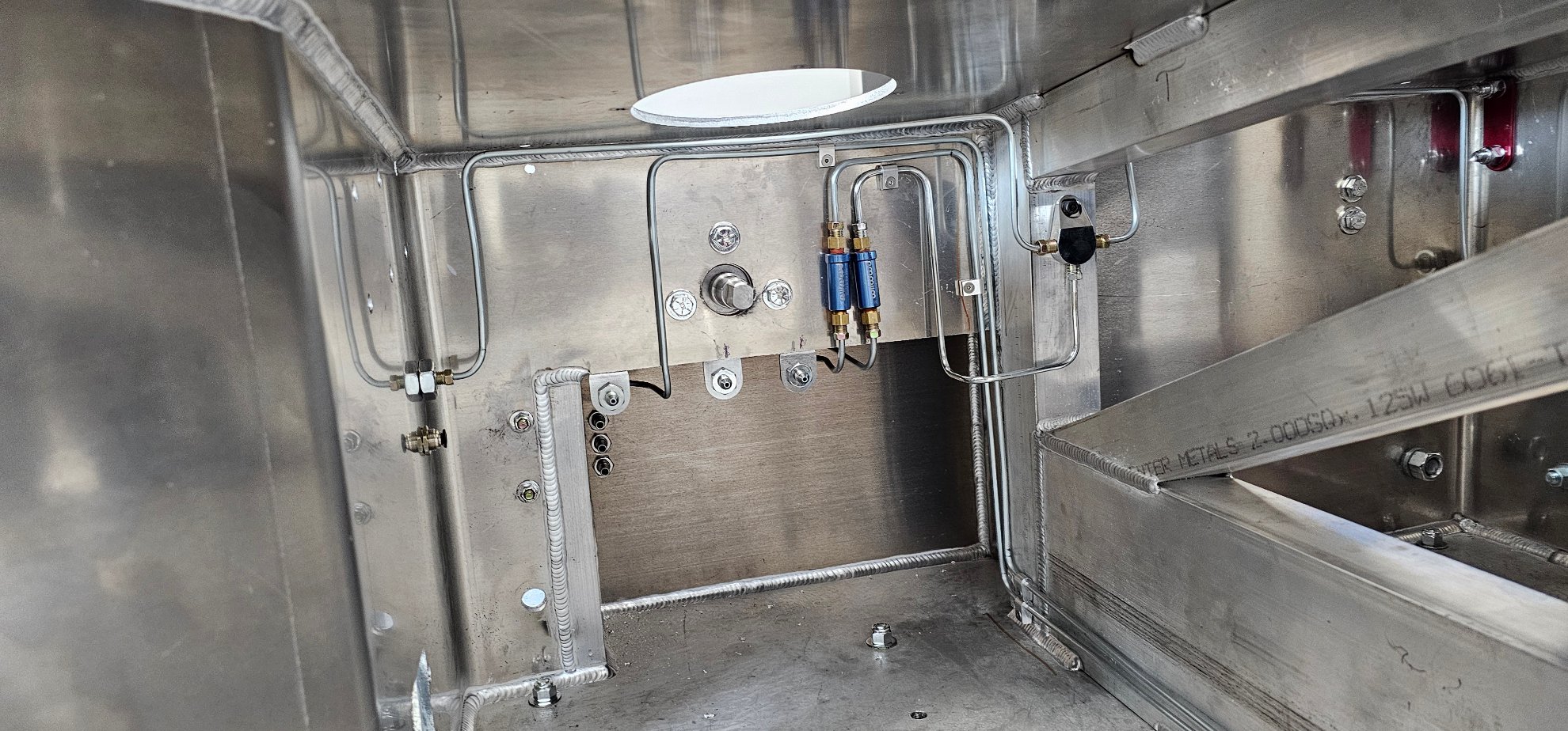

Installing all the brake lines. I'm actually pretty proud of the way it turned out. I did drill through some cross members. So all the bends had to happen inside the car.

Two things, be careful with that inline pressure switch, they’ve been known to blow. Also, maybe make so provision or thoughts about how to efficiently direct air out of the front clam. That is an extremely hot area and the tank make interfere with any venting you have planned.
"...be careful with that inline pressure switch, they’ve been known to blow." Amen! In the '60s I was driving my 250GTE in Charlottesville, VA and a car stopped in front of me. I stepped on the brake and there was a sound like a pistol shot but NO BRAKE! I quickly grabbed the parking brake and stopped short of disaster. Later inspection revealed that the hydraulic brake pressure had blown the entire guts out of the brake light switch. :mad:
Shane
So are people using different types of brake light switches now? Obviously anything can fail, but what are people doing to prevent a catastrophic situation? I'm assuming the failure rate on these has to be really low.
Ian Anderson
A micro switch on the brake pedal set up so the switch makes contact as soon as the pedal moves..
I had one switch blow and leak fluid…..slowly enough to get home and replace.
The next failed to make contact so no lights……then did the micro switch and no mor problems.(and no need to bleed the brakes again )
Shane
Thanks all! I appreciate the info on the hydraulic brake light switch. It is now eliminated and I will make a bracket for the mechanical switch off the pedal assembly.
I also got the reservoirs plumbed to the bulkhead fittings.
Kyle
GT40s Sponsor
Just fyi, the switch should be normally open and depressed when the pedal is in neutral, then even the slightest movement should close the switch when the pedal is pressed.
You don’t want it the opposite way.
I have my lift pump, battery, megafuses and fire-bottle mounted in that area (wo extended foot box). No issues other than it's tight with cables/hoses. My fire-bottle is probably larger than your tank.

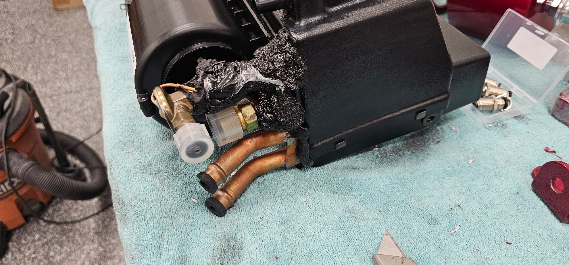

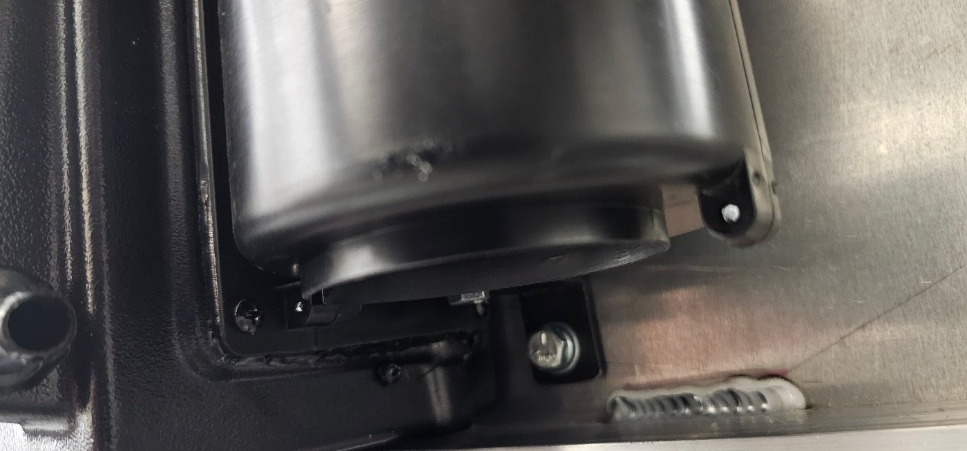

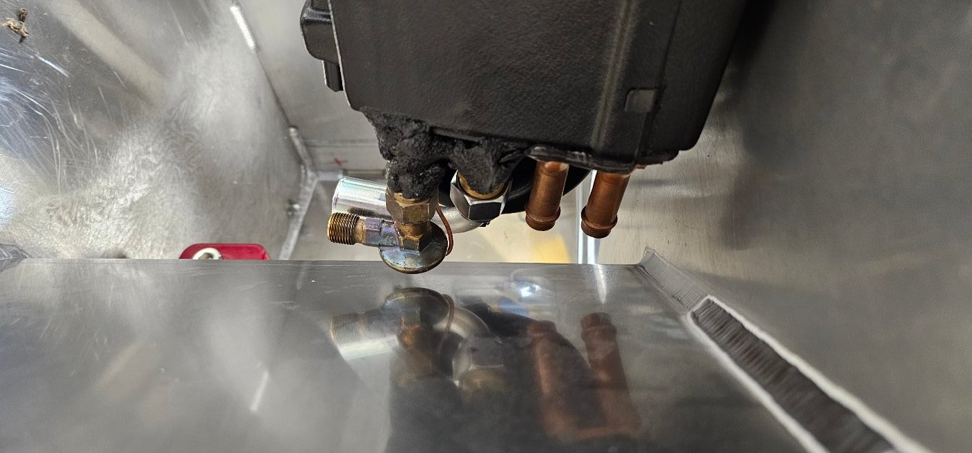

I am really happy the way the AC unit fit into the car. I had to do a few of the modifications that have been talked about before on this forum so make sure to check those out. But here is how I did it.
Original unit from Vintage Air

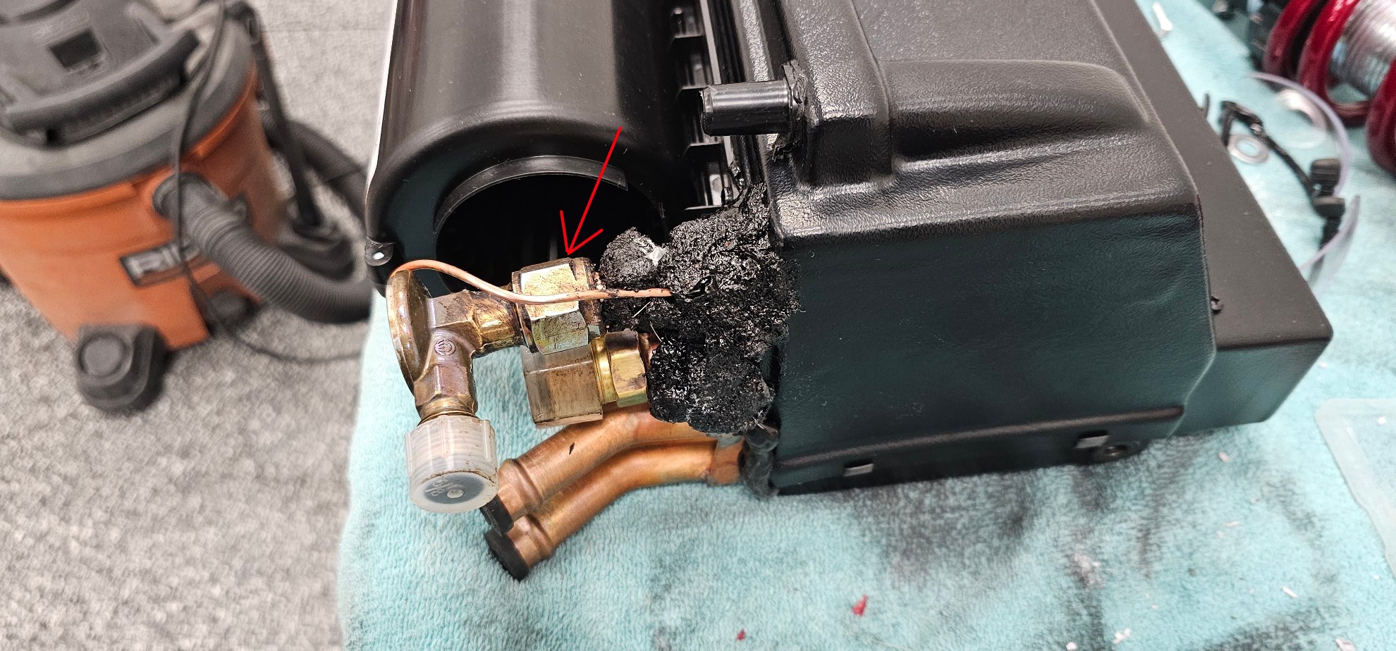

Remove some of the black sticky tar to expose the nut. Thanks Cam and others!

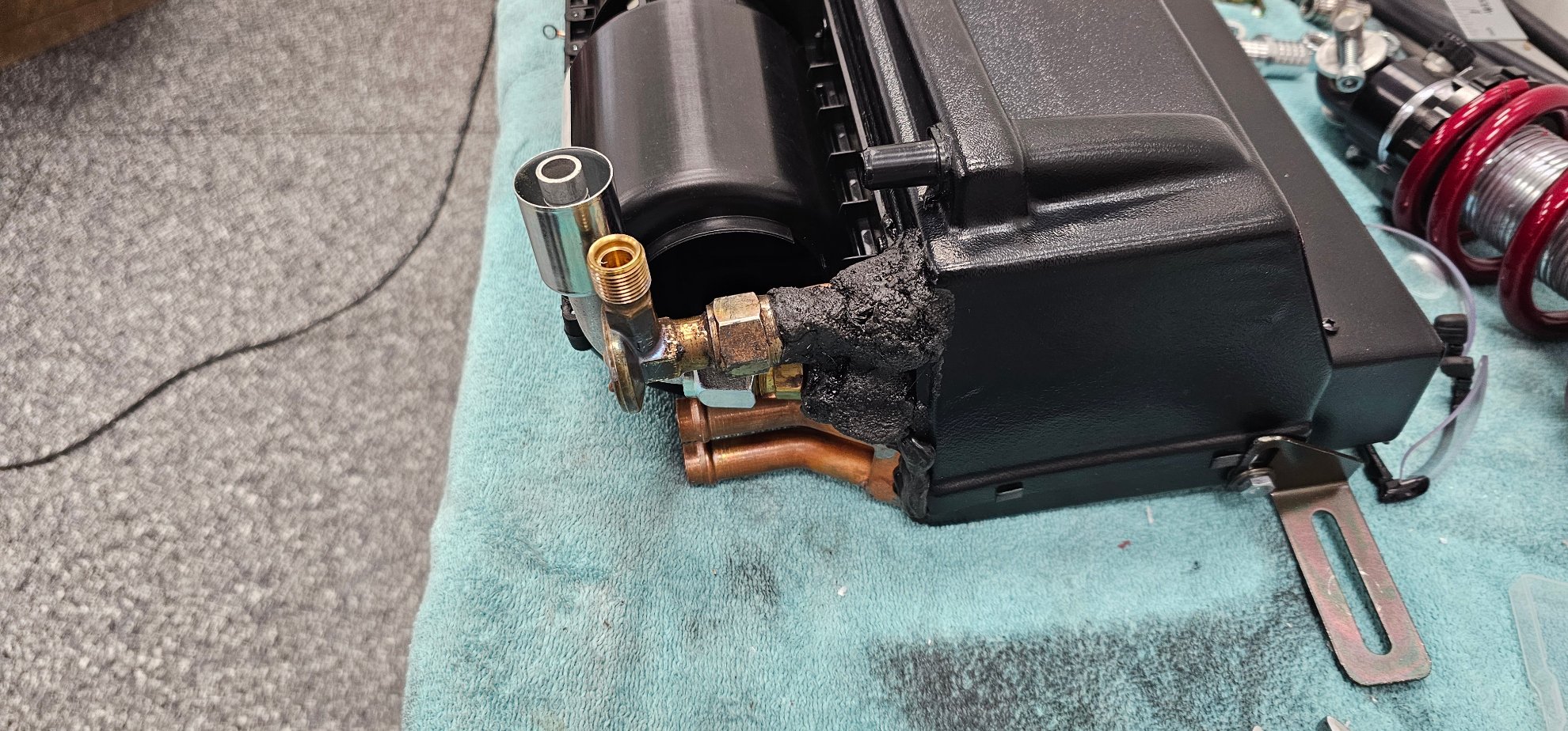

I rotated them all down and bent the heater core tubes in.
Unit with hoses pointing down
Clears pretty good

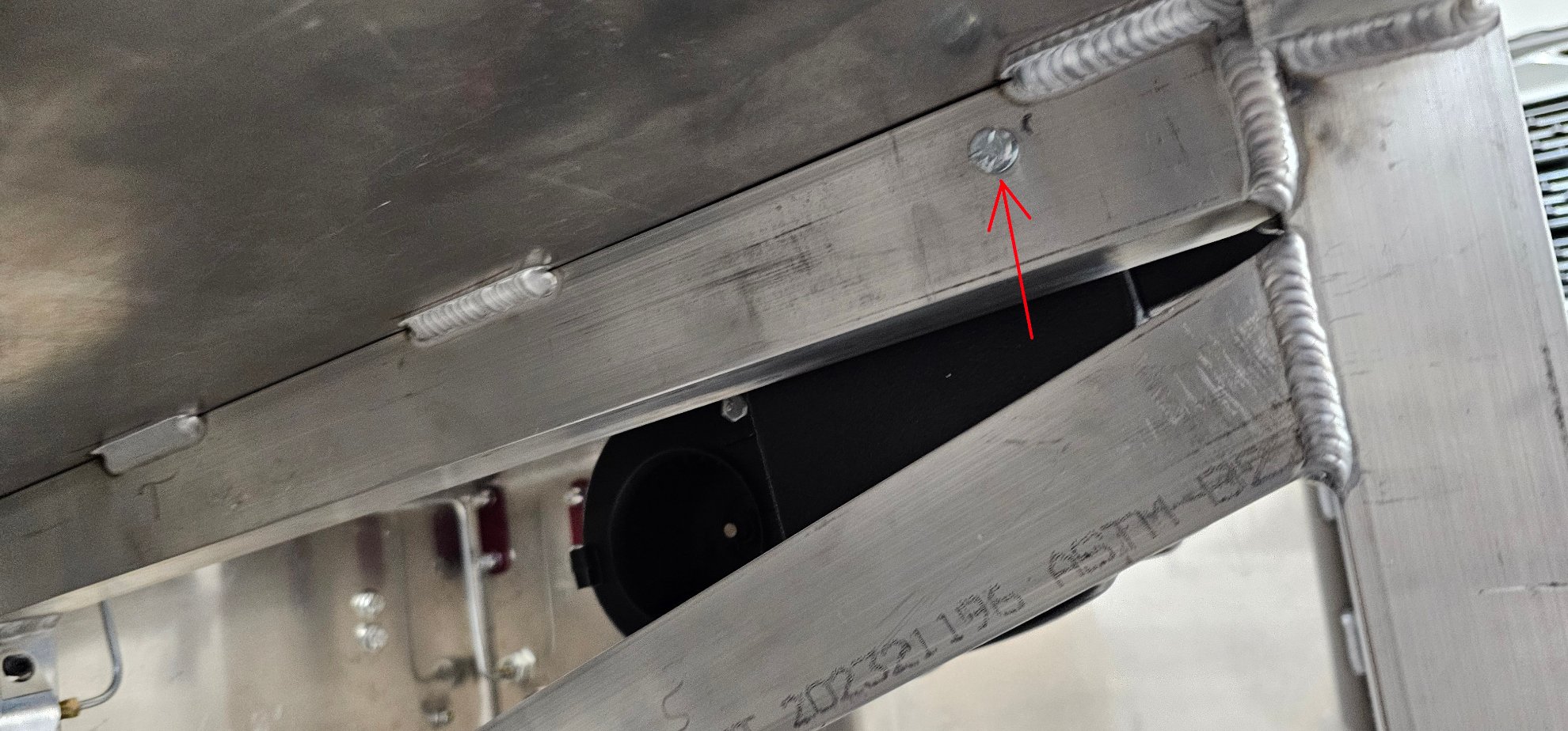

Made all the mounting accessible from inside so if I ever need to service it I can get to all the mounting bolts easy.
I liked how this one turned out. I drilled through the member and sucked the unit up to the cross beam
I will cut out the holes and I need to fill the one that is half exposed.
Overall I think it is going to work really well. It is nice and solid and looks good. Just need to think about how to get the hoses inside.

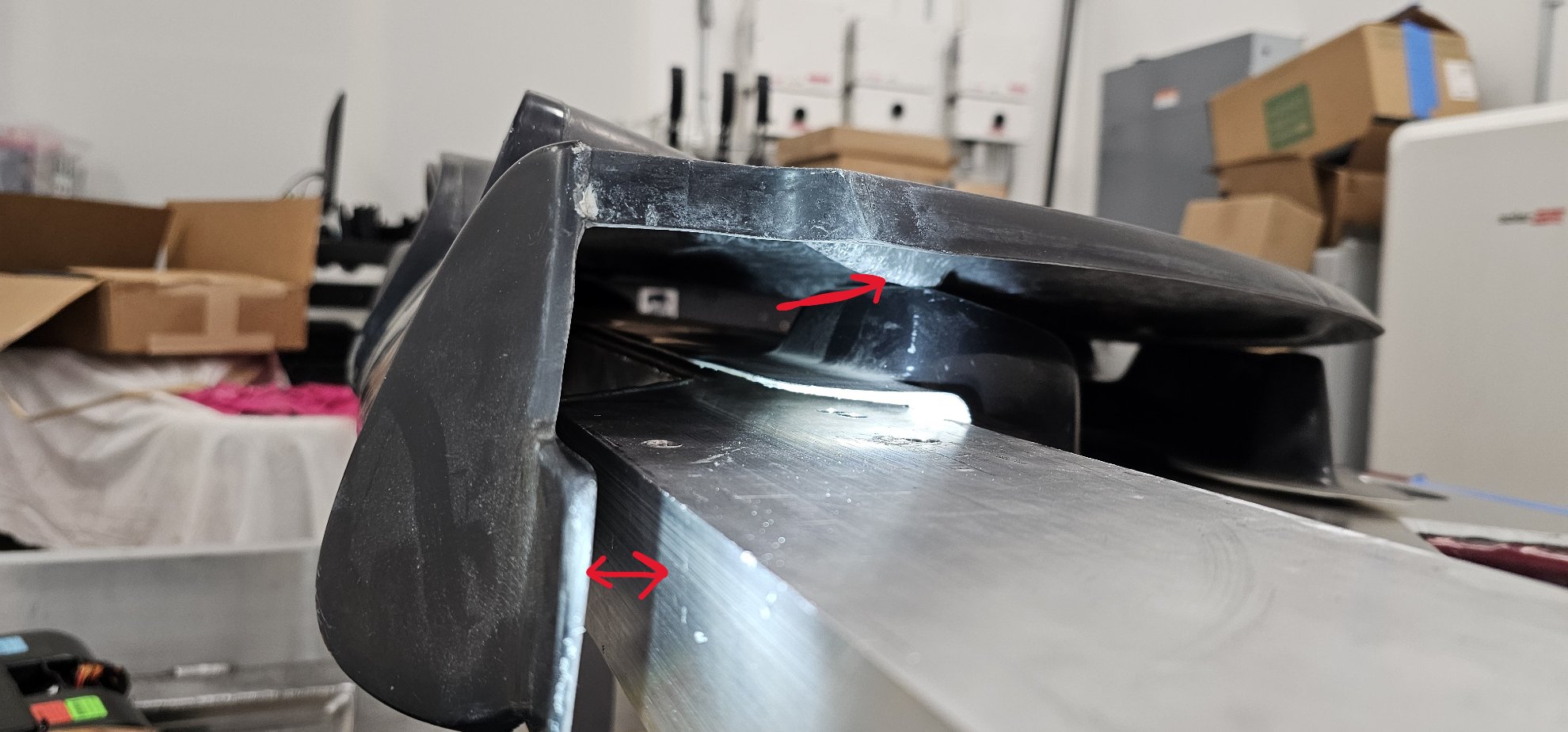

I need some help on the dash and defroster vent mounting. I have searched this forum and can't fine too many images on how these get put together. My main concern is at the dash cross brace. Is it supposed to set down on top or is it lifted off? I like the way @KENS80V built the stand offs, post #1022. Is this why you used them? Does the dash not rest on the defroster mount? I don't have anyone to help me lift the body on top to check it out.
Mark B.
For the vent plenum, several builders have chosen to modify it or even discard it entirely in favor of running flex hoses.. The final dash position will be dependent on where your body ends up sitting, then you align the dash to that. In my case, the dash defrost vents had around an inch of vertical clearance to the vent plenum, and the gap between the front dash mounting wings and the face of the chassis (your last pic) is about 3/4". Again, there can be a lot of variability there depending on the final position of the body.
