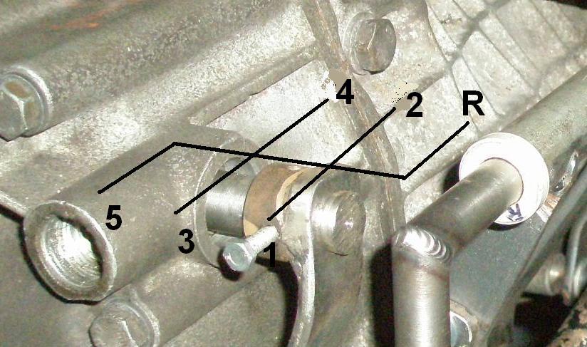

I found a shift knob from a Mercedes that has this pattern printed on it. (I had to add the dots here to make it space properly since this editor takes away spaces).
You need the reverse lockout mainly to help you find first.
I presume you have the bar mechanism shifter instead of cables. If so you will need to stiffen and modify the linkages to reduce compliance.
-Bob Woods

Hi John,
this may be of use
Rgds,
Andy
