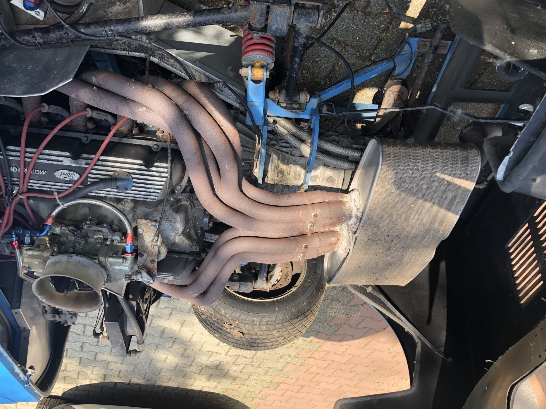

here's a picture of the actual system installed(lots of work ahead...
Mike Pass
The exhaust you have is an original GTD non crossover system as far as the primaries. The silencer box is big but very short because of the primary pipes extending a long way back. If you want a really good SS system there is a really nice full Simpson system (302 size) for sale on the GT40 Enthusiasts Club website. It uses a clamp system so the silencers can be quickly changed. It actually comes with a set of megaphones as well as the silencers but these may not be the thing for a low noise level but maybe try them later after you pass the test! With the ring clamp quick change set up you could quickly test different silencer setups. If I remember correctly this system uses 1 5/8" primary pipes. The silencers would be ideal for road use after you get past the test as from what I can remember they were OK for noise.
As you have a double pumper Holley it should be easy to cut off the secondary chokes and fuel and to reduce the primary diameter with a plate with smaller primary holes to reduce power and noise.
