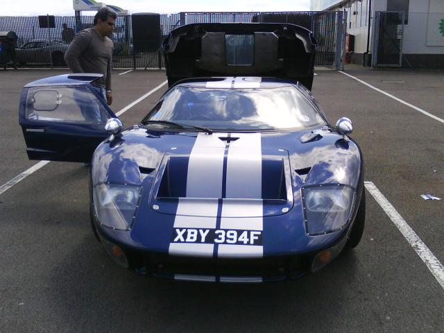

I thought I would share my trackday experience at Silverstone GP circuit last Sunday in my CAV GT40. This was only my second trackday and so was a little apprehensive to begin with. There were no slow cars on the day, the field comprised of Porsche GT3's, TVR's,Radicals and fast Caterhams ,Ferrari 430,there was even a Porsche GT2. Needless to say that I was slow to begin with as I had only done Silverstone on my Xbox 360 before!.
After a few laps and my son acting as a co-driver I soon got the hang of the circuit and I was able to keep up with the Porsches, I even passed a lovely black Corvette Z06. I was really pleased with the Avon cr6zz tyres I had put on the car recently ;provided enormous grip and confidence. Driving a GT40 fast is a physical experience especially around slow corners when the steering feels quite heavy and strong arms are required, power steering would help.
