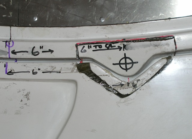

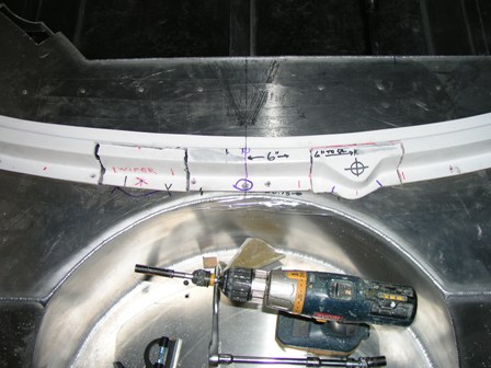

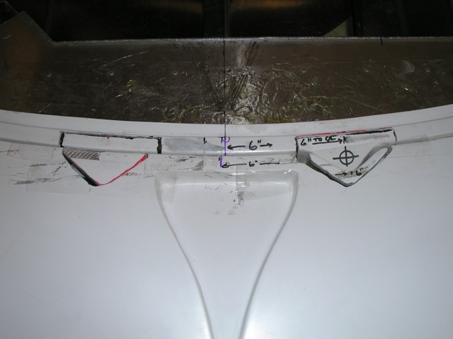

Chris Kouba
Randy,
If I can do it, you can do it. Seriously! Takes all of one afternoon.
attachment.php
attachment.php
attachment.php
Chris - Great pictures! Measurements and all ! ! ! :)
Since I have some other fiberglass work to do on the spider anyway - I'll probably go this route...
Chris Kouba
Randy,
I hope you also caught that clicking on the text of the post takes you to the post in my build thread with a few more pics.
This was the first glass work I ever did. I took my time and it came out extremely well (with a LOT of thought and fear leading up to sawzalling a perfectly good spider). Have no fear, even with my hesitancy, it only took an afternoon. It's very straightforward.
