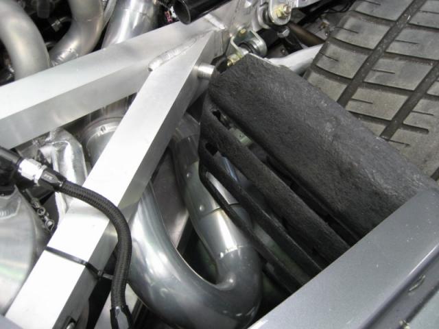

I was going to do this out of aluminum with punched in louvers to achieve the same thing essentially.
attachment.php
Molleur, the oil coolers are mounted to the spyder. We actually have aluminium mounting brackets bonded to the fibreglass spyder that the oil coolers mount to. There is a cooler on each side, one for engine and one for transaxle.
