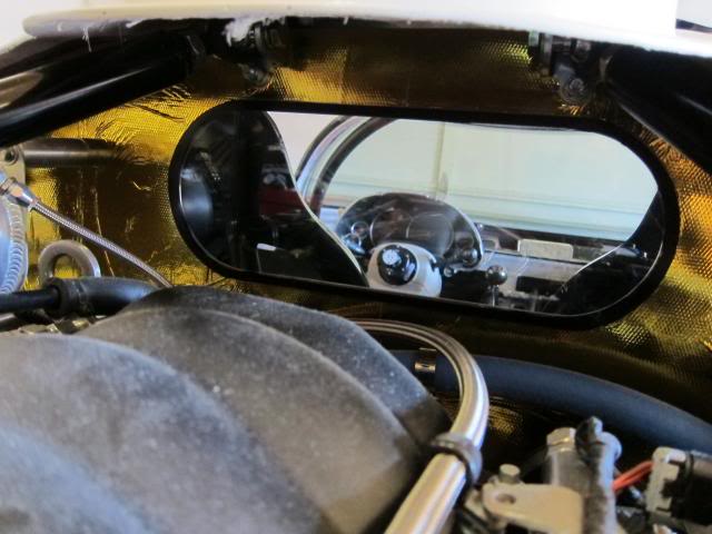

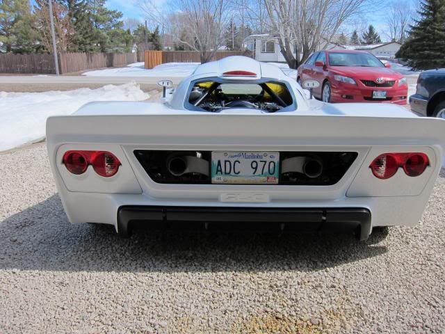

My SLC rear window is fully functional but only because I’m using a stock LS3 intake manifold. The LS9 engine would completely block the view though. Any type of top mounted supercharger or high rise manifold would block the view.
Ken Roberts
Here are a couple of earlier pictures of it. The visibility is definitely not zero. There is a plain line of sight right over the back spoiler. A rear view mirror would need to be attached to the top of the center dash similar to a C1 Corvette.

Ken thanks a bunch for posting the pictures! It has helped me decide that I will add one for sure. I like how you extended the bulkhead using what looks like cut aluminum tubing and plate for the depth to bring it level with the roll bar, I take it for the fit of the interior panel. once again thank you............m
I went back and looked and I see you rolled the aluminum. When I get some time I will have to look at your log....m
Ken Roberts
The aluminum is actually a 6 inch cylinder cut in half. It's definitely overkill. If you have good fiberglass skills you could probably make a much lighter version. I wanted to help stiffen the bulkhead in that area to help prevent cracks from vibration or heat/cool cycles. The inner panel bolts to the outer panel with six bolts around the perimeter.
