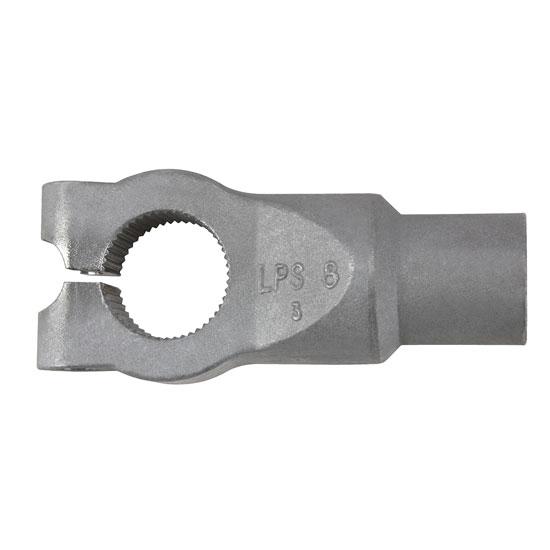

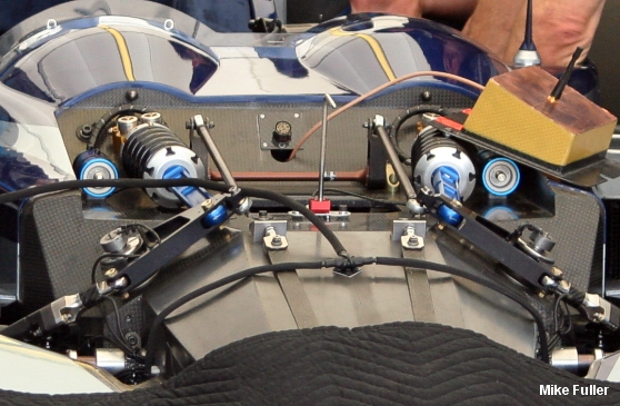

I have been looking at these type of anti roll bars for quite a while and I think it is the best solution for the rear. I've played with a few calculators and it's quite doable if you use multi setting arms with a few holes in them for adjustment.
The front is the more difficult of the two ends because of the need to clear the wheels. If you used these on the standard bar from RCR and made some tubing torsion arms bent just right it might work better than the ones that came with my car.
Torsion Arm End 1 Inch Splined - Speedway Motors, America's Oldest Speed Shop
