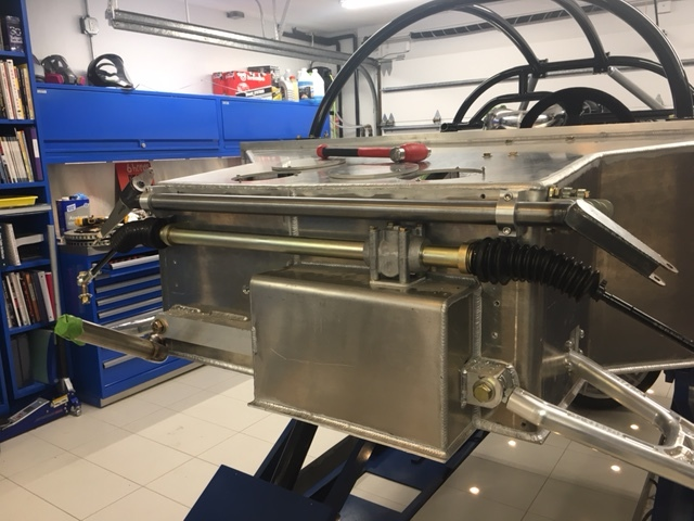

The front sway bar can be easily mounted to the top of the foot box if you haven't mounted anything there yet. This is how it was mounted on the national championship car. I've since changed my sway bar because I fabricated a nose frame which mounts in that location.
Thanks for the picture Scott. my intent is to mount it further away [forward from the foot box] so I can get a better angle to the control arm. We have always used speedways arms and bars and the rating of the bars is pretty simple with twist of the bar to length of the arm from the axis in inches for lbs. I wont be at 90 degrees on the front, but it works for my simple mind and allows me a baseline.
