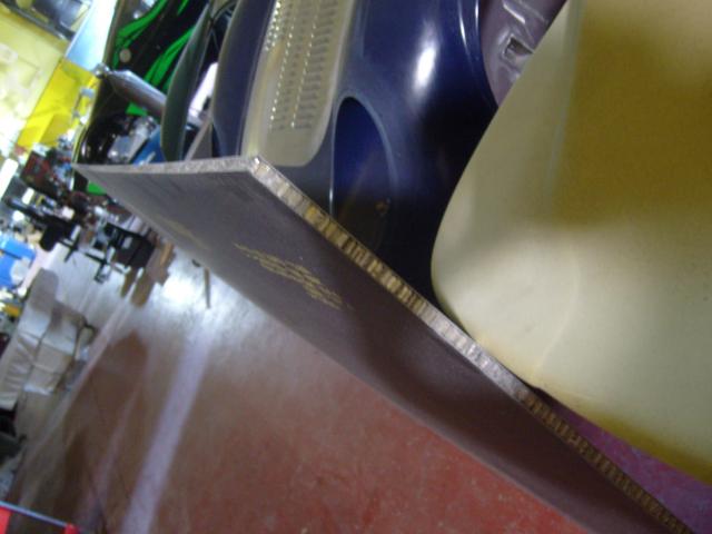

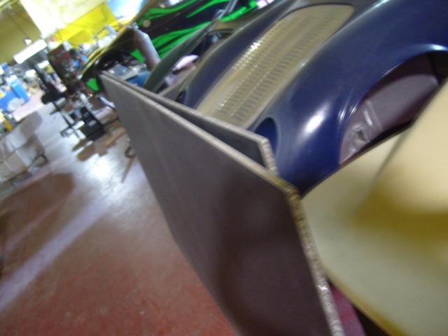

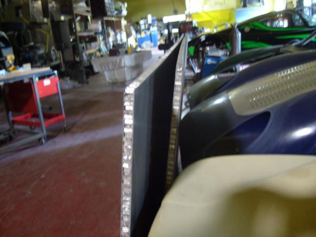

Here is a sample of some of the materials that are going to be used in our chassis .....we have been testing it already and will be implimenting it very soon in some track cars...:thumbsup:......
Carbon fibre/Aluminum core honeycomb in a customers 904..and maybe a Superlite derivative

Are you going to use this to make the chassis monocoque. That is how the Mosler chassis is made.
Well that is neither a yea or a nea, as to using this for the chassis, but it is encouraging.:thumbsup:
I will give it up to you Fran. You never marry yourself to one idea, process or method, though that would certainly be more economical (see the Ultima for the opposite approach).

As for a monocoque.....I have one already....why do two..:rolleyes:
The honeycomb fabrication technique has already proven to have huge potential...and as the materials are manufactured domestically price/supply is not an issue...

For years I've had a piece of cabinet from the inside of a Lear Jet in my lab .... cracks me up, it's a very thin laminate of wood over honeycomb. Looks like walnut, weighs like balsa. Can't seem to toss it out - it's just too cool.

Thats the material we used on aircraft interiors in corporate and privet jets. Very strong and light. They make a similar material that is highly fire retardent. It can also be curved to make radius corners. We would fabricate the panels and then venier them with some of the finest woods in the world. We did an interior on a Bell 214 for the King of Brunei. Everything was birdseye maple and gold. Unbelievable, Of course cost was no object. The sinks, toilets and showers were always gold. Not gold plate. Many of the aircraft would come with guards to make sure nothing was stolen.

Fran, nice stuff the carbon skin honeycomb. As you probably know, the origin of this stuff is the old aluminum skinned panels (used extensively by Boeing and other aircraft mfg's). A confidential source has done some testing on this material for a very large buyer of planes utilizing this material. Initial results indicate that while the aluminum skin version is quite resistent to water intrusion through extensive cycling, that's not the case with the carbon skin. Obviously, not good to have moisture in the cells, and, the moisture accelerates the deterioration of the resin bond between the honeycomb and the skin. You would think the carbon skin is waterproof.....and it is.....until it goes through a whole lot of cycling under some load while in the presence of water/moisture. I would guess that an additional coating on the carbon skin would improve things but don't really know much about that. Just thought I'd mention it if you're planning on using it in stressed areas exposed to the weather.
