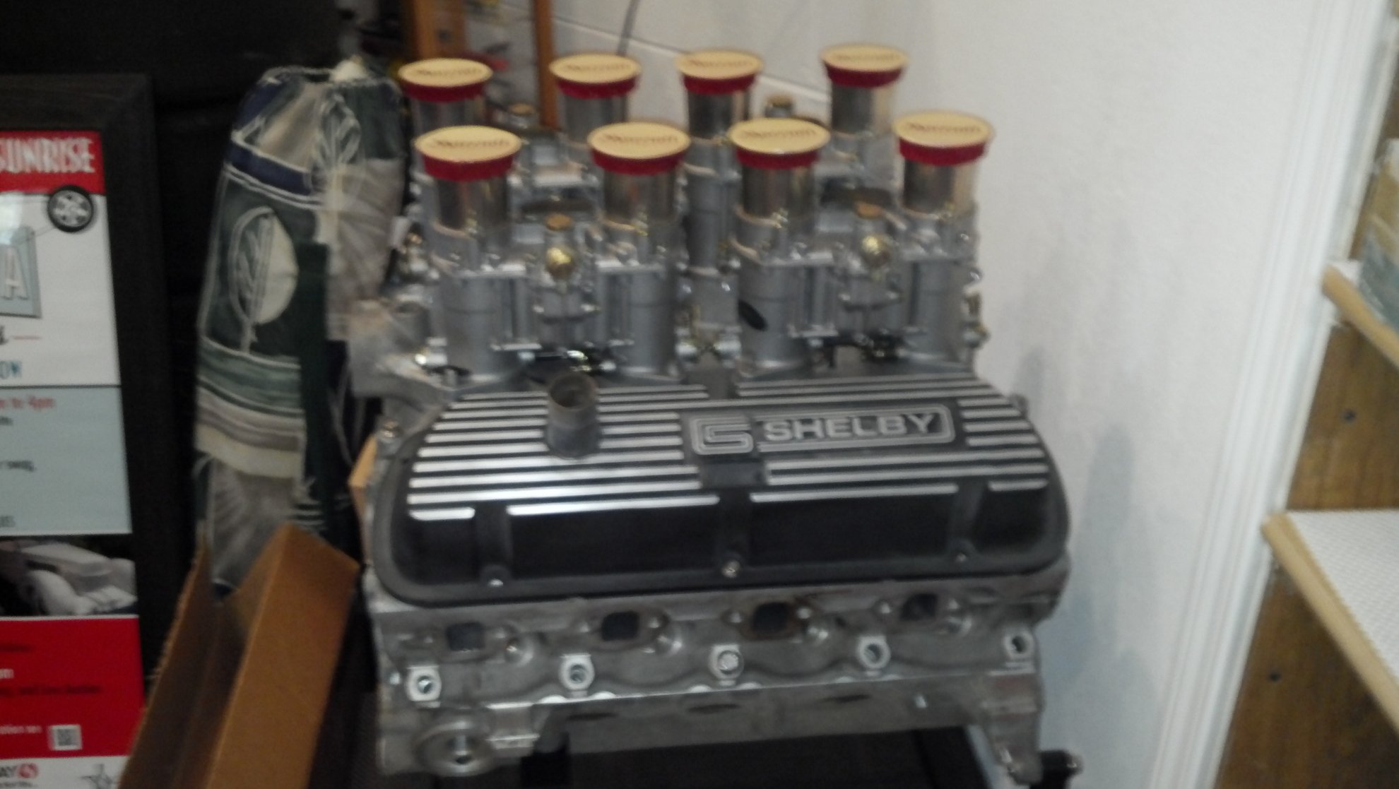

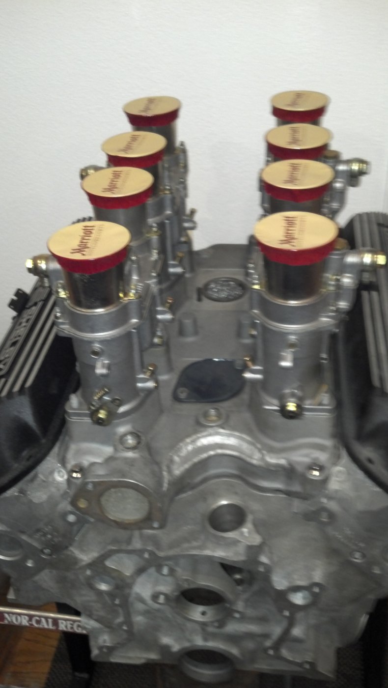

I thought you guys might like this picture of a mirage GT40 aluminum engine that I used to own.
The heads are not correct as they are 1973 Aluminum stock heads I figured they could be ported good enough to work on the engine.
Roy
