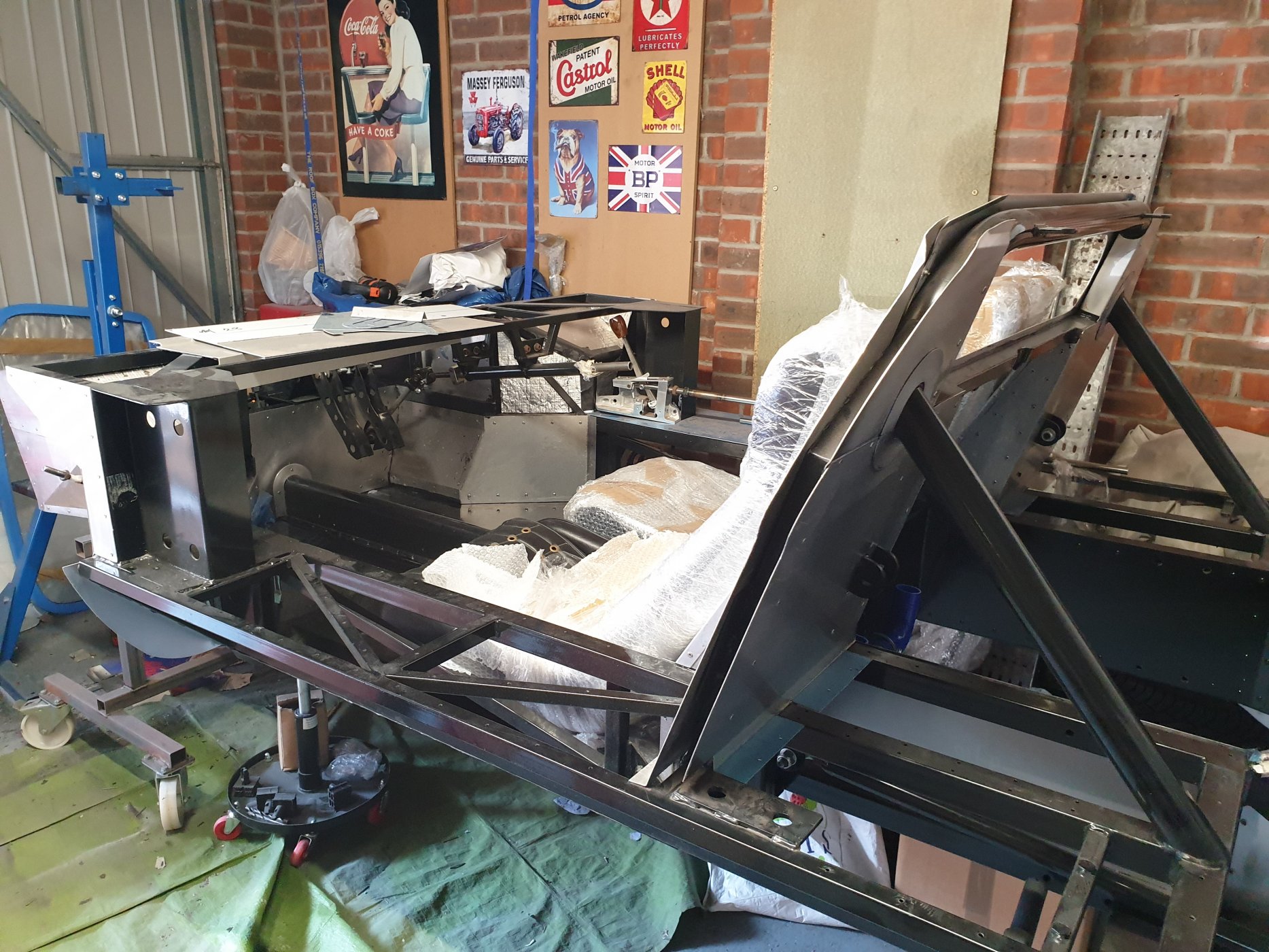

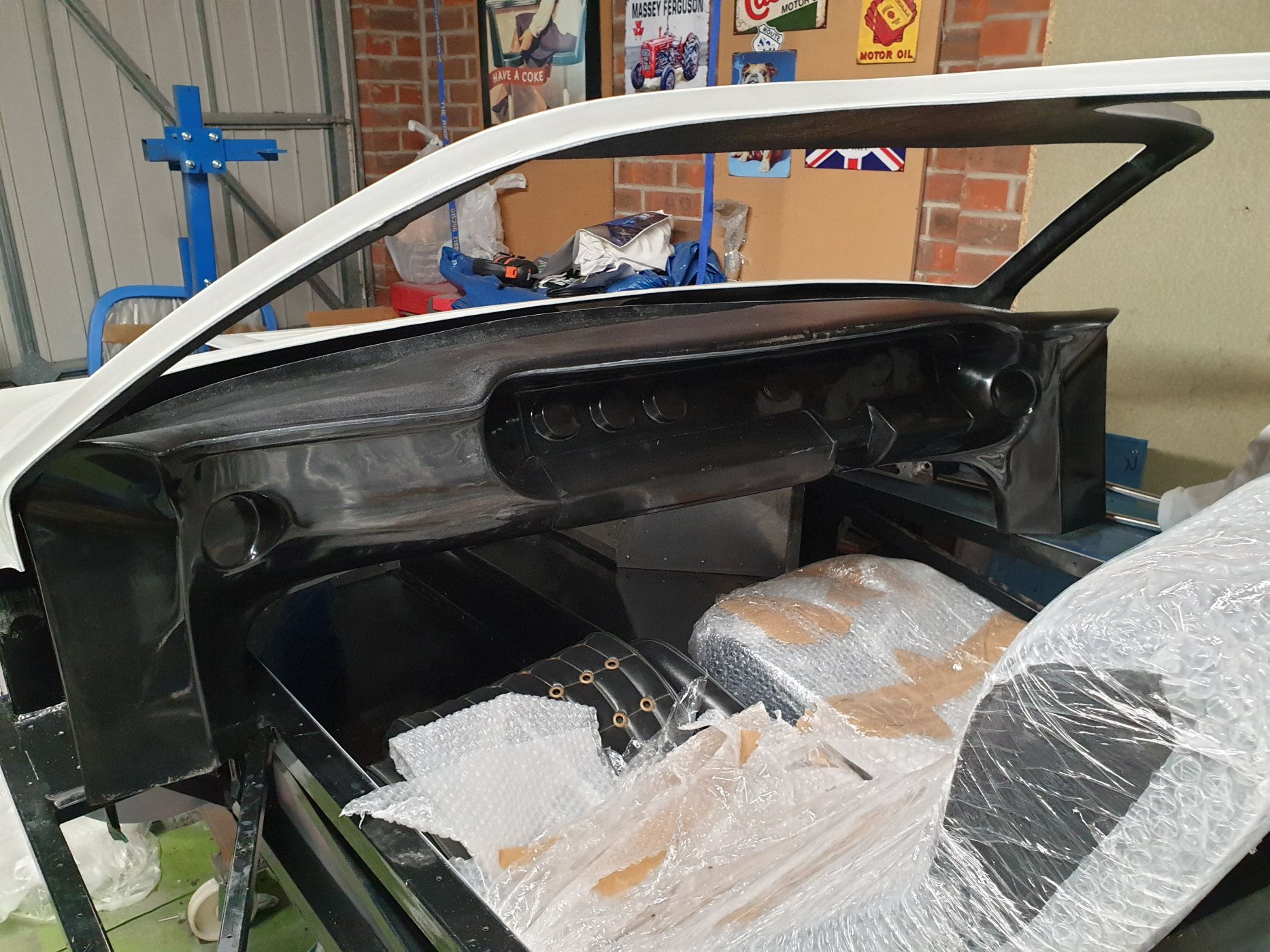

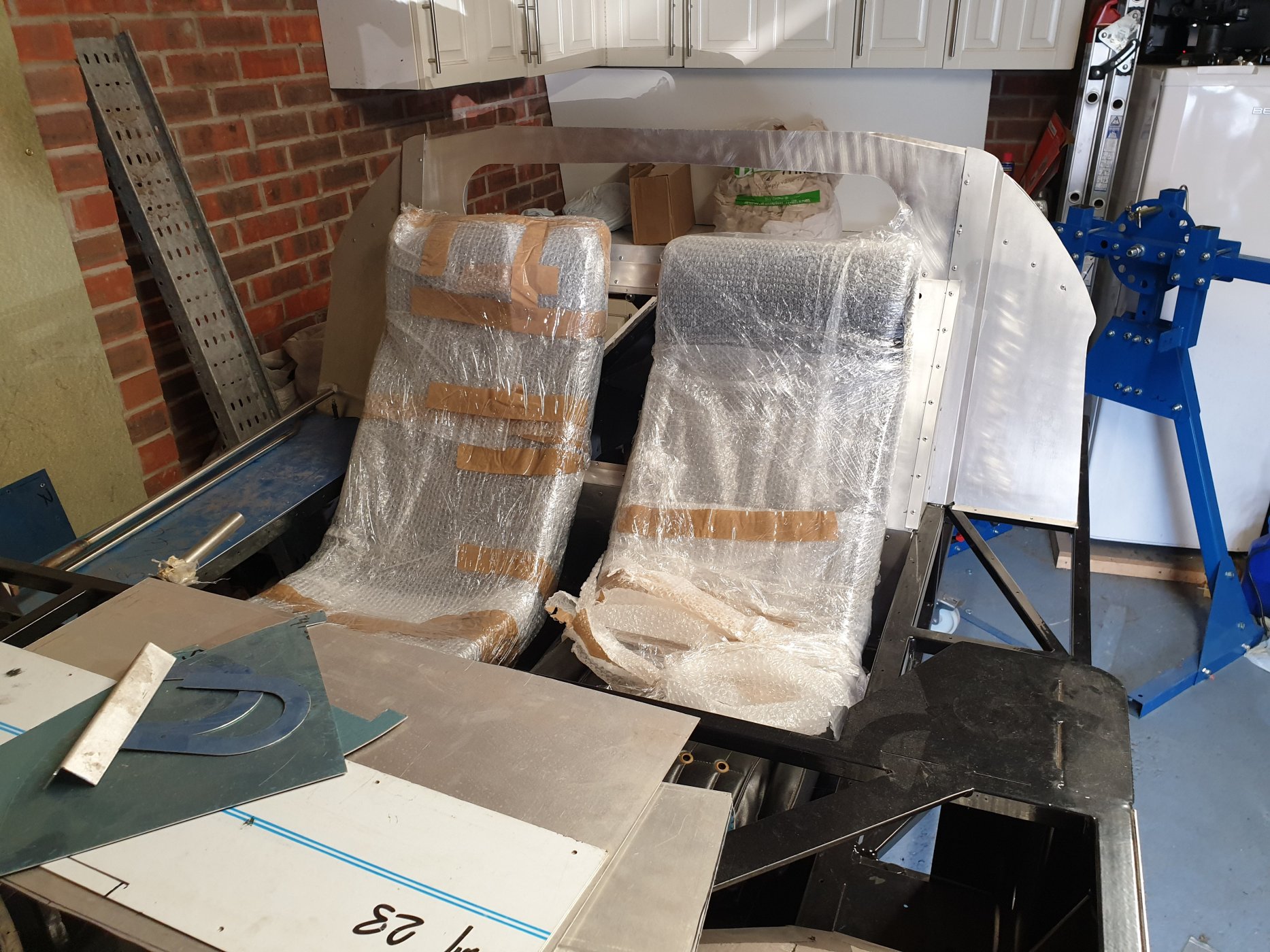

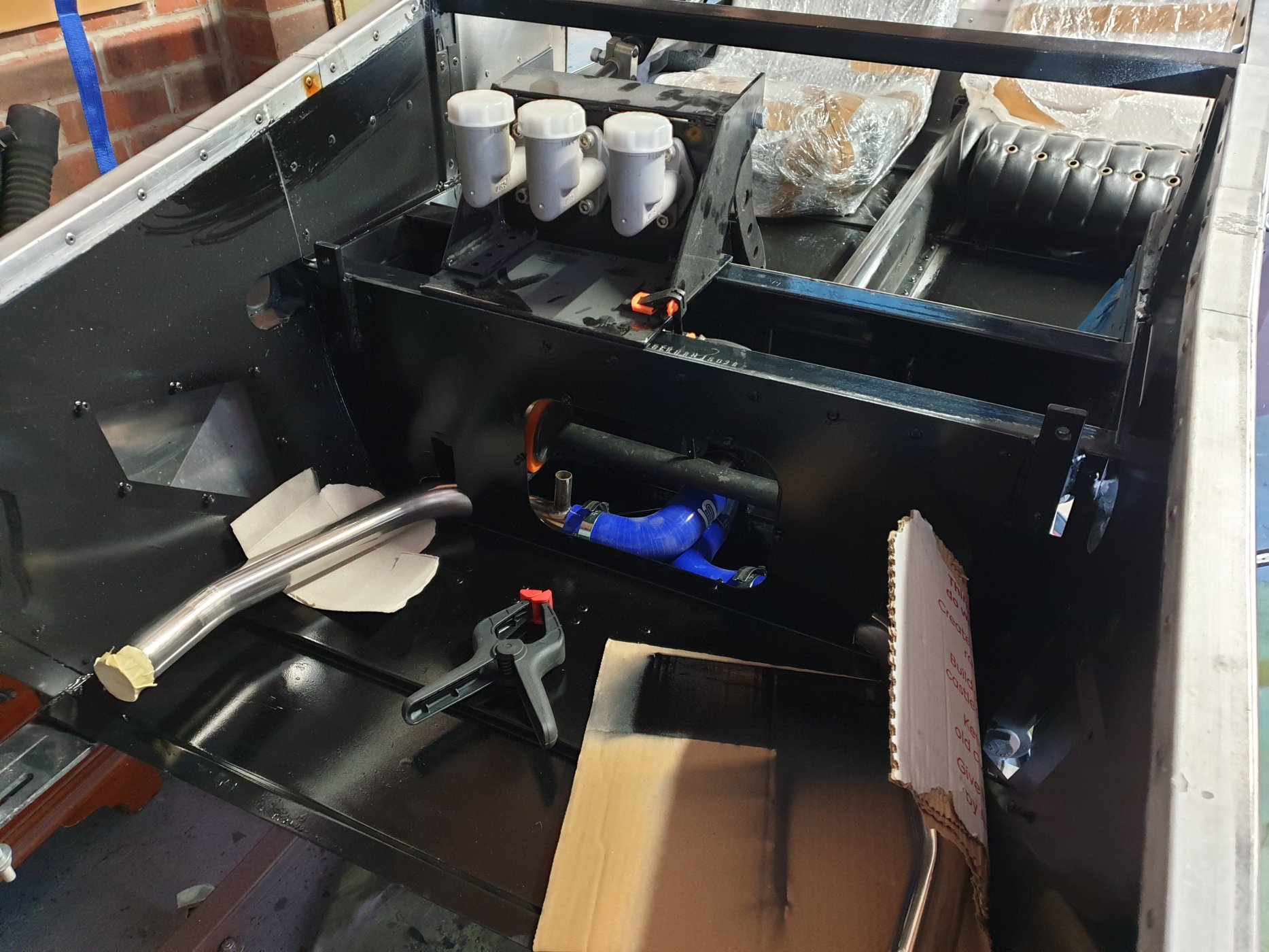

Primer and top coat done on the base and car finally off the rotisserie. Playing with seat placement and pedal box placement before doing the brake plumbing and aircon placement.

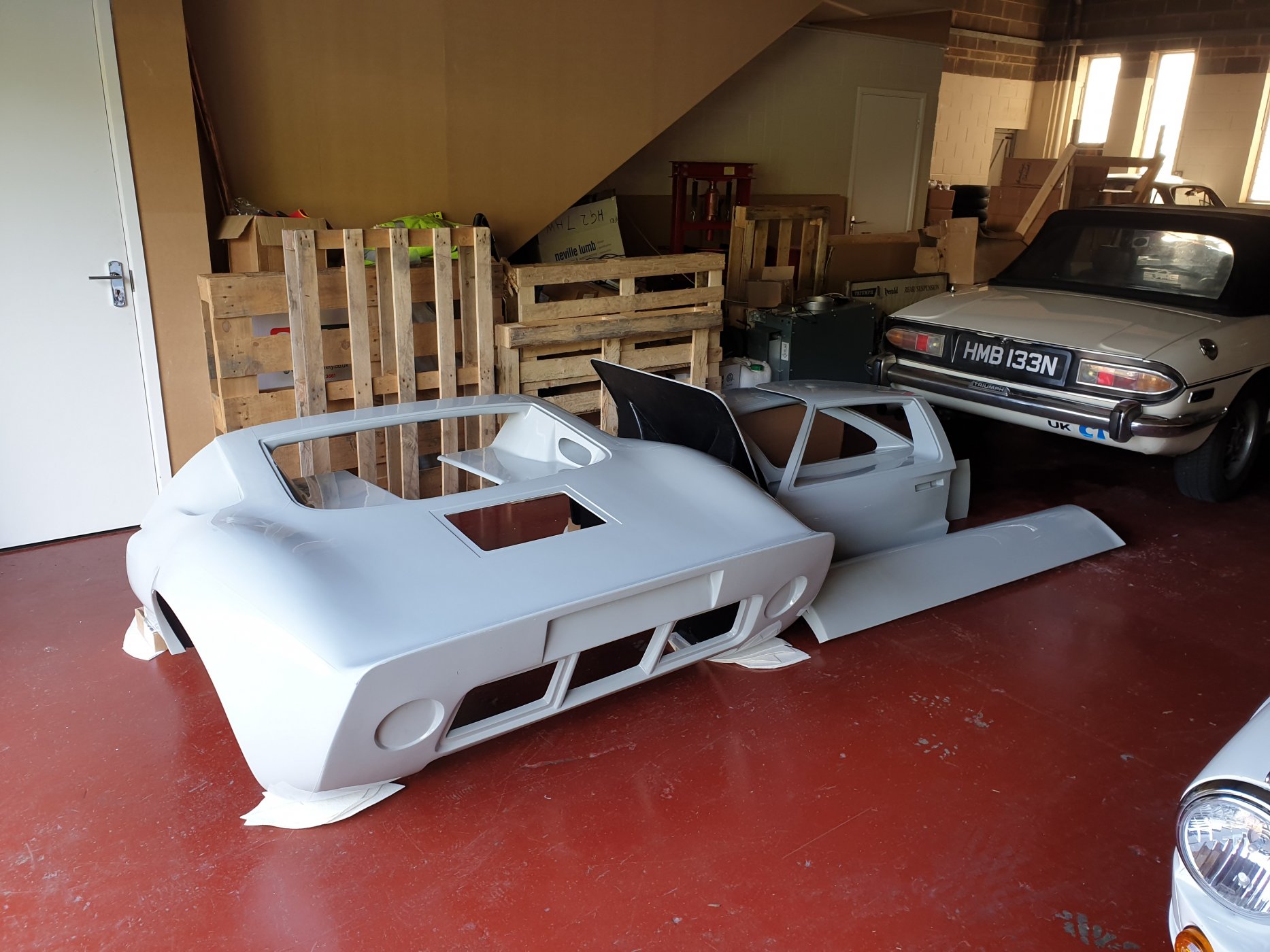

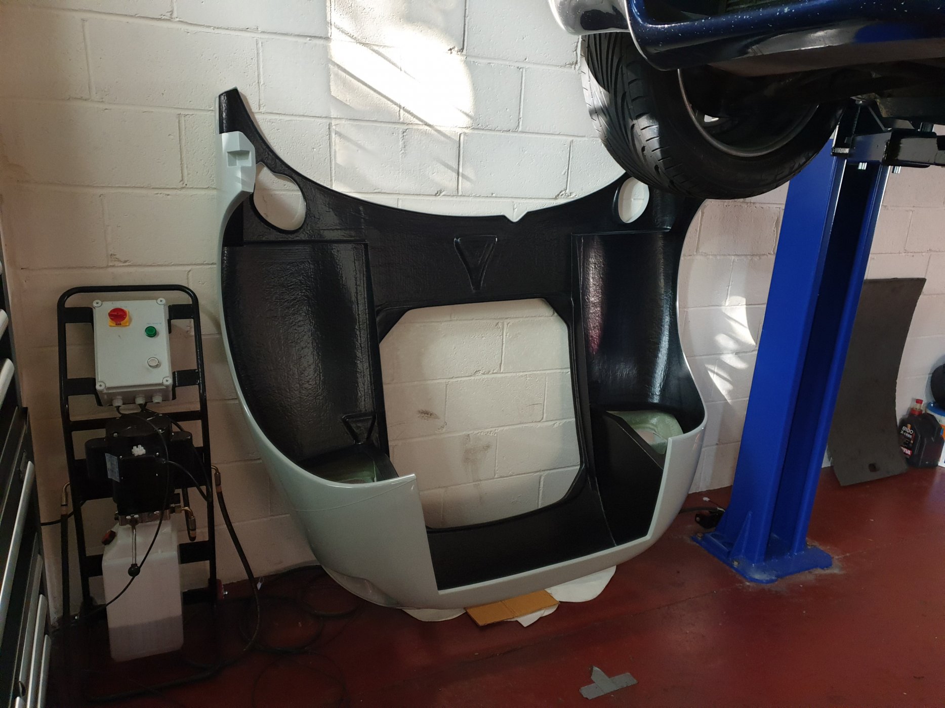

Still here. Just been busy away from the car for the last 2 months. Not ideal. Managed to get my body however. Not ready for it but it was doing my nut guessing where I was drilling holes without the certainty of knowing where body parts went.

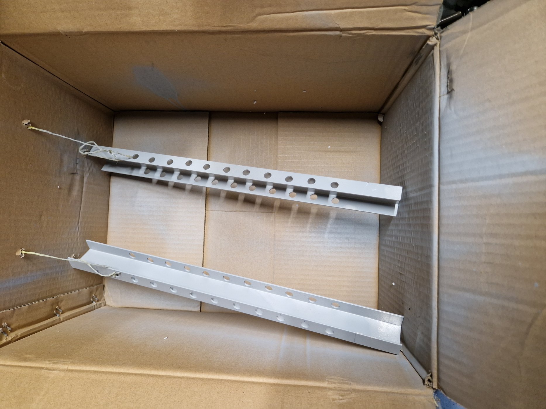

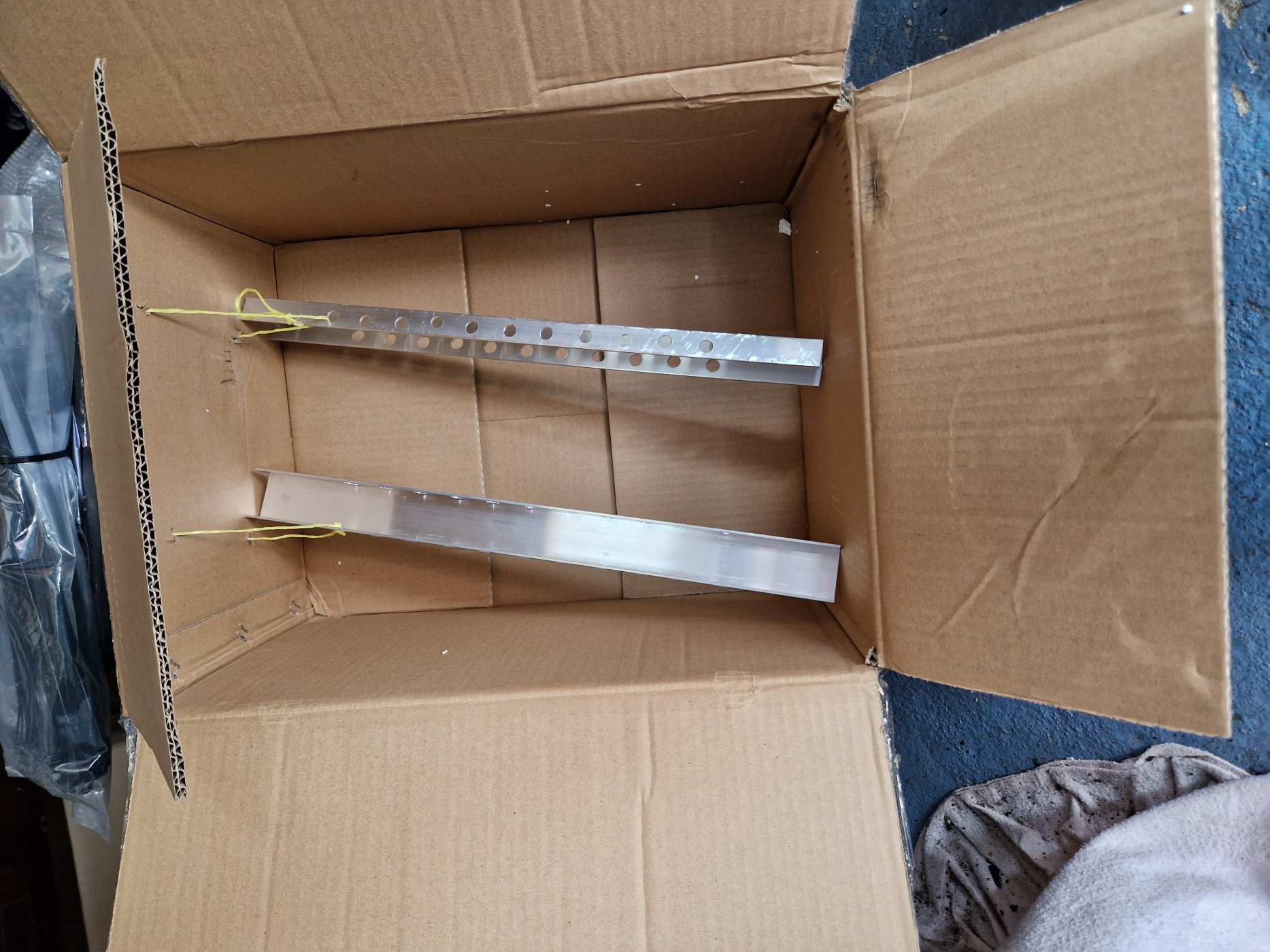

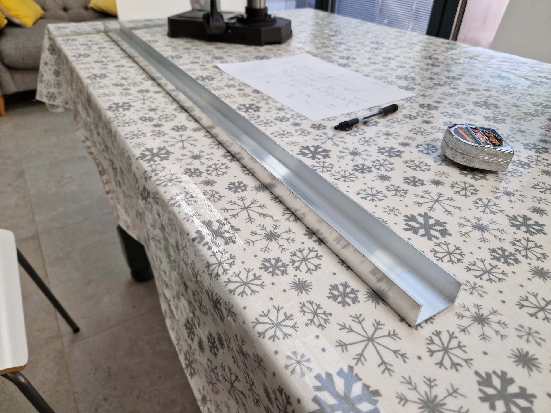

Right. Getting back to the build. Focus has been elsewhere, but now back on it. Whilst I have been painting the driver side front chasis I bought a u-shaped aluminium bar, cut it to x2 46cm bars, drilled 1cm holes along it to start building the condensing radiator frame. Drill press came in handy. Etching paint first layer on as well.

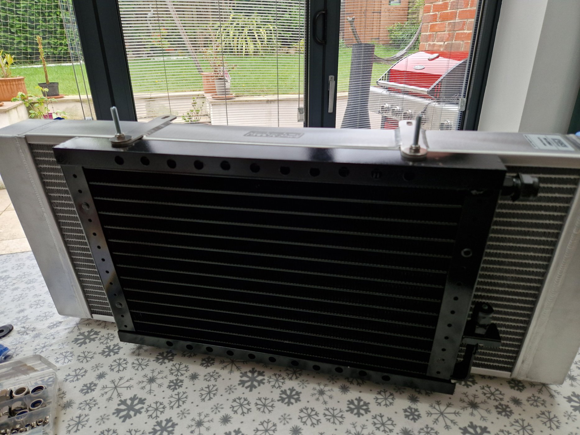

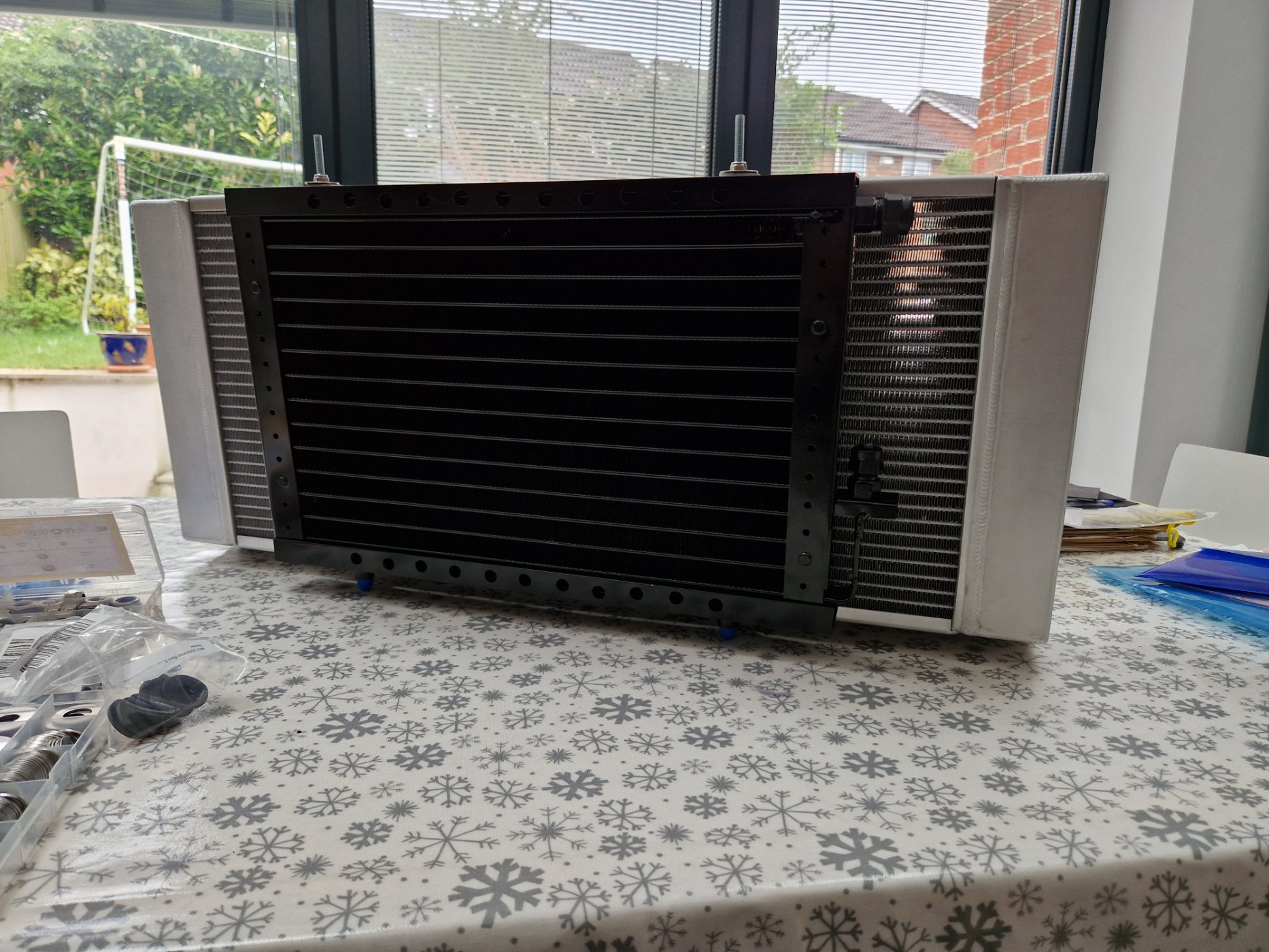

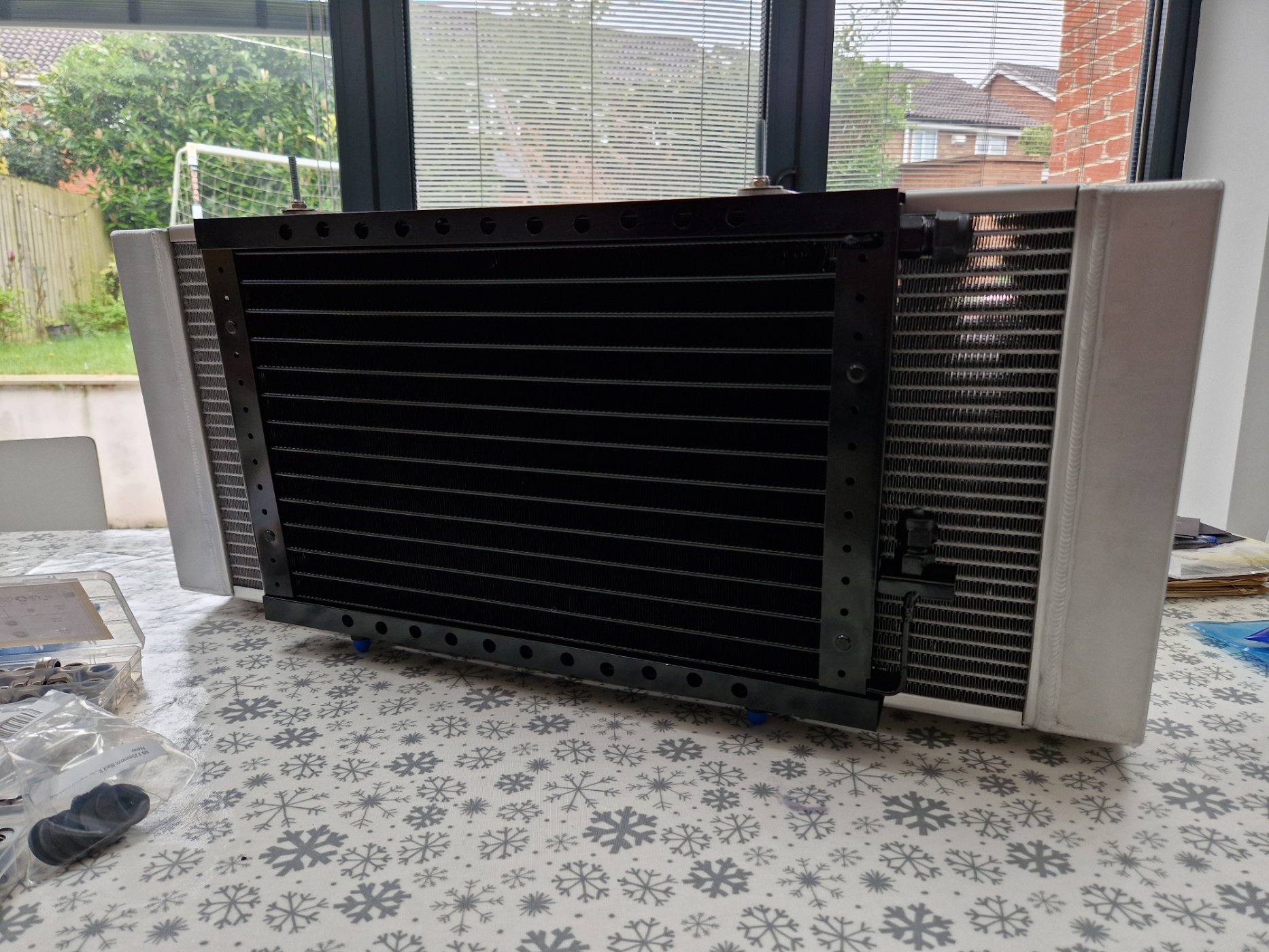

Condensing radiator frame now done. The U shapes aluminium bar worked well. Three layers of etching primer, 3 layers of primer and 3 layers of top coat. Found some really handy 20 degree steel M6 spacers to deal with the angled bottom of the radiator, and bolted together with M6 8.8 bolts. Seems to be a nice tight fit.

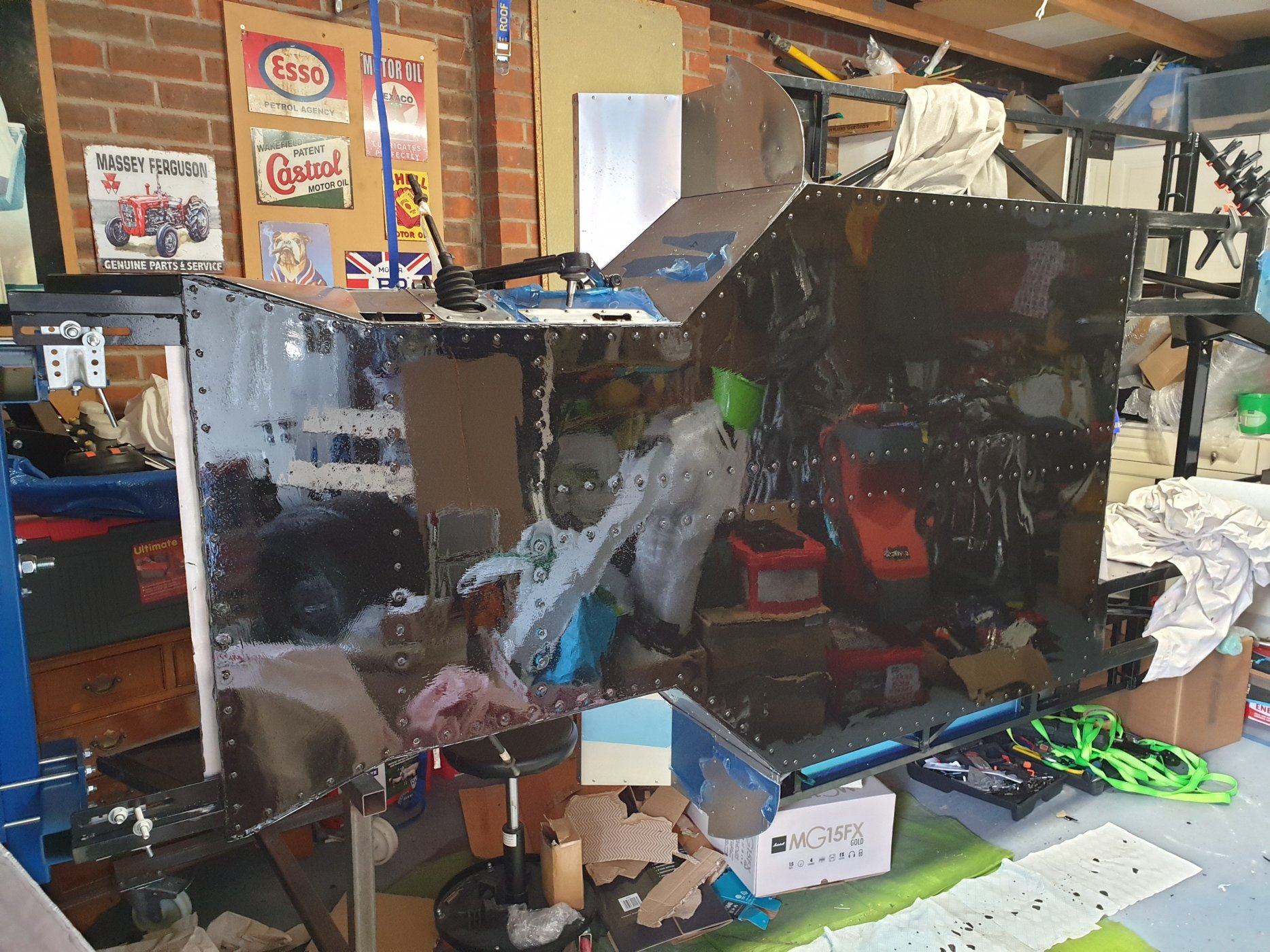

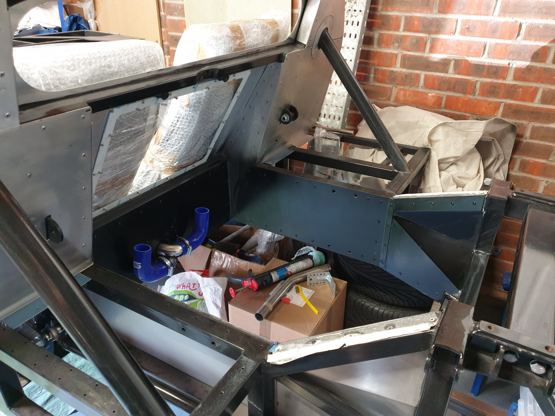

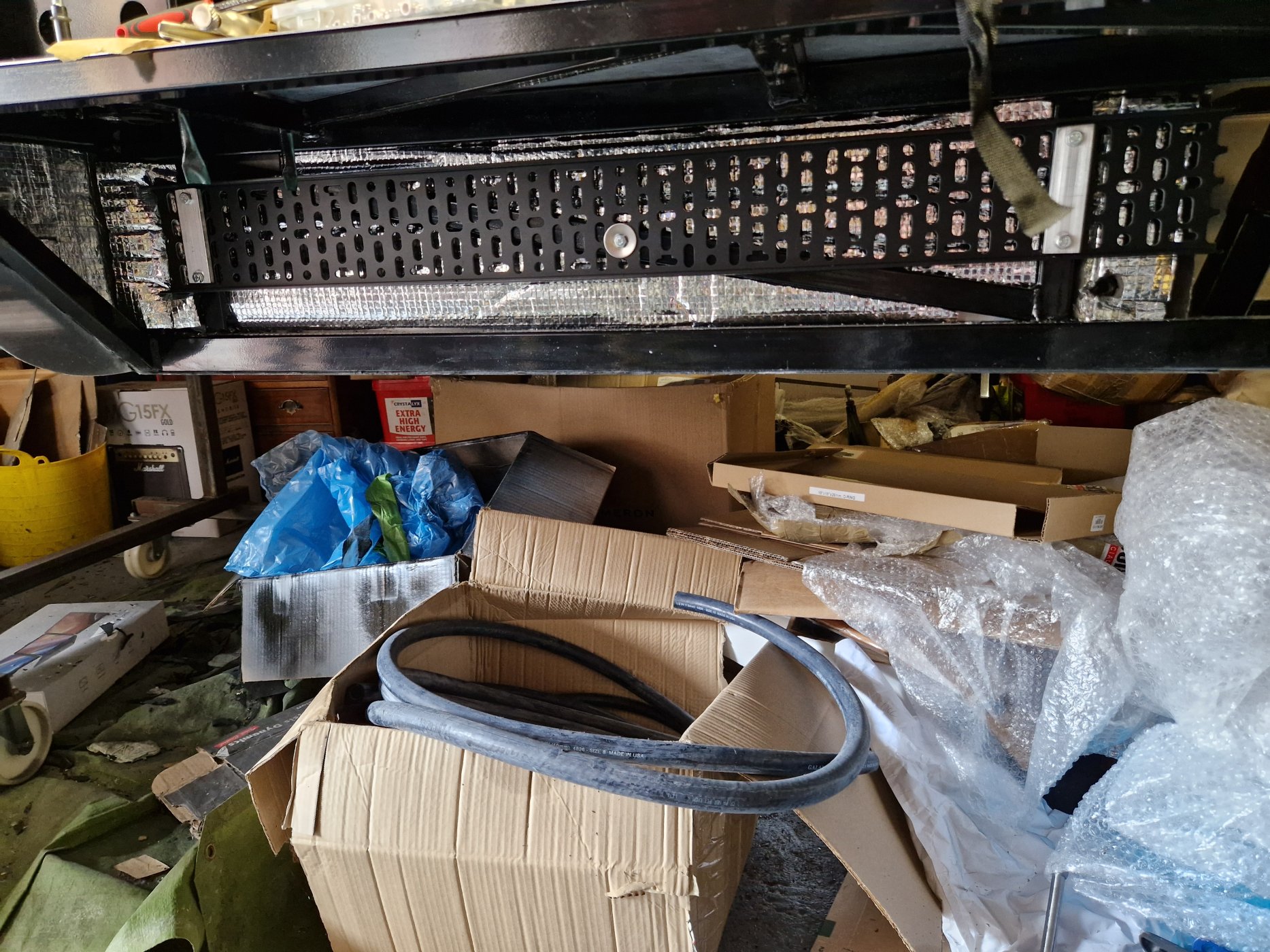

Continuing with the aircon. Just bolted the passenger side service tray in to day. First time with a rivernut tool. So, got sound proofing in behind it as well.
Going to add another bolt in toward the front of the tray to make sure there is limited vibration. Then on to drilling holes for the plumbing and bracket for the aircon unit.
