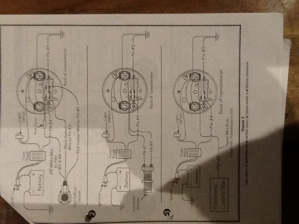

Can you post a pic of your instruction sheet? If the Audi sensor is an un-amplified magnetic reluctance unit that may be covered in the two wire setup, the VDO gauges in CAVs used a powered proximity sensor (three wire).
Is the gauge capable of self calibrating? Do you have the dip switch setting formula or charts? Without knowing the pulses per mile/klm you could be so far out on the calibration the gauge just wont register even with everything else correct.

Have attached the speedo wiring instructions showing the 3 options.
Ian the speedo does have auto calibrating functionality.
Roger I assume the Reed sensor is the same as the inductor sensor? This may be where I'm going wrong
Tom will look into the GPS option if I can't resolve the problem.

Roger are you sure the O1E is a reed sensor? All indications are that the sensor is a magnetic (inductive) looking at the manuals (which by the way is piss poor on detail).
Hey Roger,
did a bit more research, discovered the difference between the reed & inductive sensor. Inductive unit induces a current the Reed doesn't it simply opens & closes. As you have suggested a converter is required to change the signal from the Reed switch to something that the speedo can see so will try Classic Instruments SN74Z.
Mick

Yep that's how I understand it Roger now the problem is how to get a signal to the speedo. As there is no current/pulse coming from the reed switch when it is opening and closing I think all I need to do is apply a low voltage current say 5v to one end of the Reed sensor from the speedo using a capacitor and the other back to the ground connector on the speedo. I'm concerned about applying voltage to the reed sensor and if it will allow a signal to be registered by the speedo. The reed sensor will create a square wave the same as the Hall effect sensor I think which the speedo should see as a pulse. That being the case I should be able to connect to the same pins on the speedo that the hall sensor would. Any electronic wizzes able to concur.
Hi Mick, I just put a fused 12v supply to the sensor and fed the output to the Classic Instrument box. I guess the output is a square wave. It works fine. Cheers Roger
Your a gentleman Roger Thanks should do away with the crap add on's every body say you need. Well Worth persevering.
