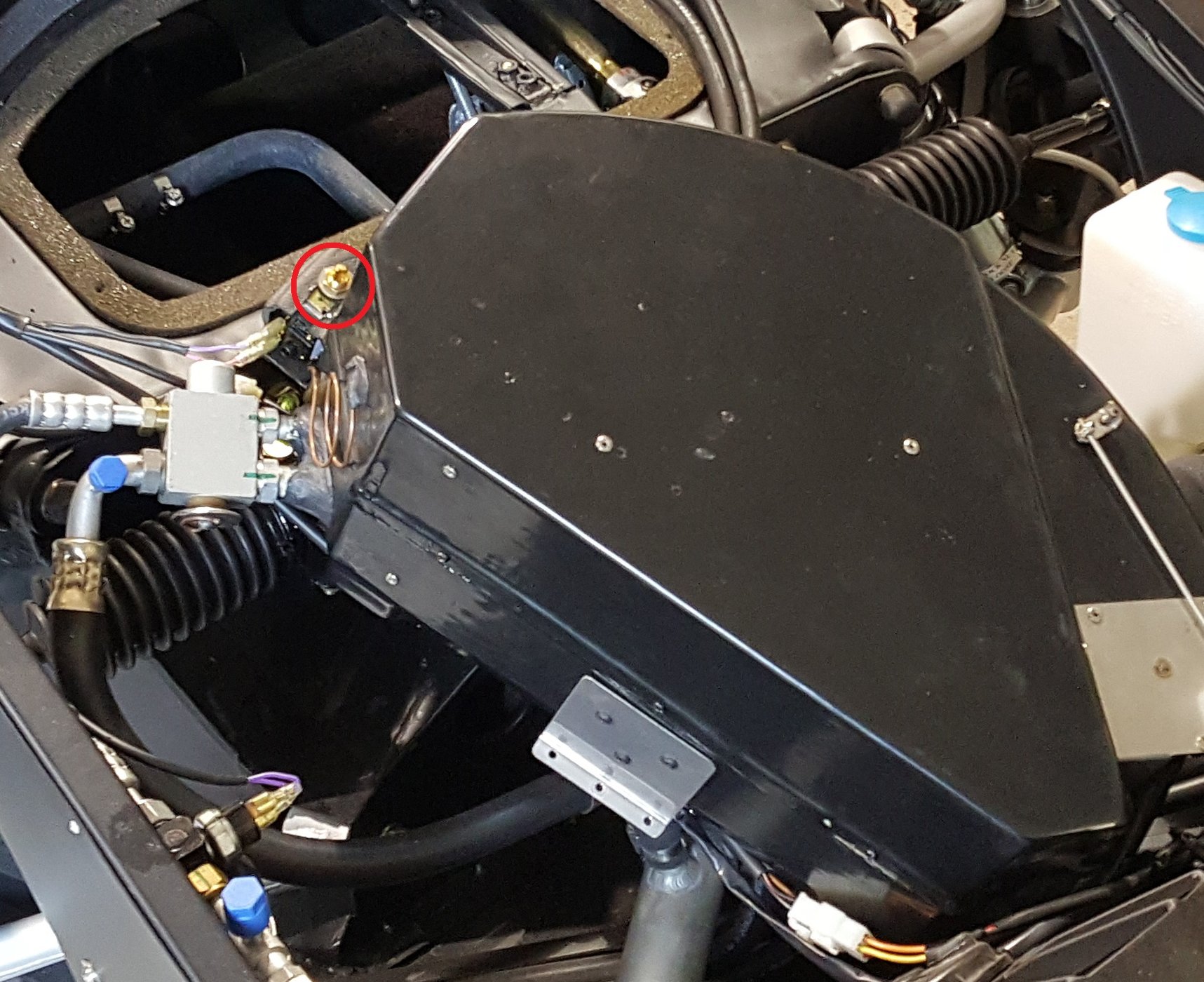

Two other things to check. Is the pipe between the expansion valve and the evaporator cold when A/C running? Also some units have an adjustable thermostat on the side of the evaporator box. It's a brass vertical rod tucked away inside the 'pod' on the side. A little hard to reach, but it can be turned for adjustment.

Update: This thermostat is adjustable. I was able to turn it clockwise, about 90 degrees to the hard stop. Turning it the other way to the hard stop (CCW over 1 full rev) resulted in the compressor NOT turning on at all. Went back to the full clockwise position. Filled with 32 oz R134a, but vent air temps still only about 70-75 deg F.
Thoughts? Should I try to get a replacement thermostat? The evaporator is producing a good amount of water and the lines between the expansion valve and the evaporator are cold. I'm talking in the 50's with a infrared gun thermometer. Perhaps that's not cold enough.

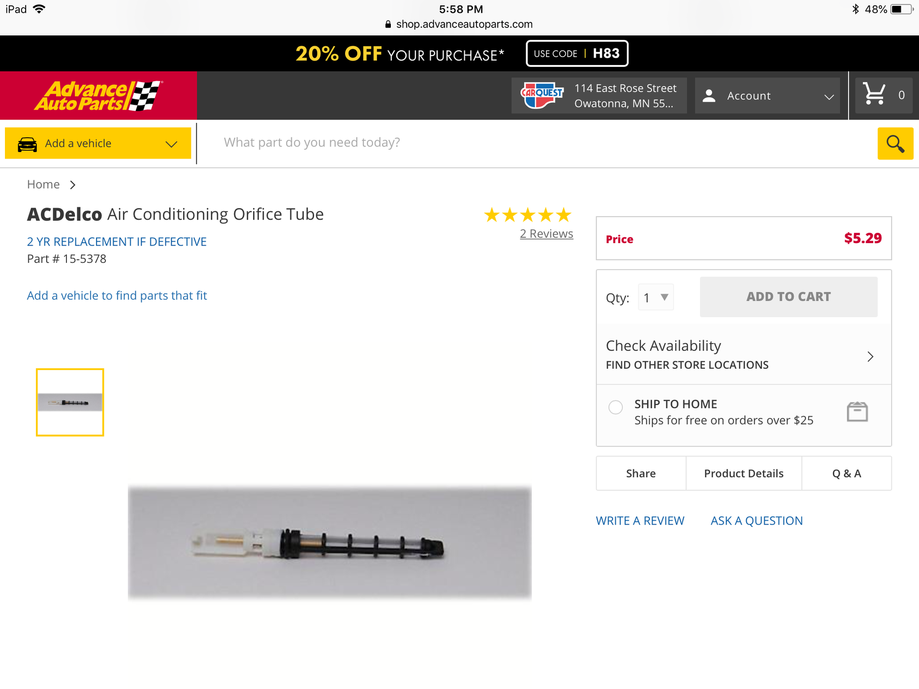

Is there a OEM/late model drier cross-reference? I love going to Advance Auto Parts and hear them ask, "What car are you putting the drier in?"
Where's the filter you mentioned, Randy? Also, I'm not adding oil at all. Just refrigerant. The compressor came oiled from Roush.
