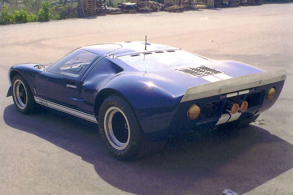

If you guys are going to see how fast your 40 can go you may want to set it up like this one. /ubbthreads/images/graemlins/grin.gif /ubbthreads/images/graemlins/grin.gif
Now that's got a bloody good rear end! It appears to have some big action in the pipewpork department.Nice!

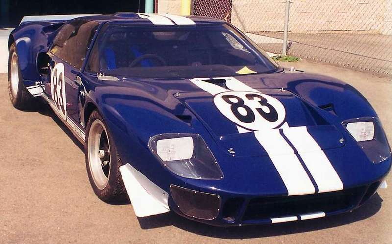

Mark Le Vea, Just wondering. Your add ons look great. Have you actually tested them in a wind tunnel to see if they actually produce enough down force to make the GT-40 MK-1 stable at over 200 mph? On can am cars that I have seen the front lip sticks out in front of the cars about 10 inches and yours look to be about 2 inches. /ubbthreads/images/graemlins/confused.gif
Joseph,
I am attempting to get some wind tunnel time to fine tune the rear wing to be able to balance the whole car aerodynamically. I suppose I should get a single nostril to run also just to get some data.
My design is supposed to turn the lift a GT40 normally sees into a modest amount of downforce. I'm not looking for 2 tons of downforce, about 400 lbs. will do. I "grew up" with a Europa that has more stability the faster you go. Couldn't see a reason why my GT40 (and me) couldn't enjoy the same.
One caveat on the rear under car wing: only the ERA has enough room to make a functional wing (IMHO) so others who do not have the room may have to develop a diffuser and spoiler lip similar to your spoiler lip. I'm hoping to get what I need for downforce from the wing so I can keep the top side clean.
