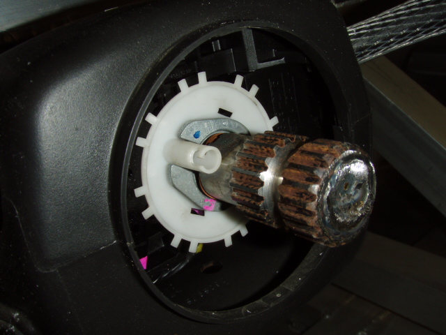

Here's a picture of the steering column in my SLC. Obviously, it's missing the clock spring that Ken clarified in his build log. The spline adpater is definitely welded to the column. My SLC came with the adapter from Sweet Manufacturing.
Dave L

Good information, thanks all. Dave - maybe there was or is some sort of conflict between the welded on spline an the clock spring. This coud be why our cars were shipped without a clock spring.

Hard to tell but that could be the case. Being that my SLC will be a street car I'd kind of like to have the horn button on the steering wheel.
Fran - Will the clock ring fit on the early columns?
