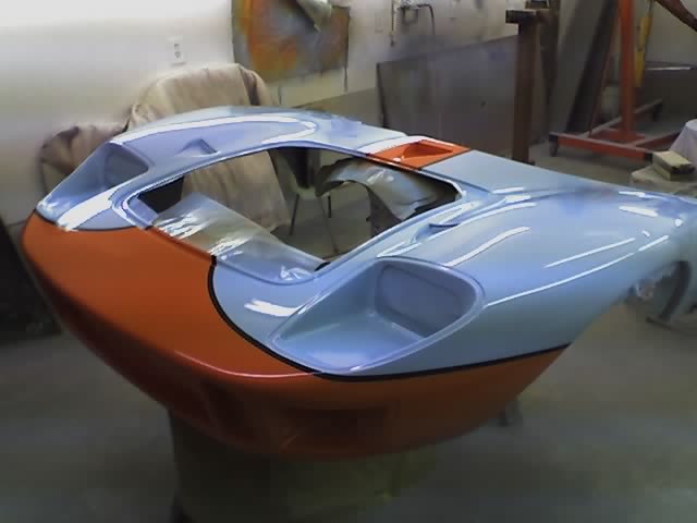

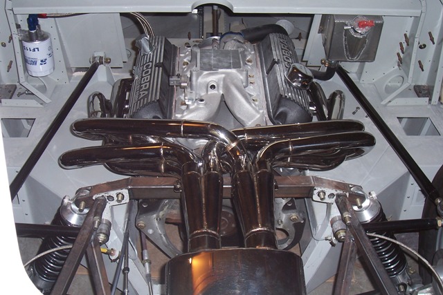

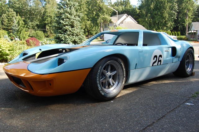

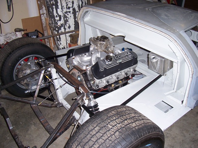

Hi all, I thought I would start a thread on my car. I have been working on it for seven years and am finaly seeing the light at the end of the tunel. I bought a KVA body and built most everything else. I did have to replace the rear body section and ended up using a CAV so there were a few modifications necessary to mate the KVA to the CAV. I am using a roller block 302 with an Audi transaxle.

Steve made the chassis himself...
He works for Boeing and is a very accomplished guy......
He is a really good pal of mine and I have enjoyed sharing his trials and tribulations during his build....

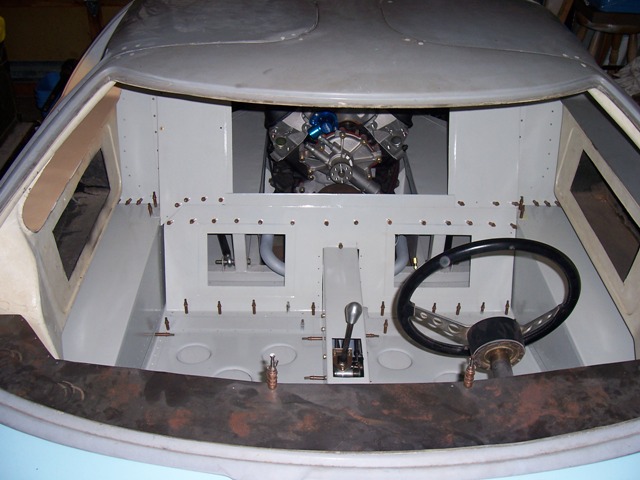

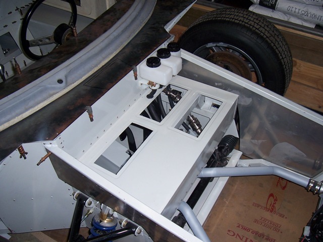

Very, very nice. Question: Why do the originals and some replica chassis have holes in the front upright section behind where the dash attaches?
The real reason ,as I have been reliably informed ... but argued by many is to allow access for the spotwelder....the reach of the tongs on a spot welder is somewhat limited and the flanged holes provide a certain amount of stiffness but it reduces the length required for the spotwelder tongs.
I am sure that some replica chassis add them for asthetic purposes to recreate the original look and feel,
I decided that a "sealed" chassis would be of greater benefit to our customers that want to drive their cars in any weather.

Thanks Bill for your comments. As Fran has said I put the holes in for both stiffness and access both during manufacture and after. I built the frame and all the suspension components including the rear uprights. The front spindles are 2.0" drop Mustang II. I have admired your car for months now, you are doing an absolutely FANTISTIC JOB!! Hope mine turns out nearly as well.

This is a very serious piece of automotive art in progress... Kudos!!!!

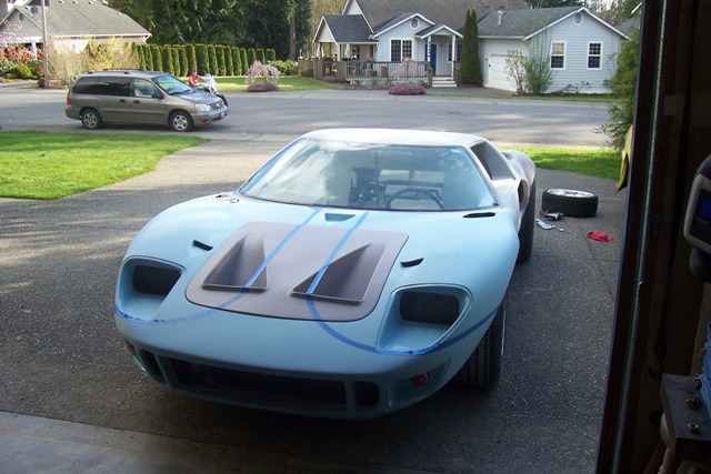

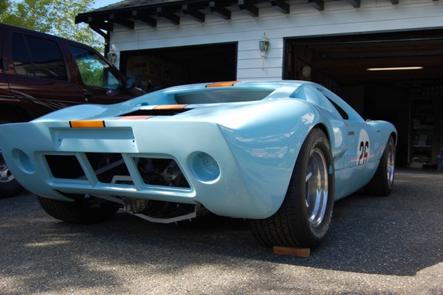

Hi all, have finally had some time to work on the GT again and thought I would give an update. I have finished all the plumbing and am starting the wireing hoping to get done enough to start it in the next few weeks. The dash is in with all the gages, the oil pressure and water temp are hooked up with the rest to follow soon. Take care,
Steve

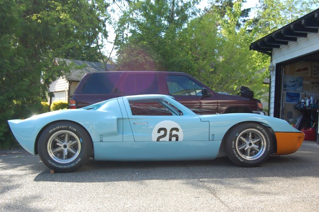

rockonsmile Just a quick update. I finaly finished the list of things required to start my engine and it fired right up!!! It runs like a champ and is very quick revving which is what I trying to do. Now the run is on to finish the wireing and get this puppy on the road.
Steve

Bravo, Steve! Is the proud father passing out cigars by chance?
I can only imagine the feeling when the heart of that beast started to beat. Very much looking forward to seeing your new arrival... before the end of summer, perhaps?
