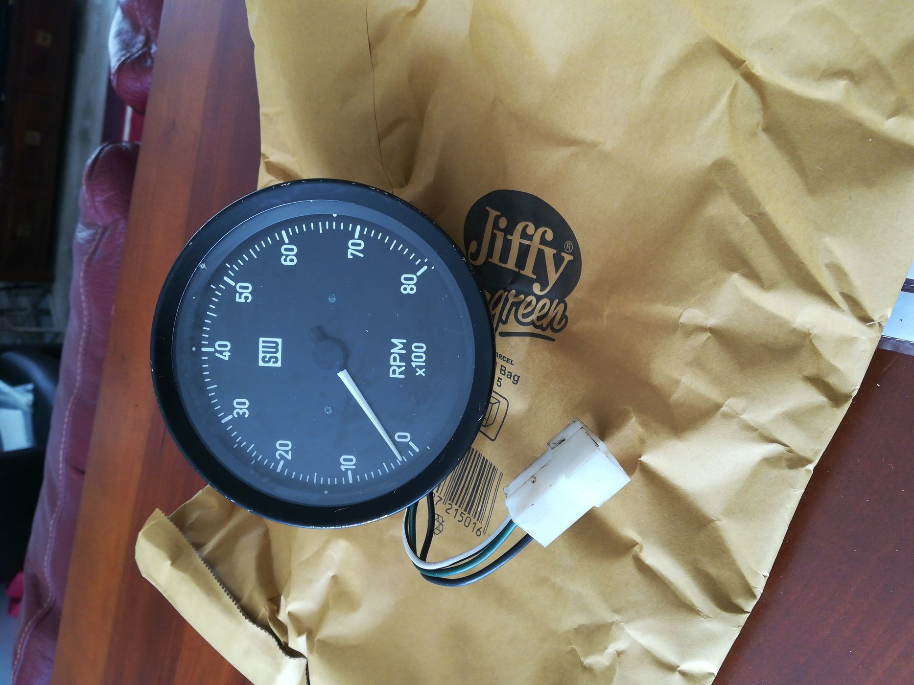

Hi all,
does any of you has the correct wiring diagram for a steward warner rev counter?
i purchased this one from e_bay with the idea that wiring diagram was provide..... i was wrong...
hoping to receive somthing usefull
Paul

My SW tachometer is a different model but the color coded wiring is probably similar: Black=Ground, White= +12V, Green= Trigger In.
Hi Neil,
thanks for the info very usefull
i have actually 1black wire 1 white with black stripe and 1 green and i supose that this is same as yours!
is this an direct connection to the ignition coil ? or is an ignition box needed?
Paul

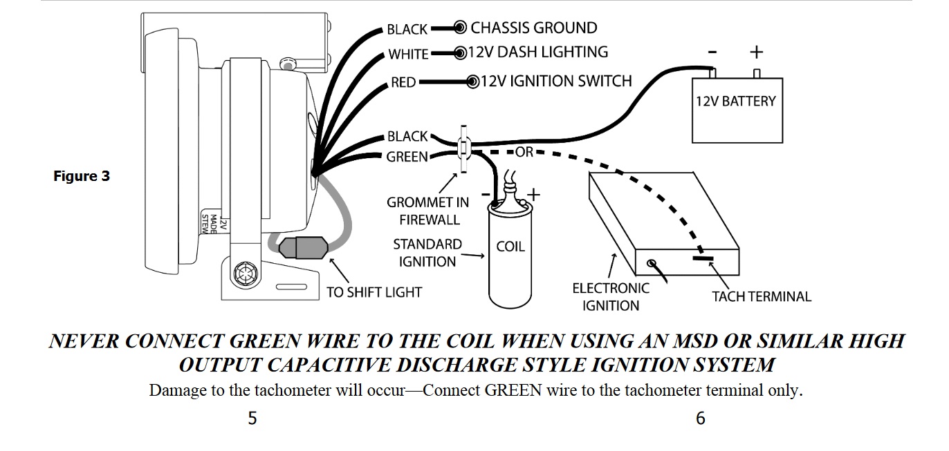

Neil
Paul;
I will attach an illustration from my SW tachometer installation manual. It shows that the green wire can connect to a coil or to the output of an ignition box. Mine is driven by a Crane HI-6 ignition.
