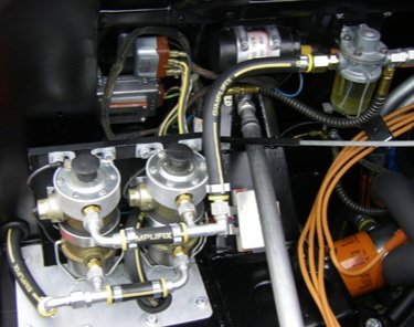

Some of the original cars had the fuel dump just after the Fispa filter. You can install an AN fitting 'T' in line. Obviously the drain is a smaller diameter 'restriction' fuel line heading back to the tank as JP and Frank mentioned. As long as you still have approx 3psi at your carbs when running,...when you kill the pumps the residual pressure will drain off.
