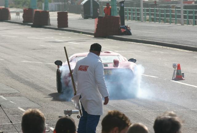

We run a Fontana Alloy 302 bored/stroked to 347 in Roys Mk1 GTD. We use a Renault box with DB Quaife conversion + ATB.
To date the transmission /drive-train has stood up to numerous lively starts - esp on 11" wide slicks and often starting in second gear.
The sprung clutch centre (AP) did finally give up its grip on life as Roy drove home from the club AGM earlier this month (leadfoot!). A replacement 'all solid' item has now been fitted and will be tested at Goodwood next month.
We have never 'dumped' the clutch - the easiest way to spin up is to engage the clutch and once rolling press the loud pedal - no problem. /ubbthreads/images/graemlins/grin.gif
