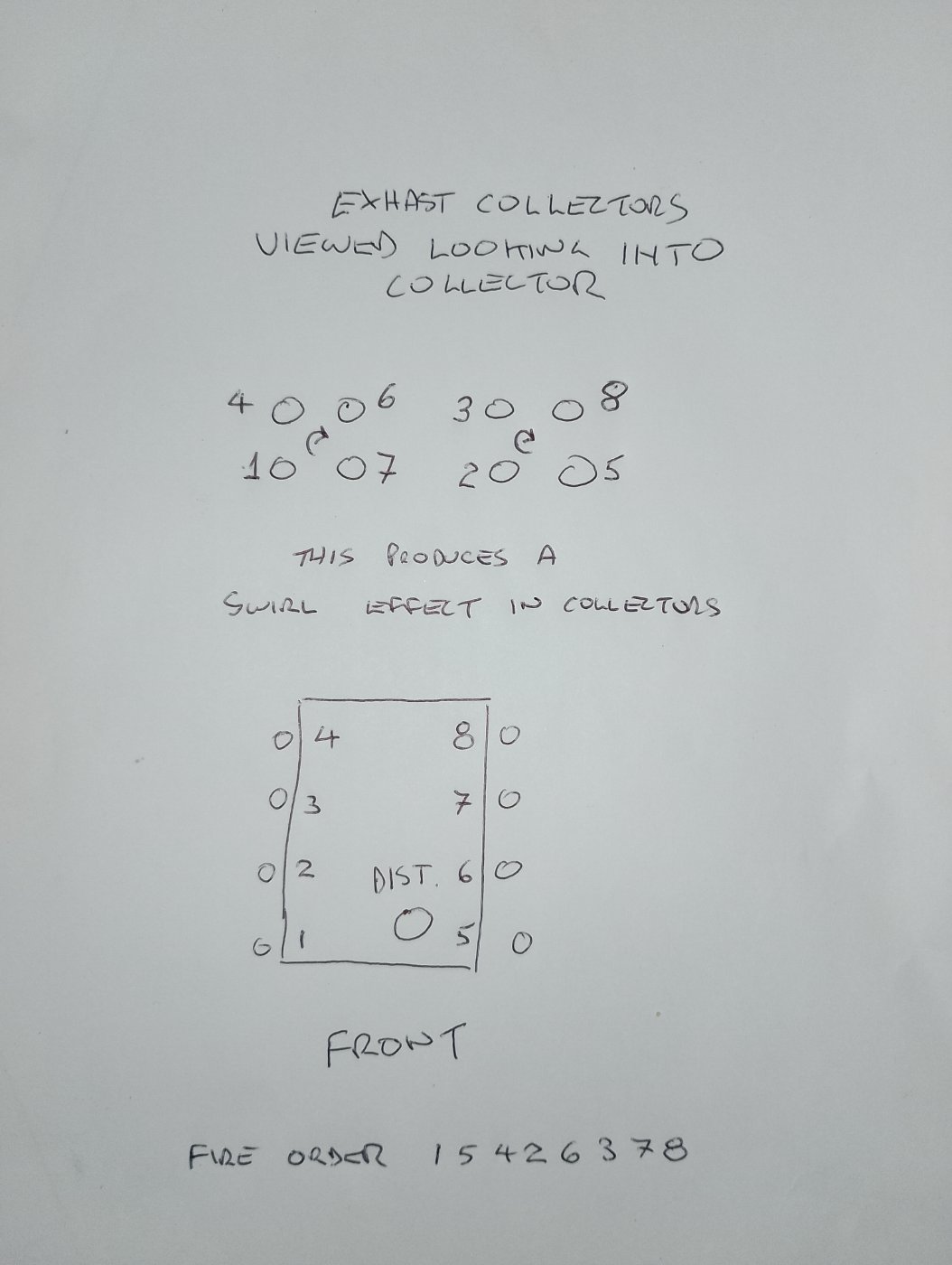

Depending on your build , what is shown in post 123 could be an issue. The stock firing order for 289 and 302 is 15426378
ok, here is what i have :
hope this clears up any miss-understanding from my previous post..

you may be coorect and probably are..
However what i have seems to work ?

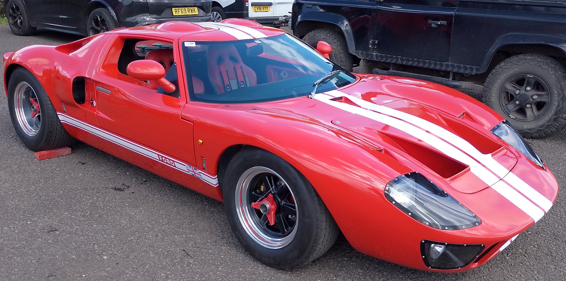

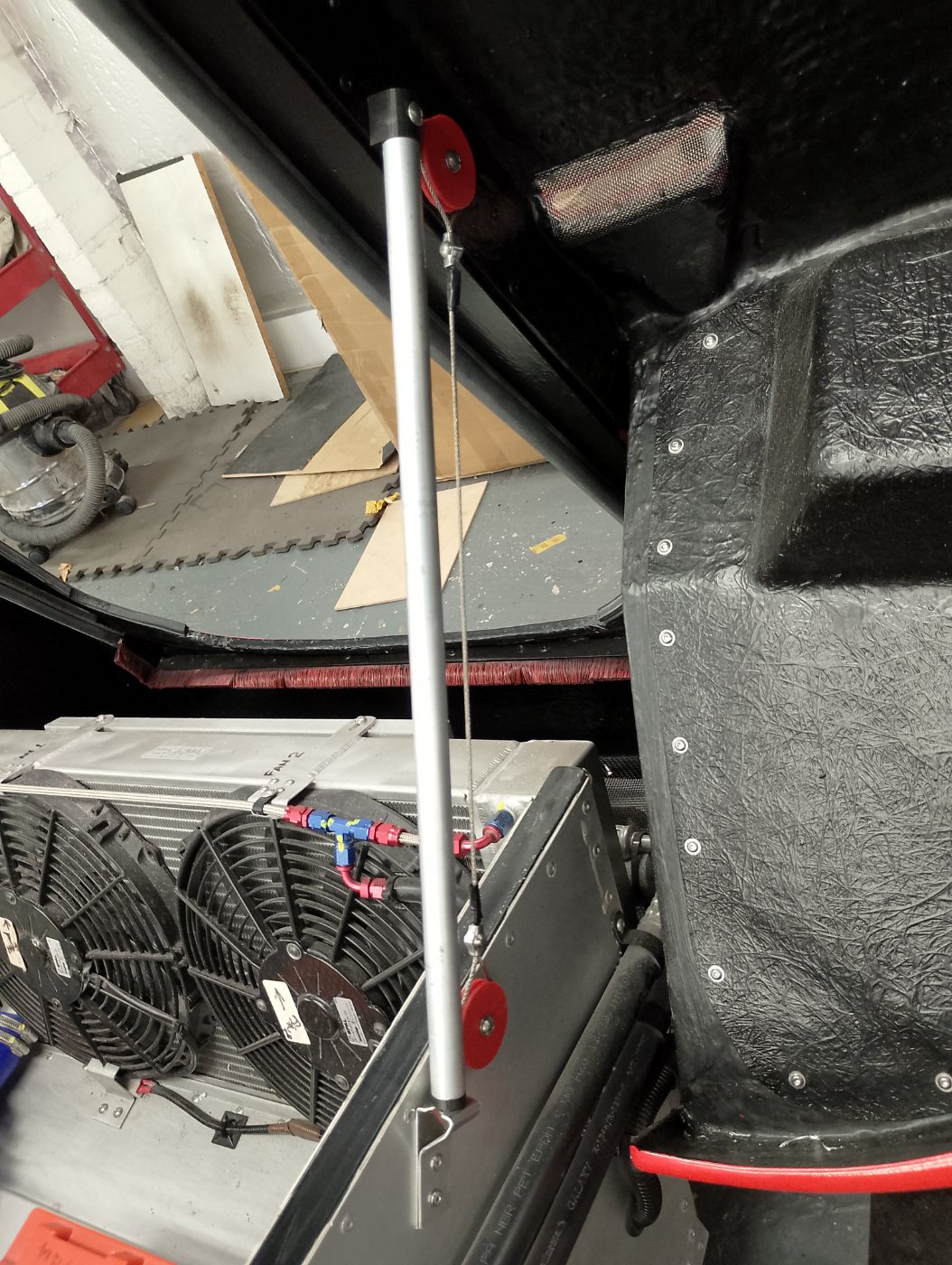

Its been a while since i did an update ...so here goes..
All work now completed..yipeee ( that is to present for the IVA )

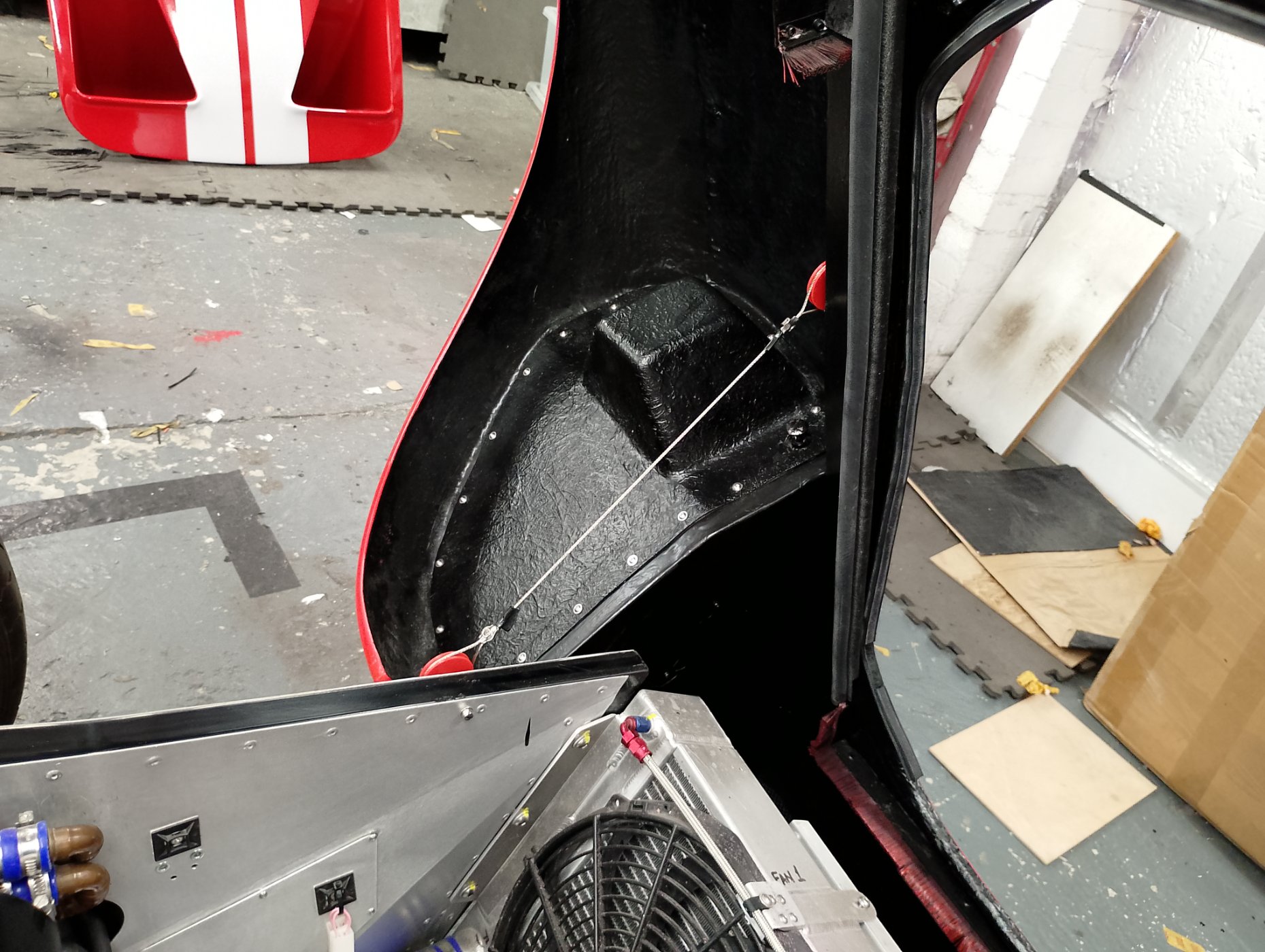

stripe added, front and rear clam stays added
mesh over rad fitted
tow points added
Fitted a couple fans to the oil rad as it seemed to be getting hot on tickover.. now stays steady at about 90 cent

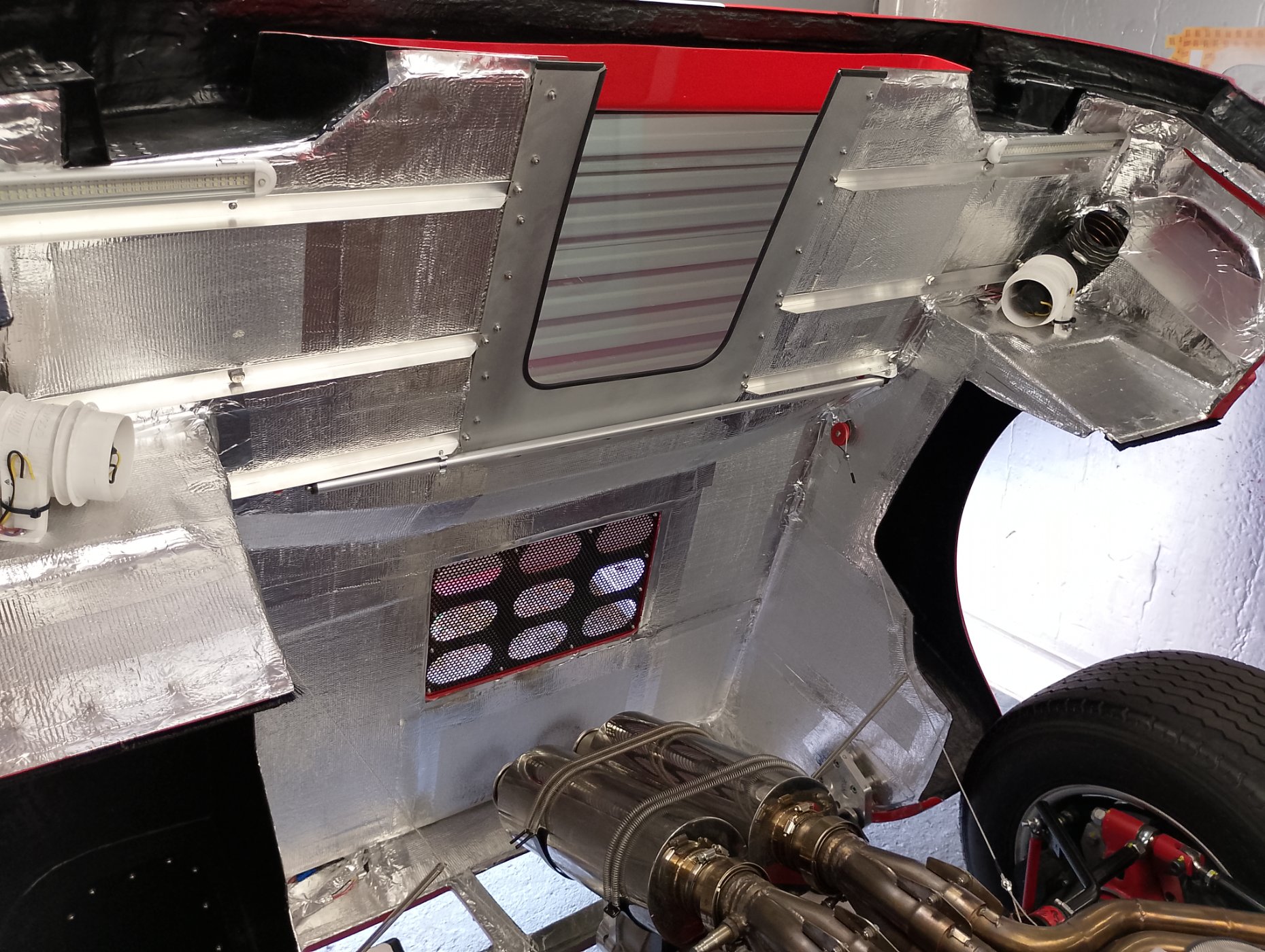

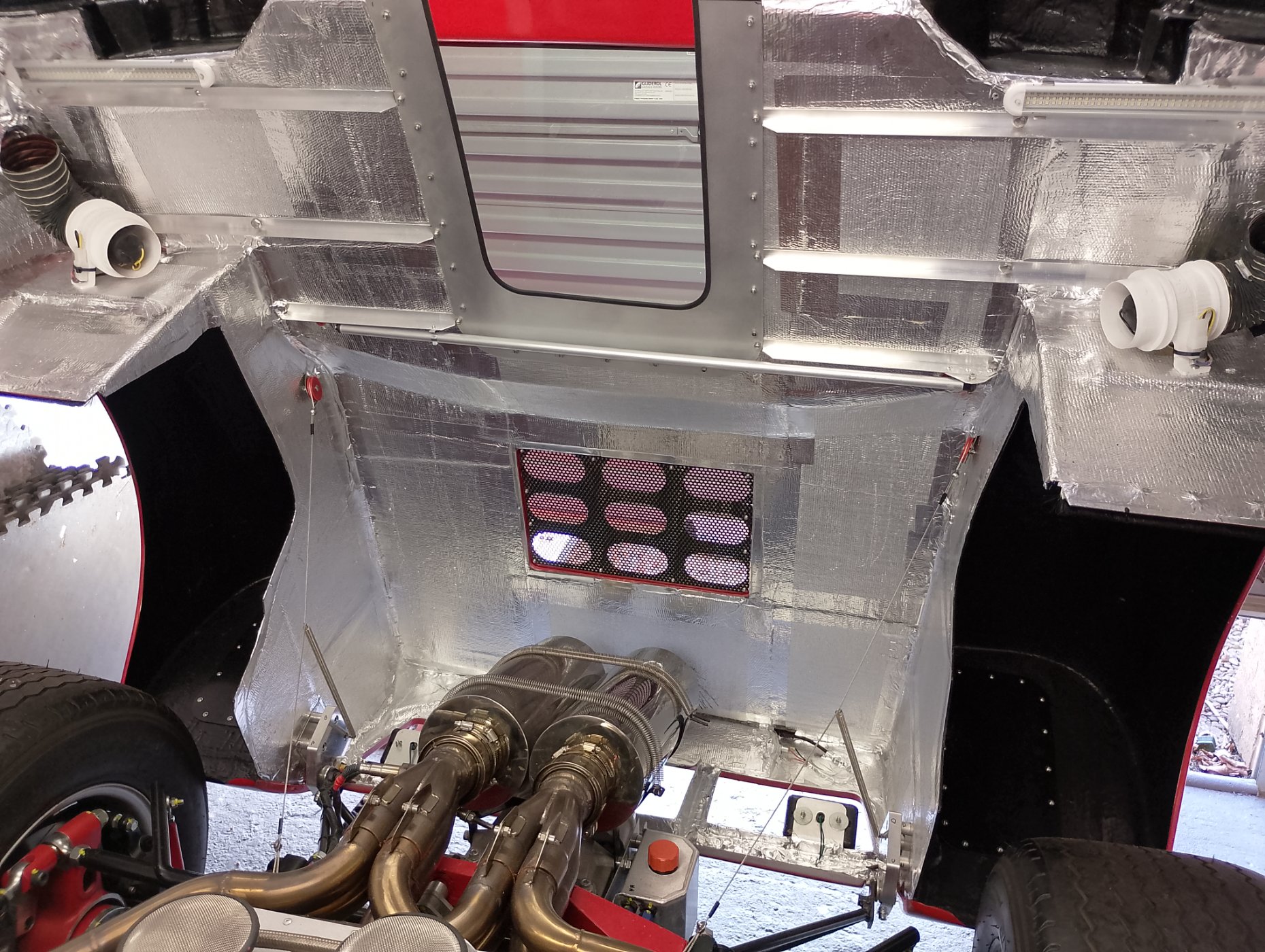

'tin foiled' the whole of the rear clam.
'tin foiled' the 2 cooling fans ( boat bilge air fans ) that blow over the exhaust and engine.( melted one so it does get hot in here. )

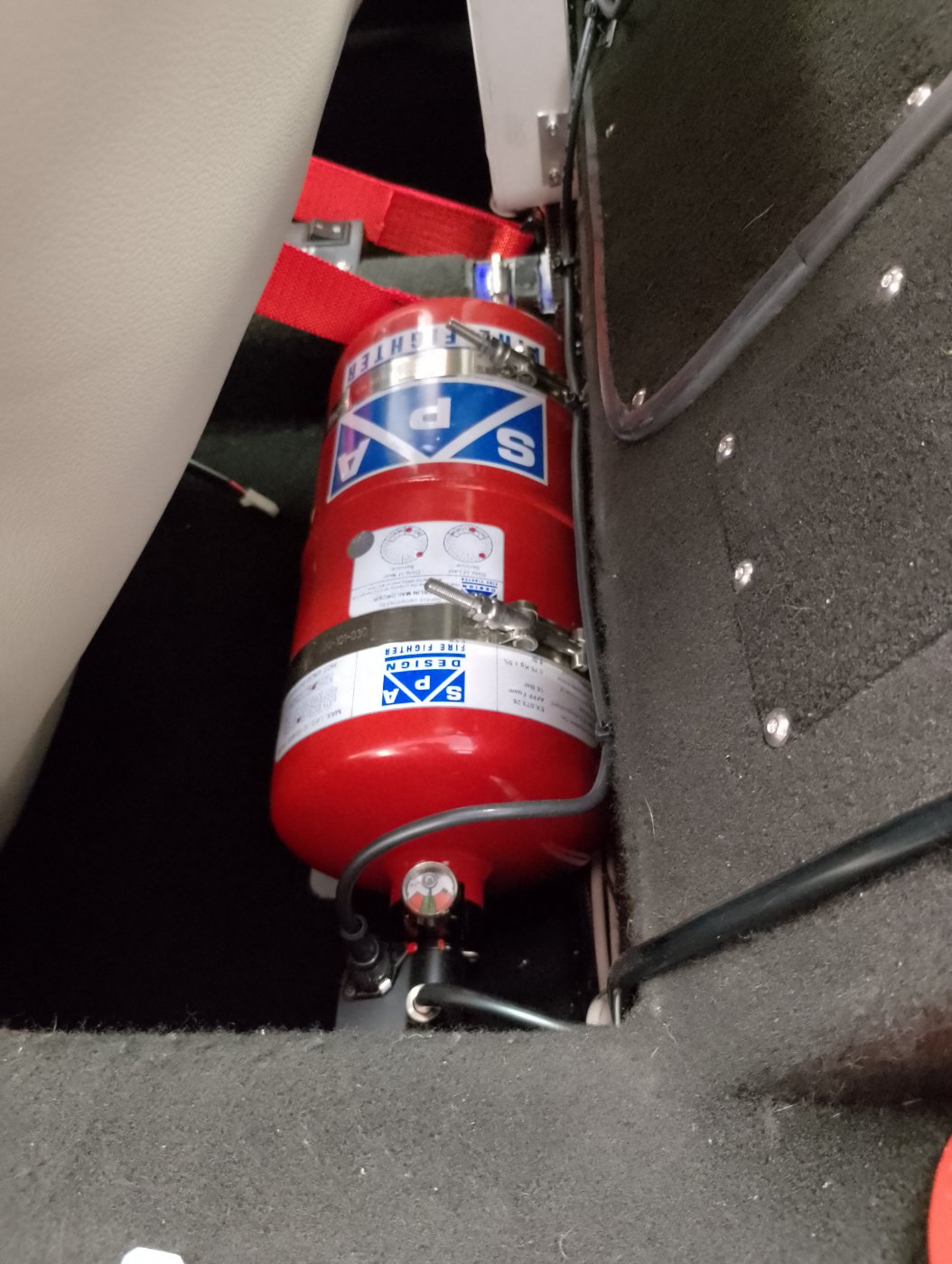

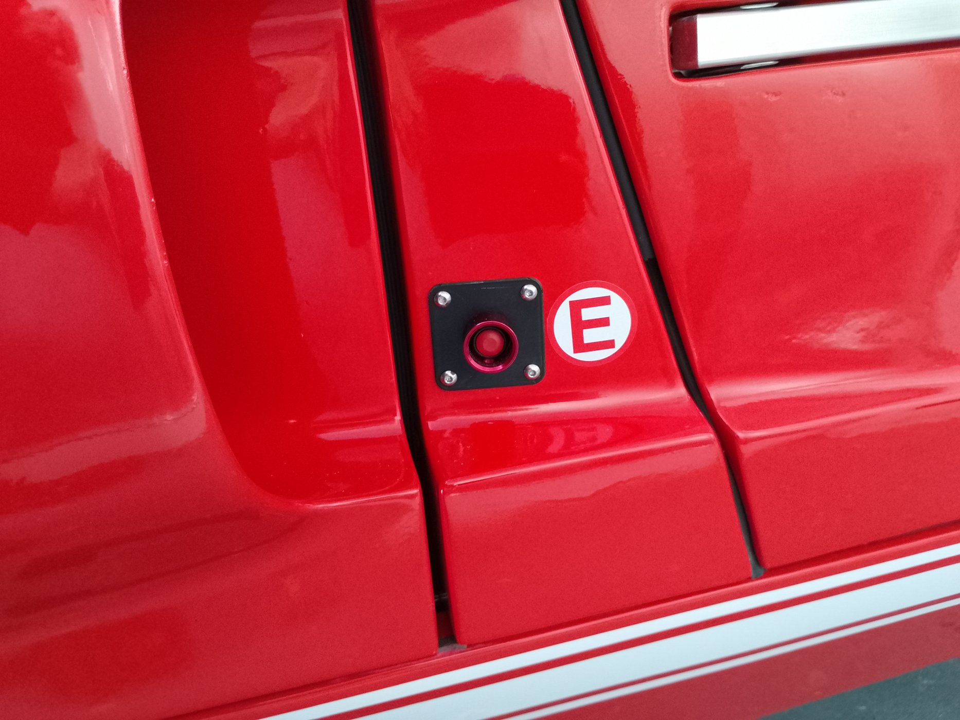

fitted an FIA Plumbed in fire suppression ( electric operation using own internal battery, much easier to connect up than wire pull cables )
If used for racing the it requires 3 outlets to engine and 2 to cockpit.
I have decided to run all 5 to the engine.
using my short driveway i tested out the brakes to make sure i could get a lock up..not possible so assumed needed to be bedded in
Took it to local race track for a shakedown.... driving around paddock the brakes were total crap !!! but it did stop it ..
out on to track.. had to run with some extra rear mufflers to get below the 100 dB limit , also engine still not run in so no silly revs to be used ( limit it to 4k )
car runs in straight line, turns in to corner nicely, steering self centres and is not heavy....brakes are 'interesting' after a few laps they are still not stopping the car ...... investigate later....
engine runs nice and smooth and at 80 c
manage to get it wound up a bit on the straight and just touch 130 mph....
Ok , thats enough... lets bring it home....
car at home.... oil showing around the gearbox breather so have now put breather pipe on and routed to catch tank
major brake issue to sort out....
ended up changing the master cylinders from .75 to .625.. that improved it but was still unable to lock up wheels on my drive way.
changed out the pads to Green stuff green pads... wow... that worked....can now lock up all 4 wheels .
maybe that was all that was required was to change to a different pad ? ..
The pedal is a bit 'softer' and travels a bit more distance but this is expected with smaller master cylinders.

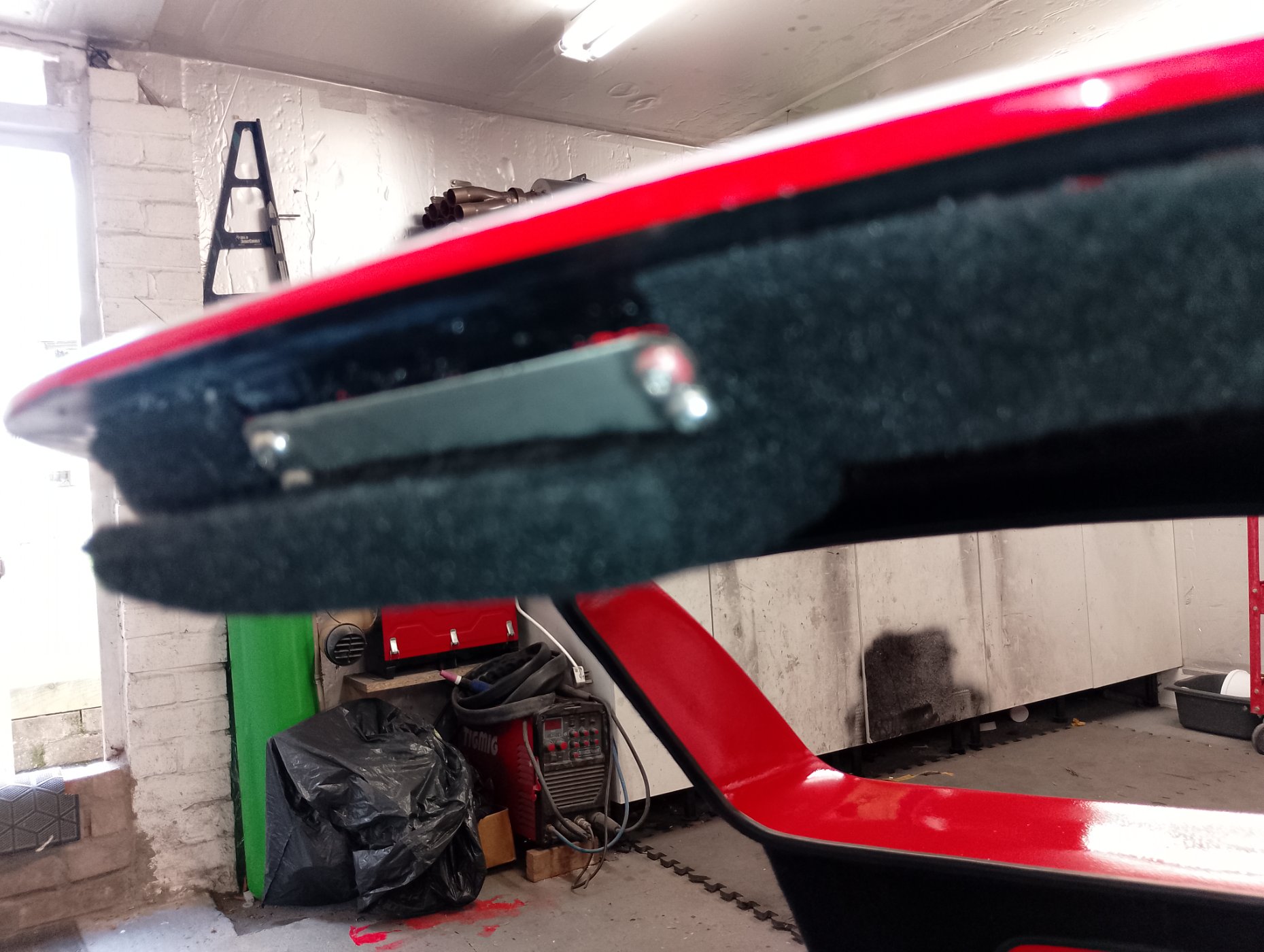

foam covered the internal plate that holds the roof down as kept hitting helmet on it.
Thats about it...
next milestone is the IVA.....
I'll update when that part is over...
some pictures attached..

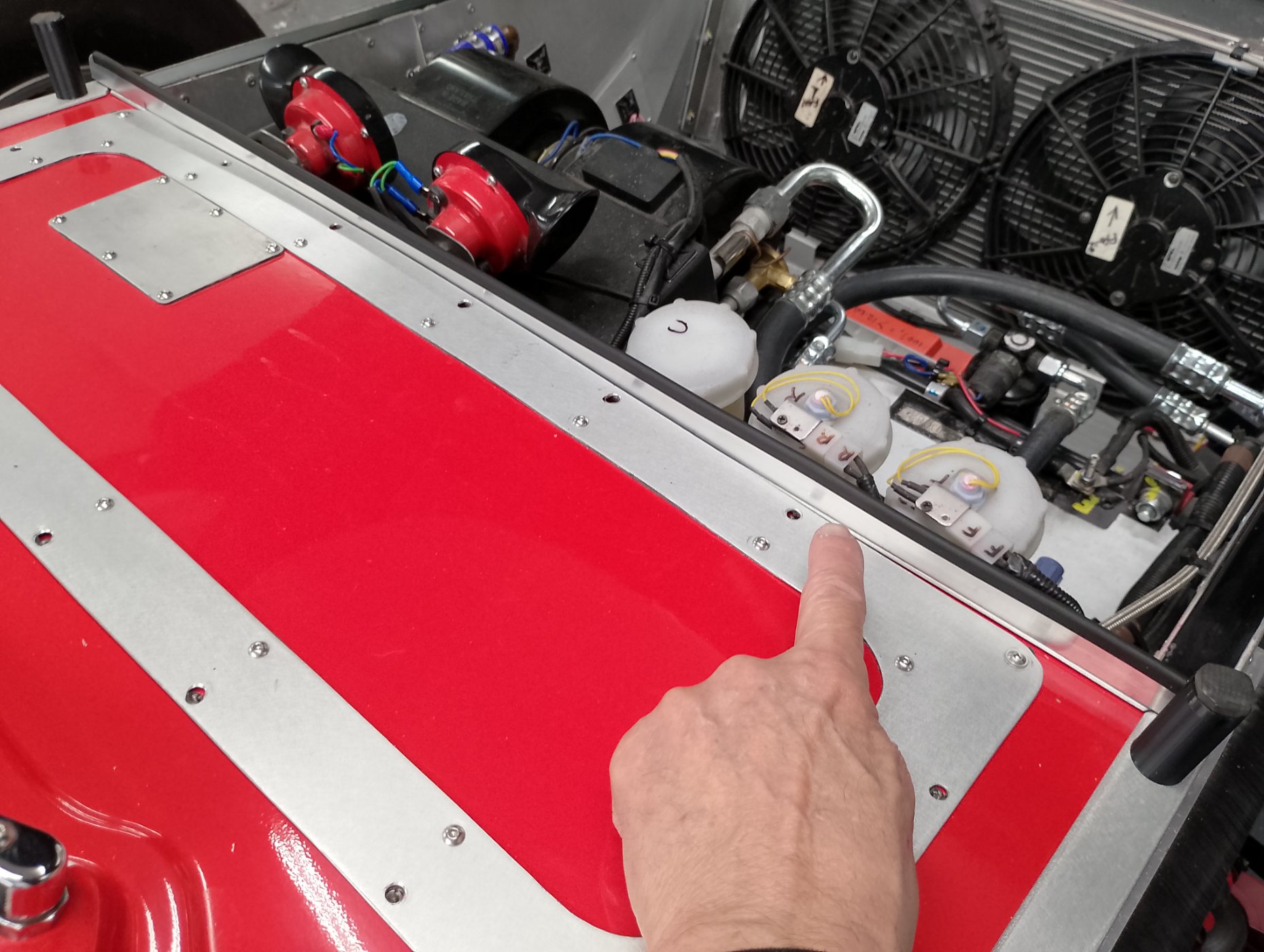

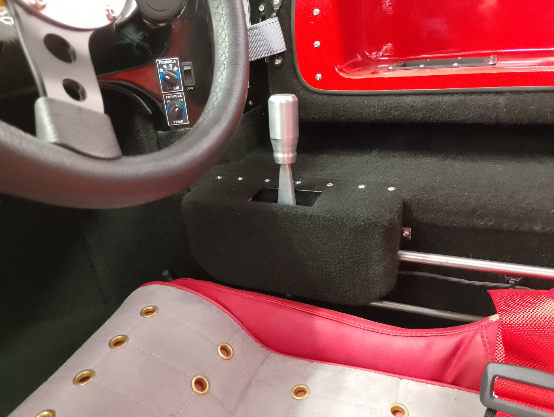

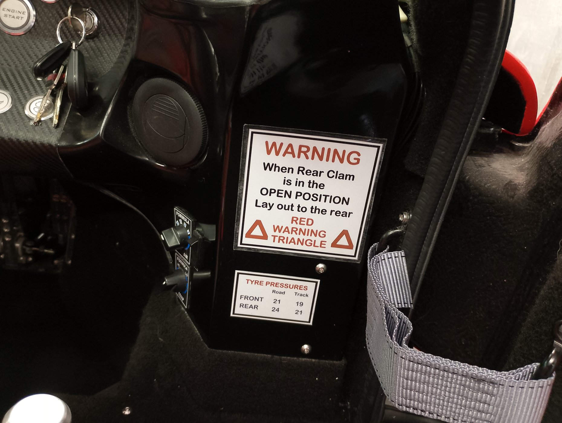

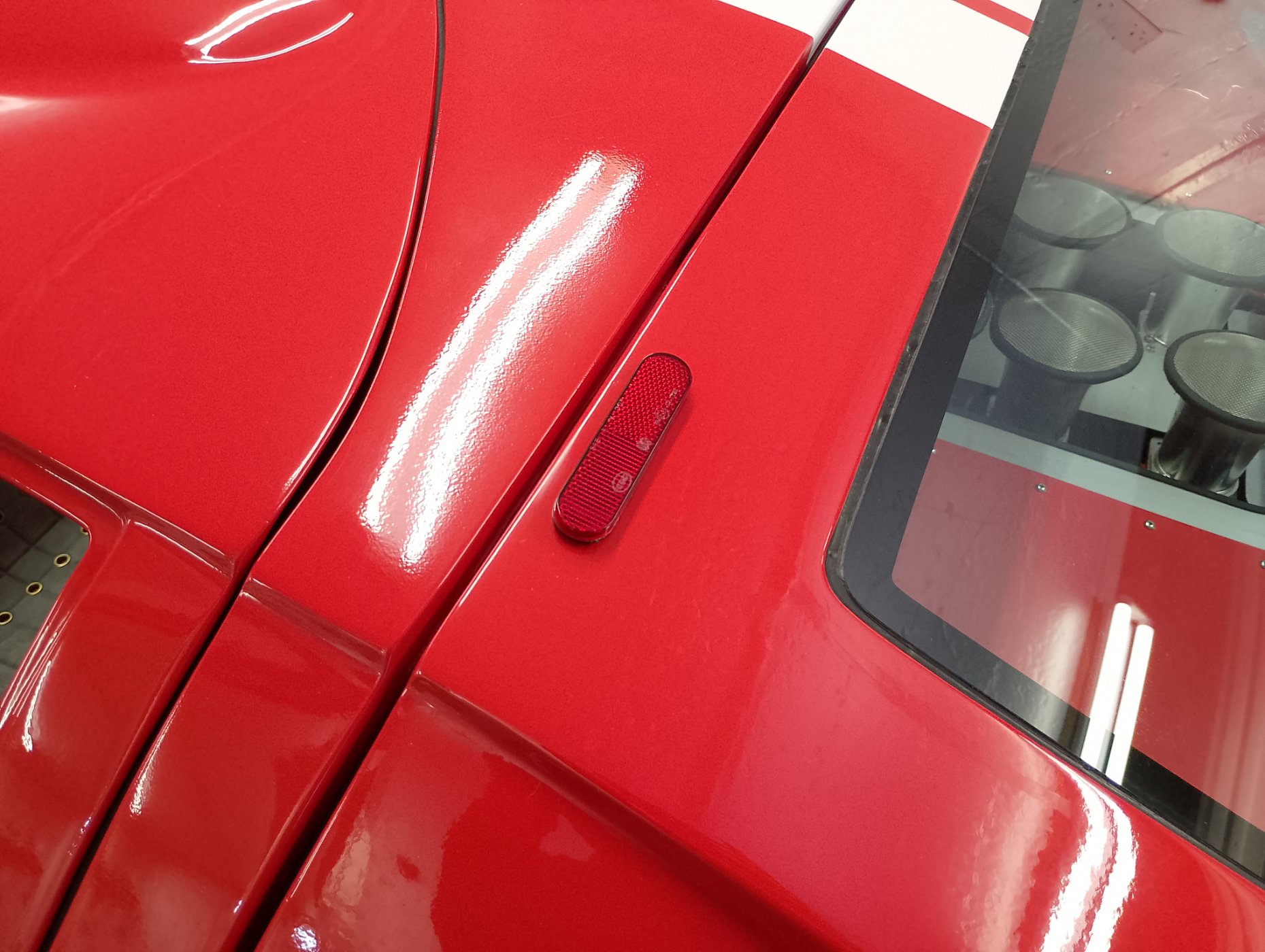

I've just had a look through your photo's and here's a couple of observations. I presume you're borrowing a set of large (radiused) wheel nuts. The use of spinners used to be a Fail. I can't see clearly from the photo but have you fitted the required labels for master cylinders and bias bar.

Yes...nuts will be fitted instead of spinners ( borrowed from AK )
Labels fitted at bias bar and at resivoirs and bias locked and pinned.

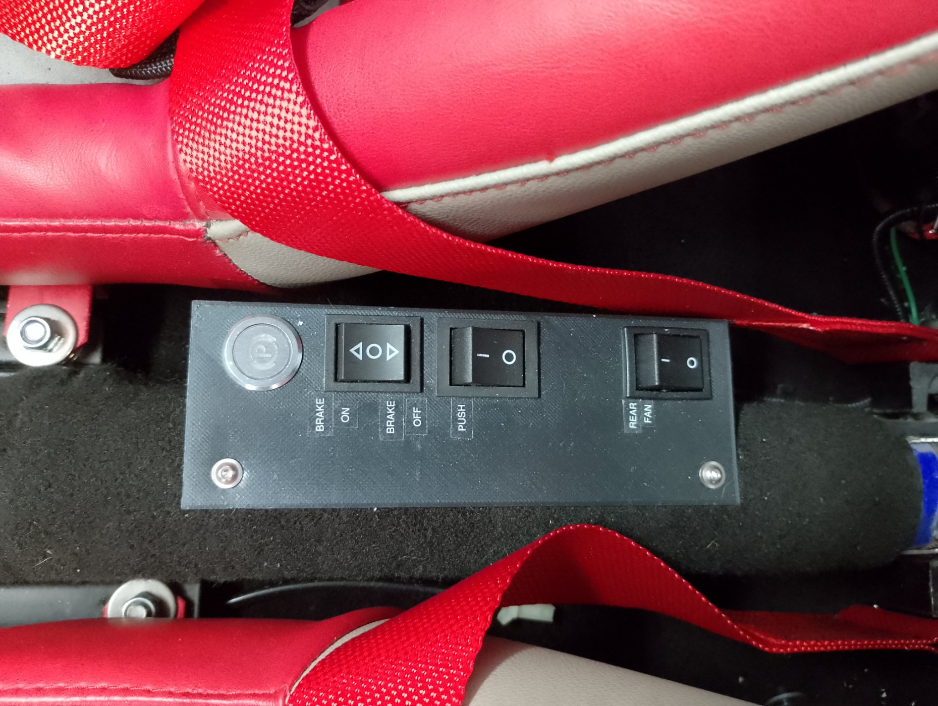

park brake is electric to my own design using audi Q6 calipers.. when applied it stalls the engine if i try to pull away !

I have finished the electronics and I rely on time rather than current reading.
If interested I can forward to you my circuit diag.
it uses two timers ( one for on time and one for off time ), 2 resistors ( to limit on current ) and numerous relays...
also incorporates requirement of IVA...

To pass IVA and get a registration number and legally drive on the road all 'screens' must meet a standard and be marked accordingly.
As side windows are of perspex material they are not compatible with standards.
Therefore car is presented for IVA with no side windows fitted and NO PROVISION for them to be fitted.
it is NOT a requirement of IVA to have side windows.
