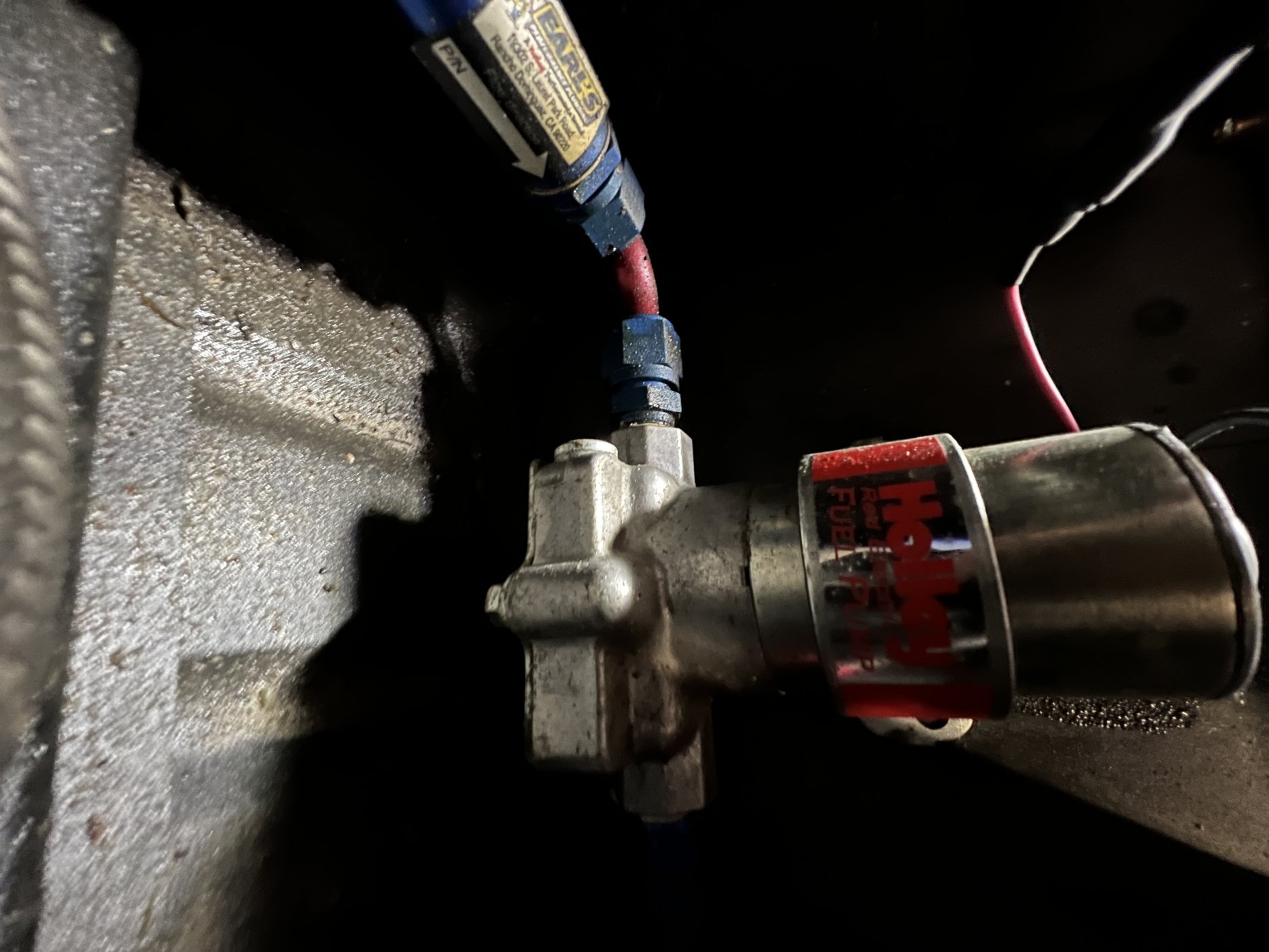

So I have a Holley red pump. Is it normal for it to run continuously?
Also it is noisy as hell, the noise goes right through to the cabin. I can see that it is bolted directly to the rear wall of the sponsoon. Thinking about adding some rubber insulators to dampen the noise or should I build a « container » from EPDM foam to separate the rear part of tge sponsoon off and dampen the noise?
Also it is noisy as hell, the noise goes right through to the cabin.....
Yess & Yess.
Holley Red is a superb & durable fuel pump that delivers a great amound of GPH.
They run continuously and are very noisy.
Nothing to do about that beeing noisy, but when your engine fires up usualy you'll only hear exhaust rumble.
Well I was more worried about the pump running continiously. But now that I know that that‘s normal, I‘ll just put it on rubber mounts to get rid of the annoying whine, that I hear even when the engine is idling (not of course on wide open throttle). It‘s a $5 invest for a couple of rubber mounts, so it‘s not gonna bankrupt me ;-)
