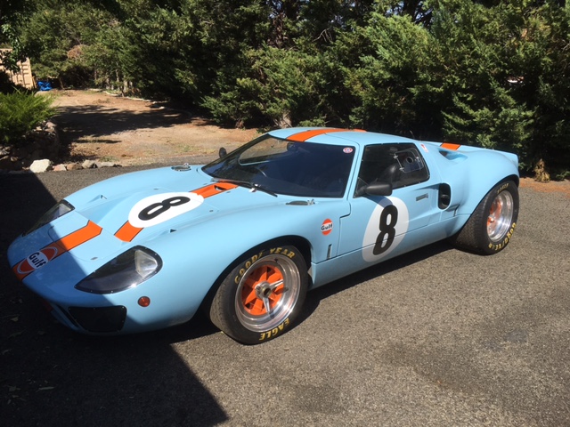

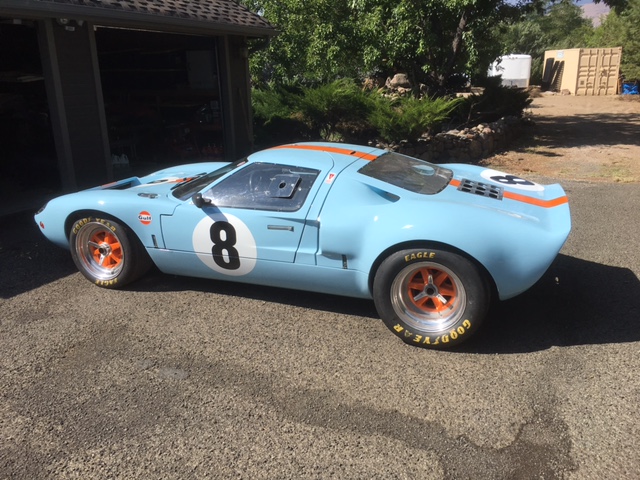

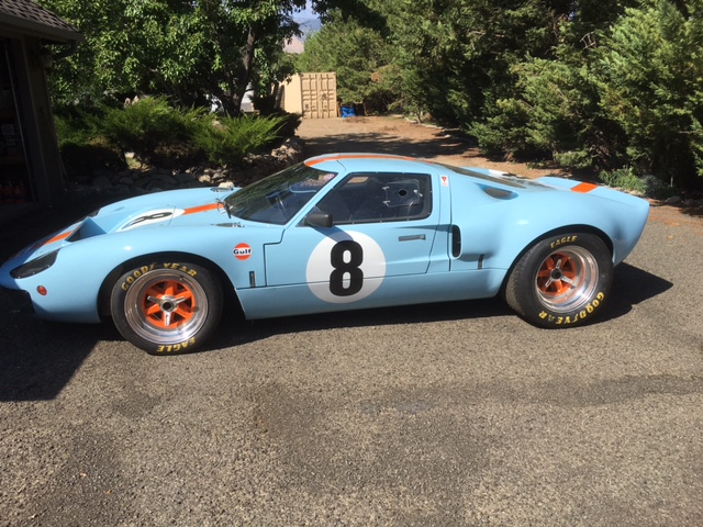

I am running Goodyear Eagle 27.0x14x16 on my ERA wide body and can get a photo that will show what the car sits like with a 27" dia. tire.

Thanks Julian. I spoke with Roger Kraus Racing last week, but will be sourcing them through BMTR in the UK. A side shot of your ERA would be great. What size fronts are you running?

Fronts are 23.5x10.5x16
Julian
Thanks Julian. I bet there aren't too many GT40s running 16" wheels. Looks solid!
It's an ERA anomaly, they are 15" centers mated to 16" hoops. I actually had a set of 15" custom fabricated by Vintage Wheels thinking 16" tires would be impossible to come by, turned out by a stroke of luck they were easier to find than 15"!
