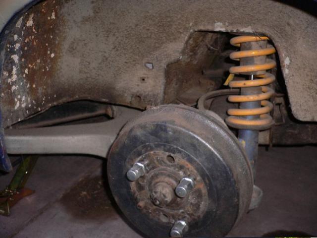

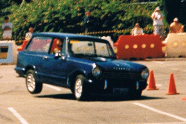

One area that needs to be seriously re-thought is the rear end. The results of an un-modified rear axle in competition can be frightening...

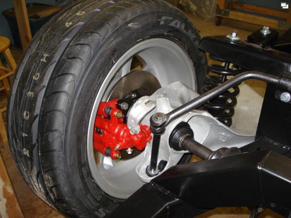

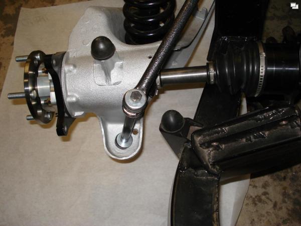

A slightly narrowed Triumph saloon rear K Frame works really well. Just change the diff centre for an appropriate LSD unit. I went for the 3.7:1 Nissan R180 diff. My next move on this car is to change out the drums for a rotor set up. The R31 Skyline discs are used for this, with an adapter for the calliper (see last 2 pics).

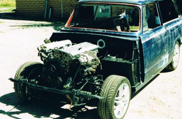

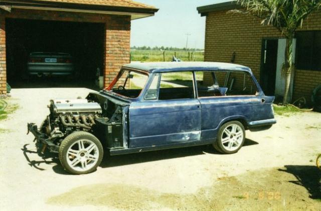

Here are a few shots of the car, by the way.

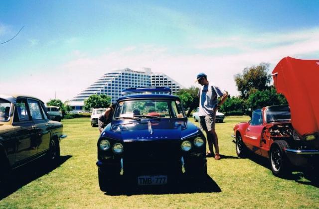

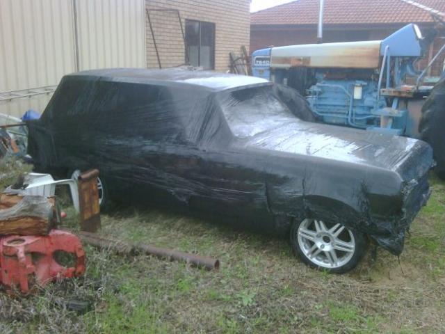

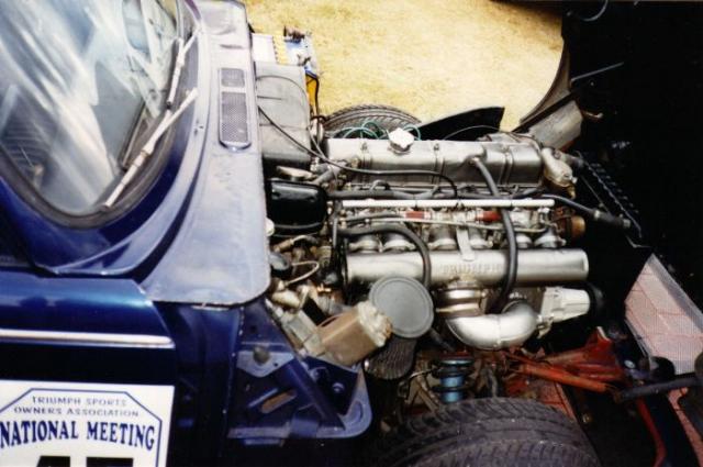

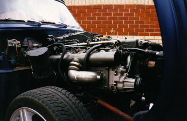

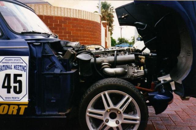

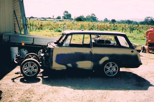

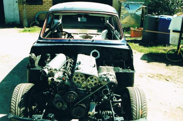

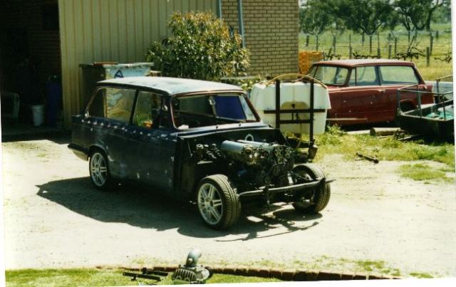

The TR motor eventually made way (after a couple of other engine test fits) for a Nissan RB25DE with the same Eaton twin screw supercharger. Coupled to a VL Turbo 5 speed, this combo proved too heavy and unbalanced the car. Even with that amount of HP at the wheels, it just didn't get the power down properly.
I fab'd the plenum to fit under the bonnet, and to make the intercooler plumbing much easier - aka GTR Skyline!
The RB25 / supercharger / trans were sold off, and the car now awaits the completion of the GT40 for it's turn in the spot light. The second last pic was of the car last year, and the last one is how she sits right now. :cry: (will be under cover soon)
The boss wants it back to TR 2.5 spec (maybe it's the induction sound of that mechanical injection she likes - I won't put efi on this again!). But I kind of like power delivery of the LS3 6.2ltr engine...

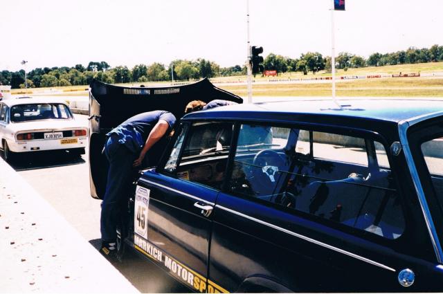

Yes the under side of a Triumph bonnet is a very familiar sight. Had the output shaft pop out of the diff on Saturday in the car park for heavens sake. The sooner I get the rear sorted with some CV's rather than UJ's the better.
Using the saloon rear arms with a strut (what strut did you use by the way?), the arm takes the load okay? Looked at doing the same with my RB25 powered 2.5 saloon, by thought the casting would break with the extra load.
Quiet keen to use the same set up. Do you have any under body shots you could post? If I start cutting I want to make sure I've got it right, and that I have all the requried parts.
The rear brake holders look familiar too, I have the CAD and Solidworks files for these from a guy in Canada who did the same on his TR6. Got some samples water cut and they fit perfectly. Let me know if you need the files.

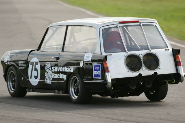

Here's my old Silverback, now no more, alas.

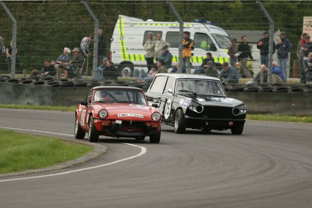

And just to prove that you CAN sort the Triumph rear suspension, here we are at Castle Combe, Quarry Corner, a very fast 270 degree. First I am shaping to pass my opponent on the inside, then on the exit at the next lap and finally a rear shot as we straighten out. Almost no lean, no inner wheel jacking, well sorted, though I say so myself.
That was with a Courier spring (van version, very stiff), spring raised 25mm, Quaife LSD.
John
Oh, the jet exhausts at the back? Rear radiator - secret weapon! J.

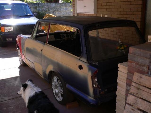

John, your estate had a composite roof and tailgate if I remember correctly. Do you have the molds still, and the bigger question is, what happened to the car?
Do you also know where to source FRP Vitesse bonnets? I don't think Honeybourne do them...

Upper cylinder lubricant! Yep, a bit of that. I didn't bother re-building the supercharged engine that was in it. At $300 for another 2.5PI engine, it was just quicker to slip in a (supposedly) fresh one. Happily, I have a new set of rings and gaskets to fit before too long :)
