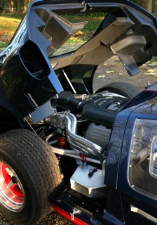

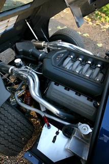

It has been done.......Nigel Hulme, the UK Superformance agent has organized the installation of a new Ford 5.0 "Coyote" V8 into the Superformance (original type) chassis. And a nice job it is!
This is now available as a factory supported option.
Thank you Nigel for boldly going where no man has gone before (Hey, that sounds familiar...?)
A very nice installation.

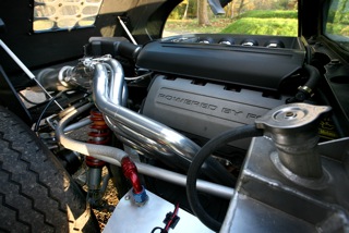

A ZF. The ZF/ZFQ are the only supported transaxles in a Superformance. While there is a car with a six-speed Ricardo, it was done by the owner without parts/engineering from SPF.
Note that the intake system on the 5.0 has been turned 180 degrees to eliminate the throttle body interference with the bulkhead.
All in all a nice, clean job. Also note that the exhaust is not 180 degree and now exit via the vents on either side of the original exhaust opening.
