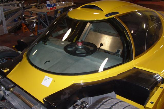

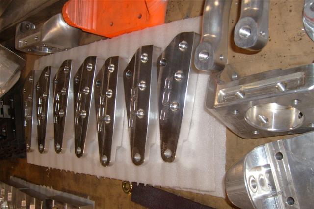

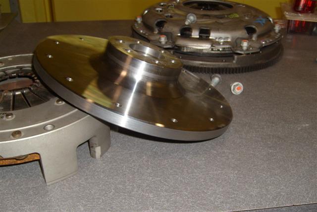

A couple of shots of some new componentry and some new parts that are on the production Superlites....
The new DOT windshields are now heated as standard..

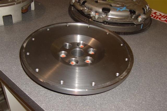

Also the new in house flywheel for the LS7-Ford GT Ricardo conversion...

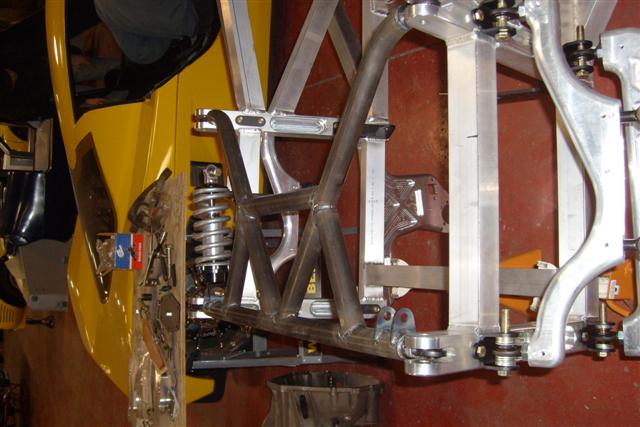

New rear shock location and geometry...again a development for the LS/GT package...

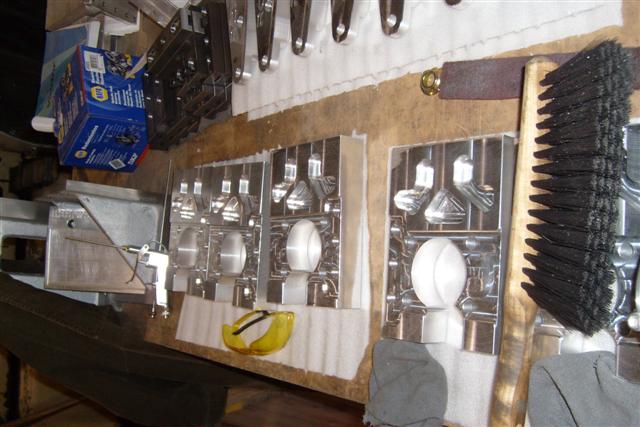

New front and rear uprights..... with a very trick easy adjust/race setup adjustment that allows suspension changes that dont impact Camber/caster/toe etc allowing independent changes....
I am also testing a new speed sensitve fully electric standalone power steering package....for the endurance race guys looking to run the SL-C in competition.
I really am aiming to make this car a serious contender with a long term future .....it was a serious piece of kit when we unveiled it at the end of May...but customer input and their Supercar performance drivetrains have spurred me to continue development at a rapid pace...even by RCR standards......but I am so excited by this car I need to wear "depends" while working/enjoying it.......

If I had seen that pic from above, I may have gone modern also. That thing just looks fantastic. At least I get one of those flywheels, eh? I cannot wait to see it in person.

Hi Fran,
One of my pet peeves is Rod Ends loaded in bending, looking at the damper mounting frame the Rod Ends on it look as though they are exclusively loaded in bending?
Obviously there's going to be virtually no movement in the joint in operation, would you say that affects the applicability of the type of part?
I guess you must be using the parts based upon a reasoned argument, I'd love to know what it is, if only to modify my paranoia on the subject.
Your worries are unfounded for the application.....so long as your parts are sized correctly and used as part of a system ..not just a singular component...which the ones shown above are...
The 5/8 shank of each rod end will accept at least 30000lbs of shear loading prior to failure....
The spherical bearing is fully captured in the event of the above mentioned failure....(but if you have a failure like that I would be pretty certain the brain failed first and you had already impacted something)
The total loading is spread across the DOM steel structure that is 1 1/2 OD DOM tubing ...similar to roll cage tubing....so with that said we have a pretty high level of redundancy...and "overbuiltness"........;)...(FEA proven)
Nnow get off the paranoia armchair and get back to work on your car....and post some pictures for all the other budding builders....

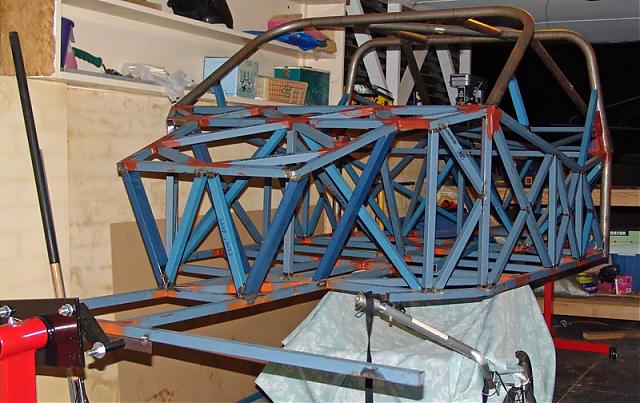

Here's the current state of play, the frame is nearly finished in terms of main structural members, each week I only ever seem to get 1/2 the number of tubes in there required to finish the job.
Its not quite the Hall Industrial Megaplex ;) but a hacksaw, a big bastard file and few measuring devices have done most of the job.

Doug,
Is all that trussing necessary? That frame seems really stout! How does your frame compare weight wise with other frames of similar application?
Thanks for posting the picture.
BT
Bill,
A good part of this exercise from my point of view was to do the whole thing "my way" for what I've thought were the important first principles.
For me torsional stiffness (I worked to a goal of 10,000lb/deg in the model) and occupant protection were the primary goals and I spent a lot (probably too much) of time working on structural analysis to achieve these goals (I hope). The computer model shows the completed frame coming in at 127kg (the last time I weighed it, it was about 10% less than what the model said it should have been) , the completed car I expect to way about 950kg.
