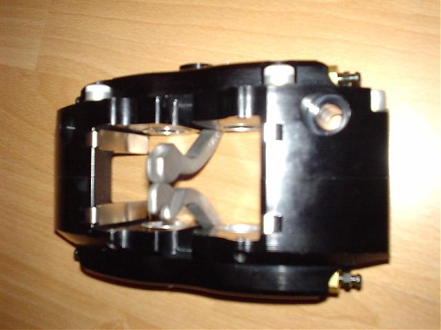

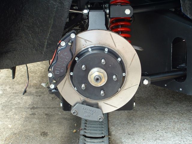

Even better, they are less than that if you just need the calipers. I'm about to order a set for my car since it has no parking brakes and I'd rather it did. Here's the link and a pic:
http://www.ipsco.org/Custom Services/Parking Brake.htm
BTW, Congratulations on the promotion Lt Col Mike.
Yup, them's the ones! (And thanks for the kudos, Mark!)
Note that they are manufactured in two halves, and are designed to take a spacer depending upon the thickness of your rotor. So when ordering be sure to have a very accurate measurement (to the thousandth) of your rotors. The total movement that the active piston offers isn't that great, so if the caliper is just a bit too wide, the brake won't work well, and if it's too narrow, it won't release.
I've installed two sets on Panteras; on one of them the guy measured his rotor with a ruler instead of a dial caliper, and as a result I had to remove the pads and file them to get it to fit....

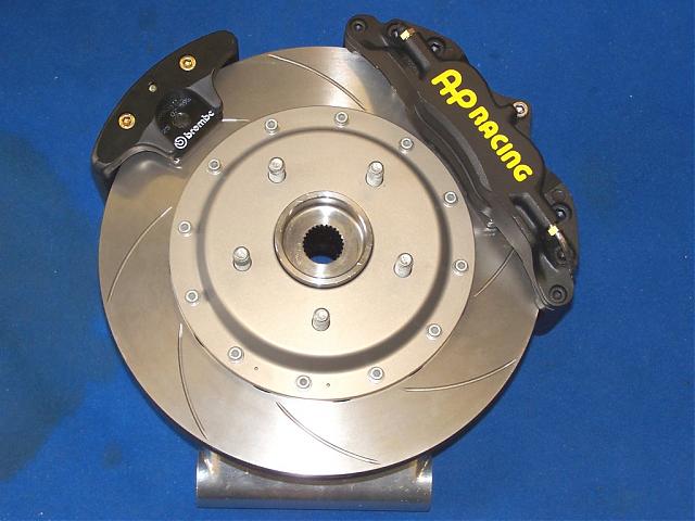

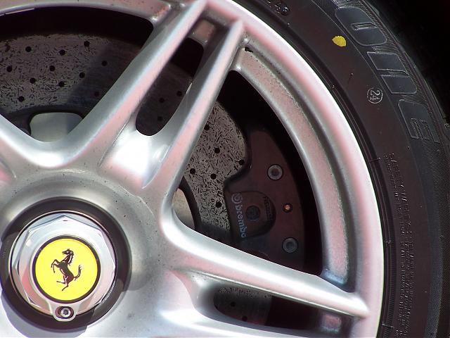

Given that SVA in the UK does a rolling road test on the "handbrake" (actually a mechanicaly applied independant brake test in SVA speak) I have elected to go for the (proven) Brembo option (used on Ferrari 360, Aston Martin, Ultima and Gardener Douglas T70) Andy Burrows at GD was most helpful and charges £150.00 + VAT per pair so have purchsed from him.
