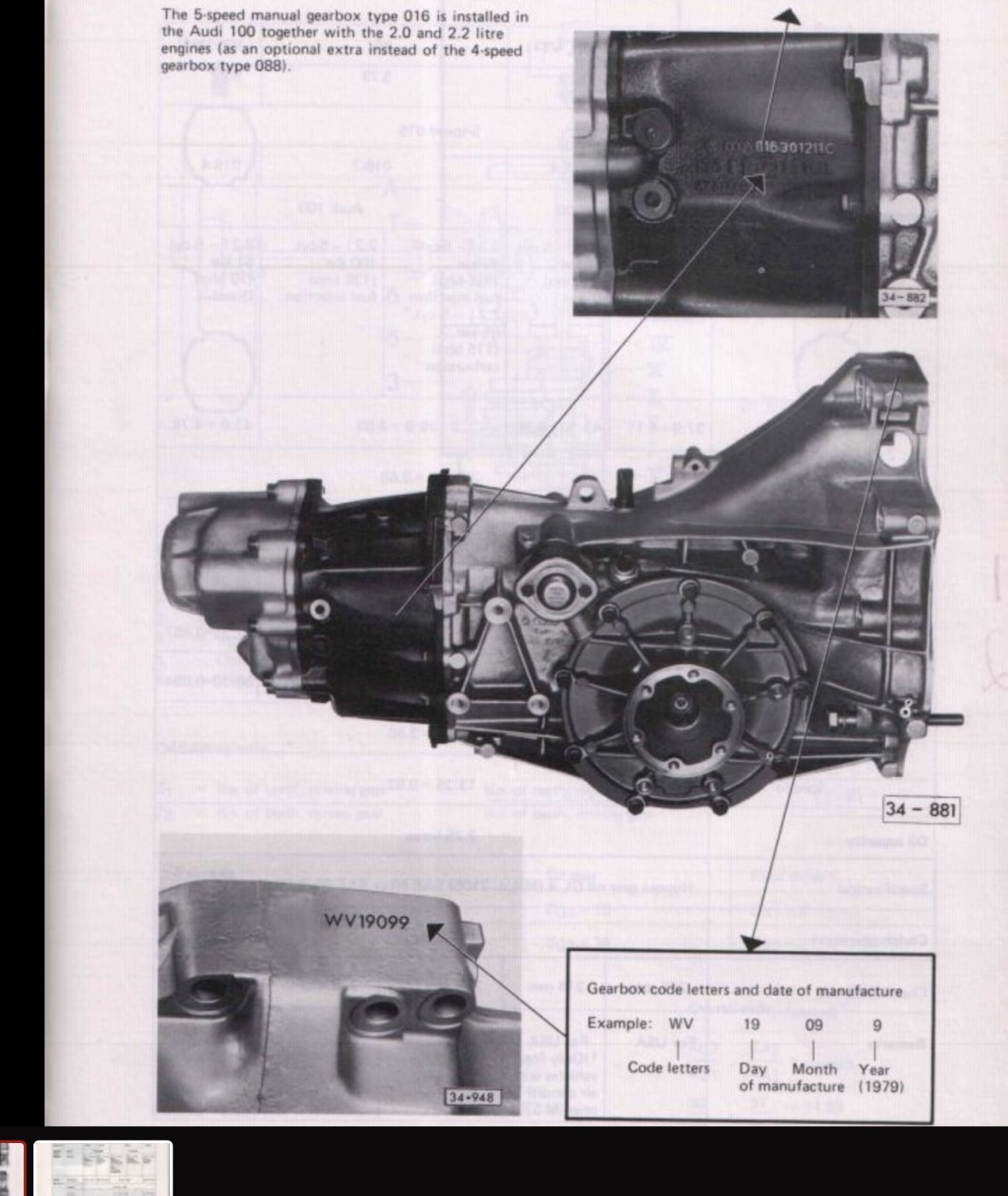

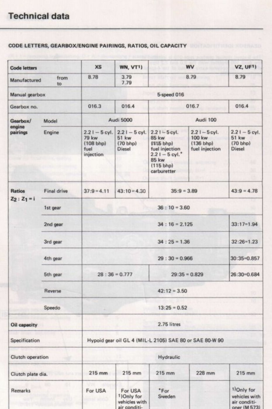

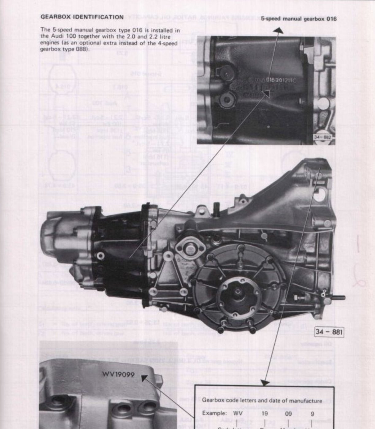

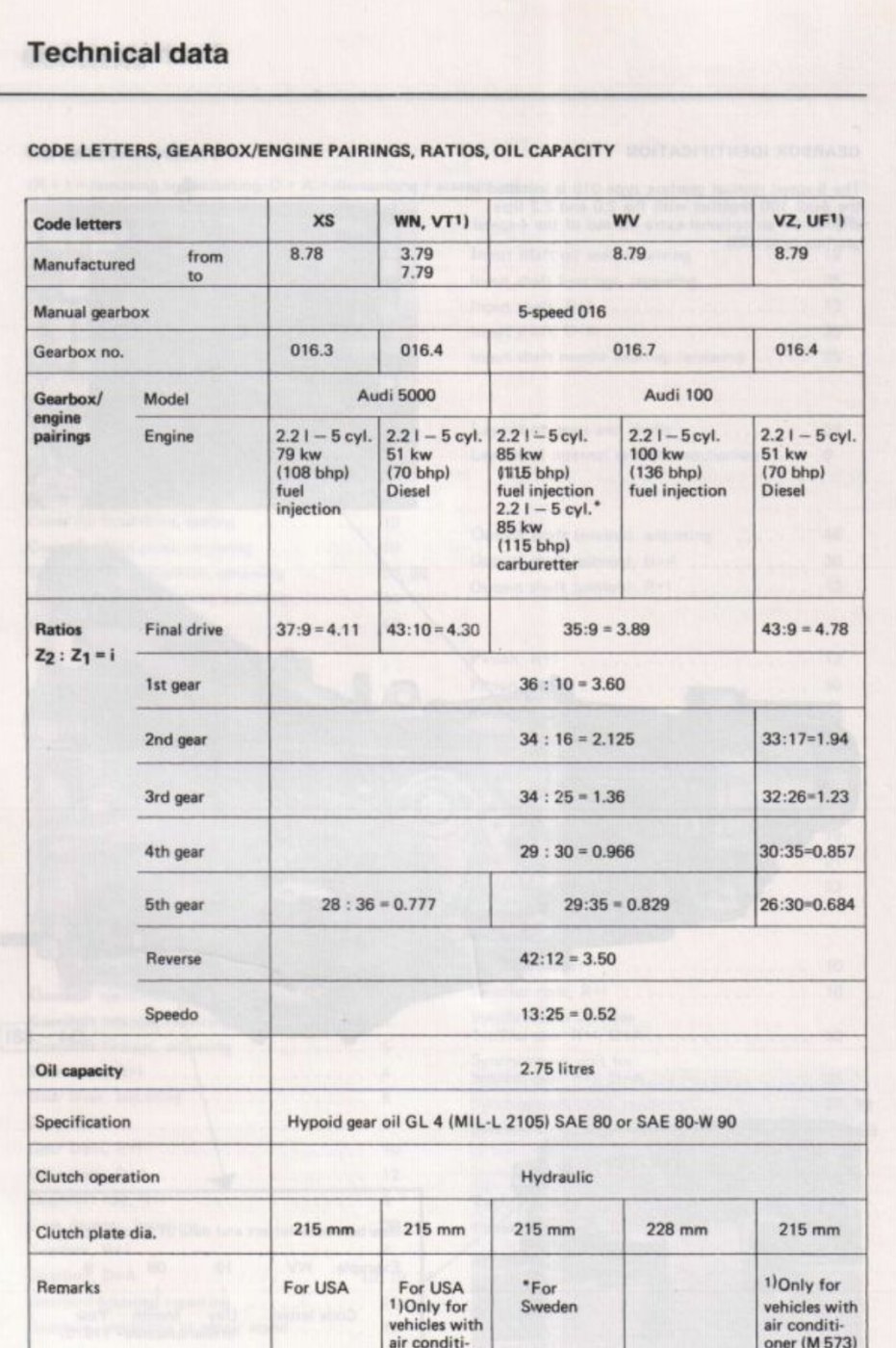

A little more information which may help Sean.
