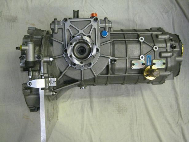

First off, Chris Melia has been very easy to deal with and I am very pleased to announce that I now have a wonderful ZFQ transaxle for my P4.

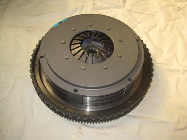

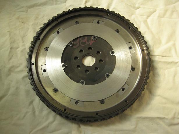

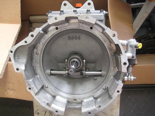

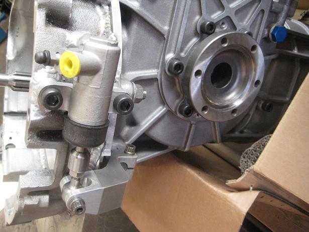

Secondly, John Wisher is doing a first-class job for me, re-engineering the existing Ferrari bell housing and also modifying the existing flywheel to accomodate an AP twin-plate clutch. I can't wait to get it all bolted up and sitting in the chassis.

Here are some pics of the modified Ferrari Bellhousing and Flywheel with the twin-plate clutch:thumbsup:

Here's a side shot of the whole lot. The large extra Ally slab you see below the bellhousing has been left in place to later be formed into two lower brackets to mount to the chassis. Once we know where the chassis cross-member needs to be to suit.
