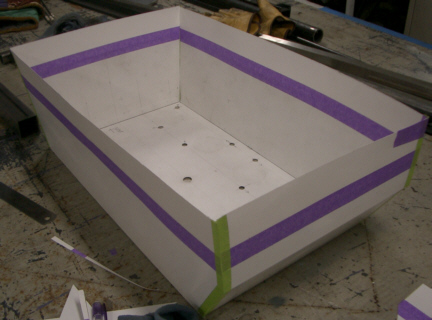

I used 5052 T3 aluminum, .050" thick but 6061 would work. Make a pattern out of heavy white poster board. You can take the carbs off and the studs where the carbs bolt and then apply graphite to the top of the manifold where the carbs bolt. Then carefully set the poster board down on the mounting surface and press down so the graphite makes an impression. Cut out on the impression line, measuring where necessary. It's also easier to just measure than you would think, the carbs are all the same spacing.
Construct the poster board pattern just as you would the final piece. It's made from only one piece with the sides folded up and the corners taped in position. Set it in place to make sure everything fits and has clearance, especially to the valve covers, before transferring to metal. The actual pan is all one piece with the sides folded up and the corners tig welded. One thing you have to be careful of is to keep the bottom really flat, you don't want it to leak at the base of the carbs.
The cardboard pattern pictured has the sides higher than the final piece. I ended up building the fiberglass down to meet it because the engine is so low in the chassis. Mine fits the TWM EFI manifold so I don't know if it would fit yours.

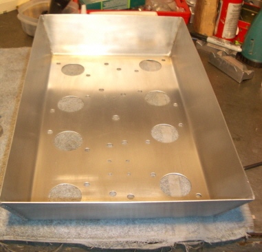

You mentioned that your was for the TWM injection, and from mine it looks like the injector rails would be above the tops of the throttle bodies. Are the rails inside of the pan on your design (lots of extra holes)?

The dim bulb in my brain just went on /ubbthreads/images/graemlins/smile.gif. The pan does not mount to the top of the throttle bodies, but the bottom on the manifold!

The pan mounts sandwiched between the Tbodies and the manifold. The extra holes are for vacuum lines going from each Tbody to a common junction block mounted underneath.
Will do a cad drawing when I get time. Need to keep my cad skills from getting rusty anyway.

Another thought, and doesn't look like a problem, but does it clear the distributor (dizzy for other folks)?

Definitely does not clear the distributor. The TWM stuff barely clears so it's going to be tight if you need dist clearance. Small caps are the only thing that will work, not even enough room for a large HEI cap.
Looking at the parts manual the pan on the original car looks like it doesn't really have a tight seal, just a cut out at the dist location.
From my reading on the restoration of 1076 (re racing icons), the cold air pan they made has a cutout for the dizzy. also interesting is they added phenolic spacers under the Webers to help isolate heat.
