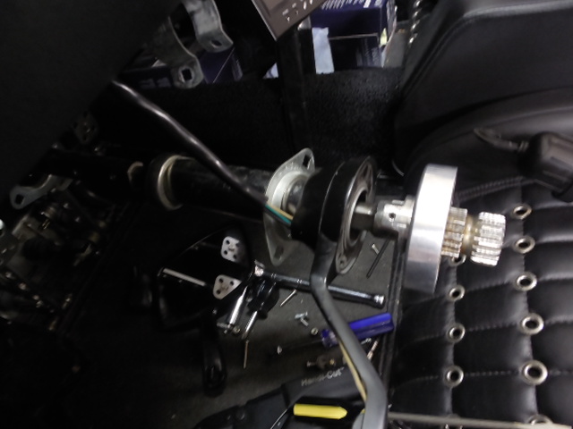

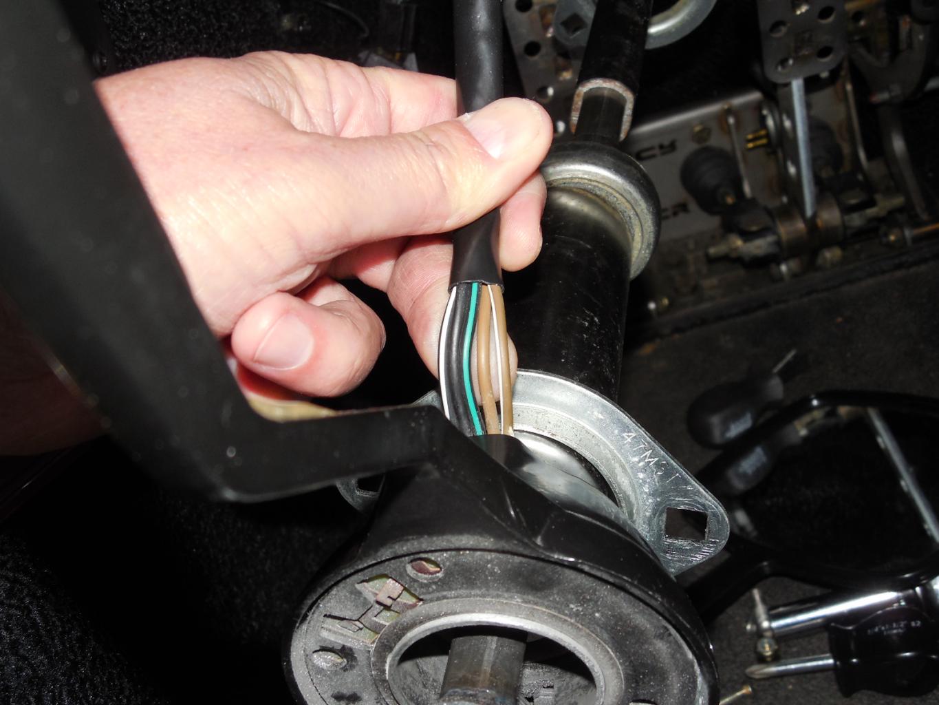

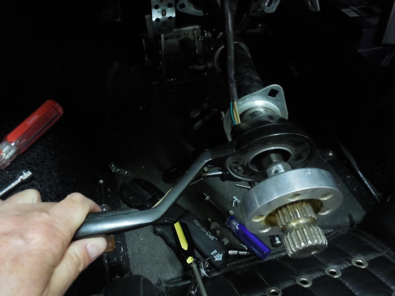

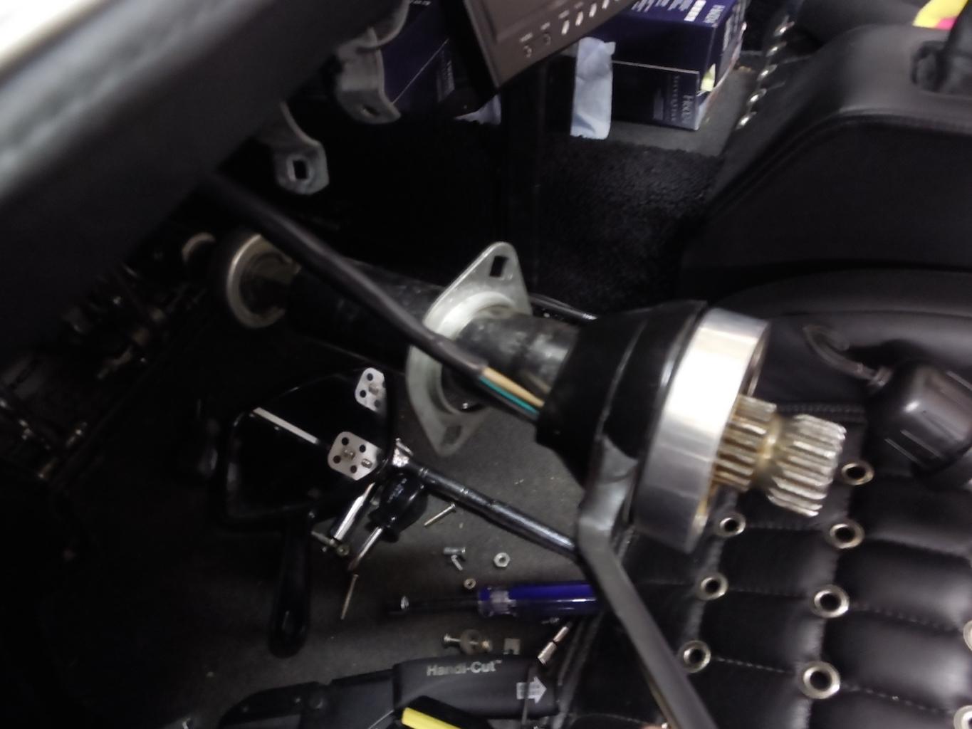

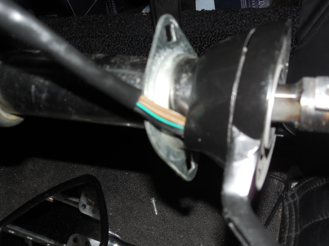

I have a turn signal/horn unit mounted on the steering column, The turn signal were binding and now have quit altogether. The horn still works. I cannot identify what kind of unit this is to get a replacement. It was a nice set up, but it needs to work.. I may end up cutting the wires and place toggle switches on the dash but I had rather keep the set up I have. Any Ideas?

That looks like a '66-'67 VW Bug switch. Same as used on most original Cobras. Is it secured by a single screw acting on a shallow flat-bottomed "V"?
I think you are right. I looked it up at mid america vw and it looks the same. just out of stock. So at least I have a start. Now I just have to get the rotating collar off the shaft as the top part is welded. I hope is is jst a slide on piece. Thanks Tony
