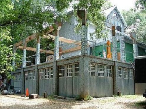

I built one with a 1/2 exposure to below grade considerations. Use a lot of small rebar. I made tubs and columns out of galvanized sheet metal and then fillied them with concrete.
My ceiling is another slab. Good thing to have fire protection if your garage is under your house.
There are enough original parts in my house though that it still qualifys as a house.
