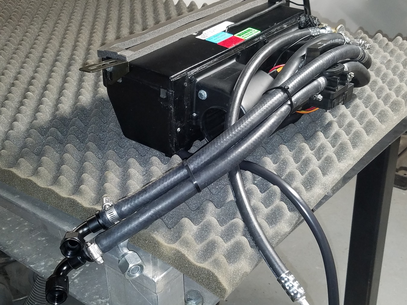

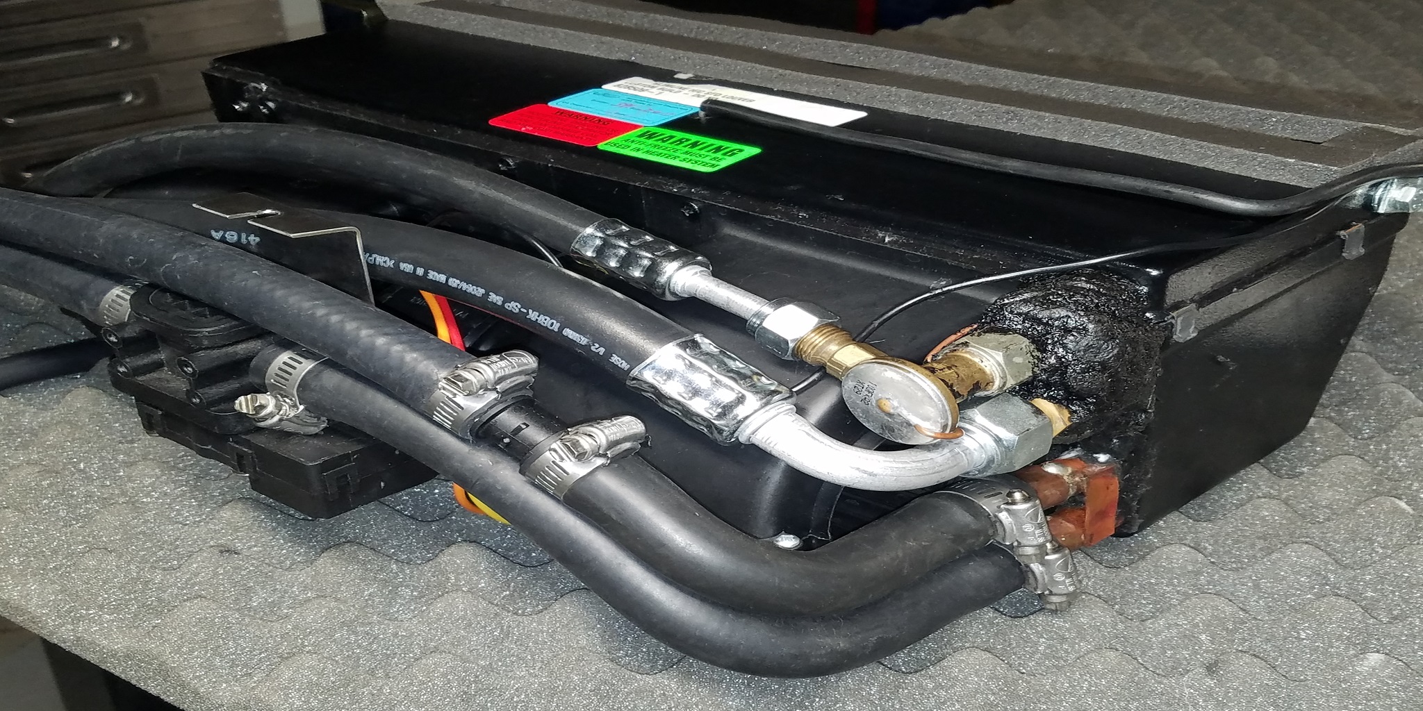

Were did the summer go? I was so busy with other things that the SLC took second seat. Here are some pictures from what I got done.
Nothing exiting. The typical problems on placing the A/C. As already done before me. The evaporator was inverted 180 Degree and the housing was shortened. New exit holes drilled. Now there is plenty of room and with the AN fittings and hose length, I can take this entire unit down in minutes without disconnecting anything. The servo valve found its place behind the fans in line with the heater hoses.

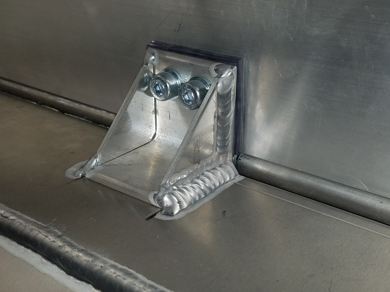

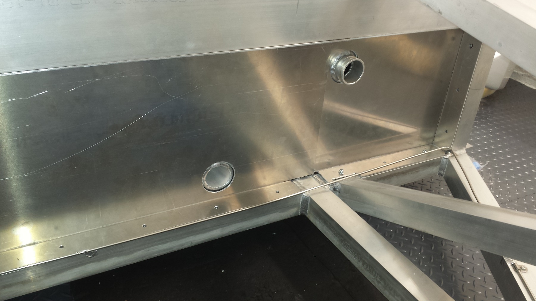

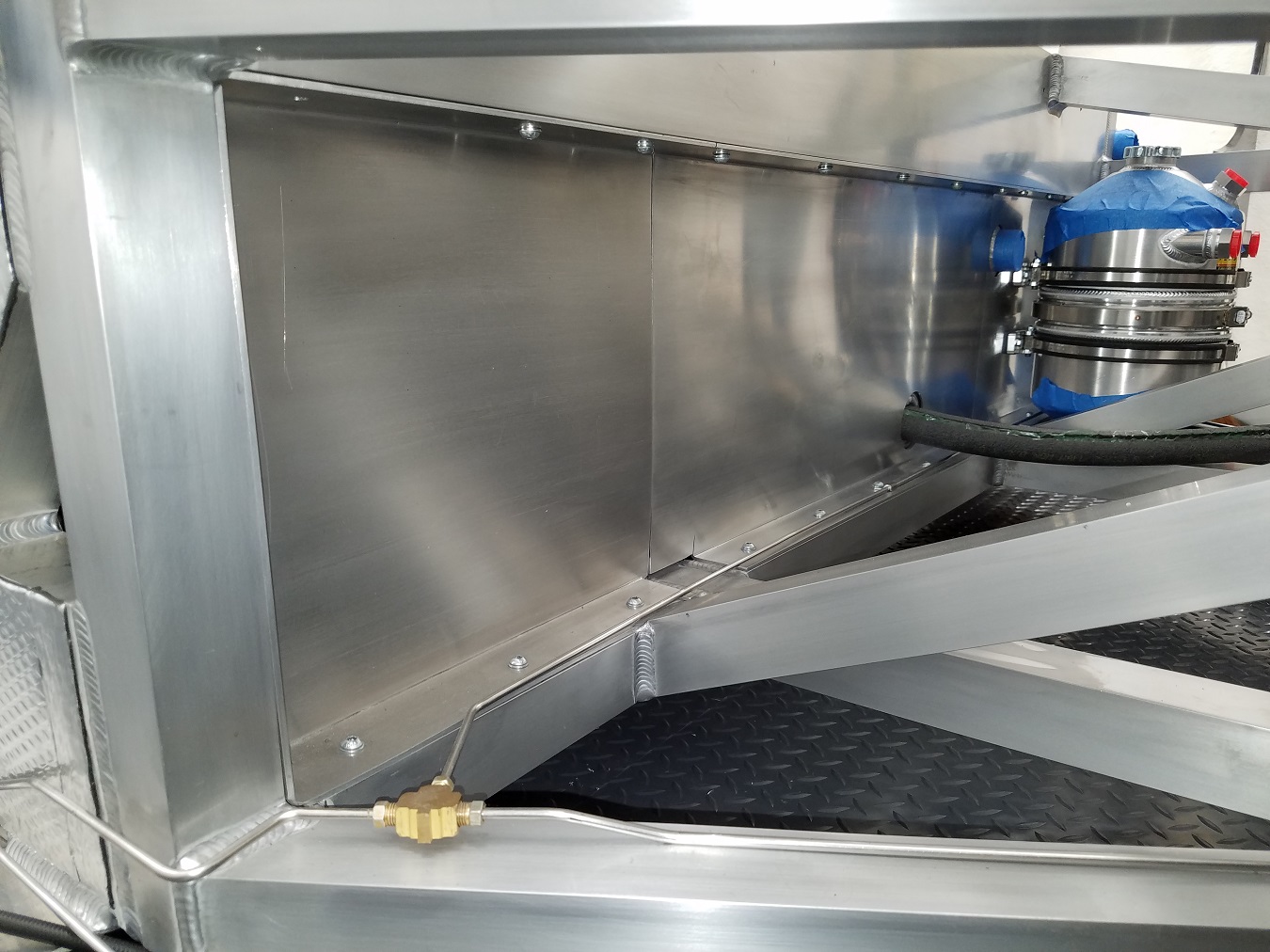

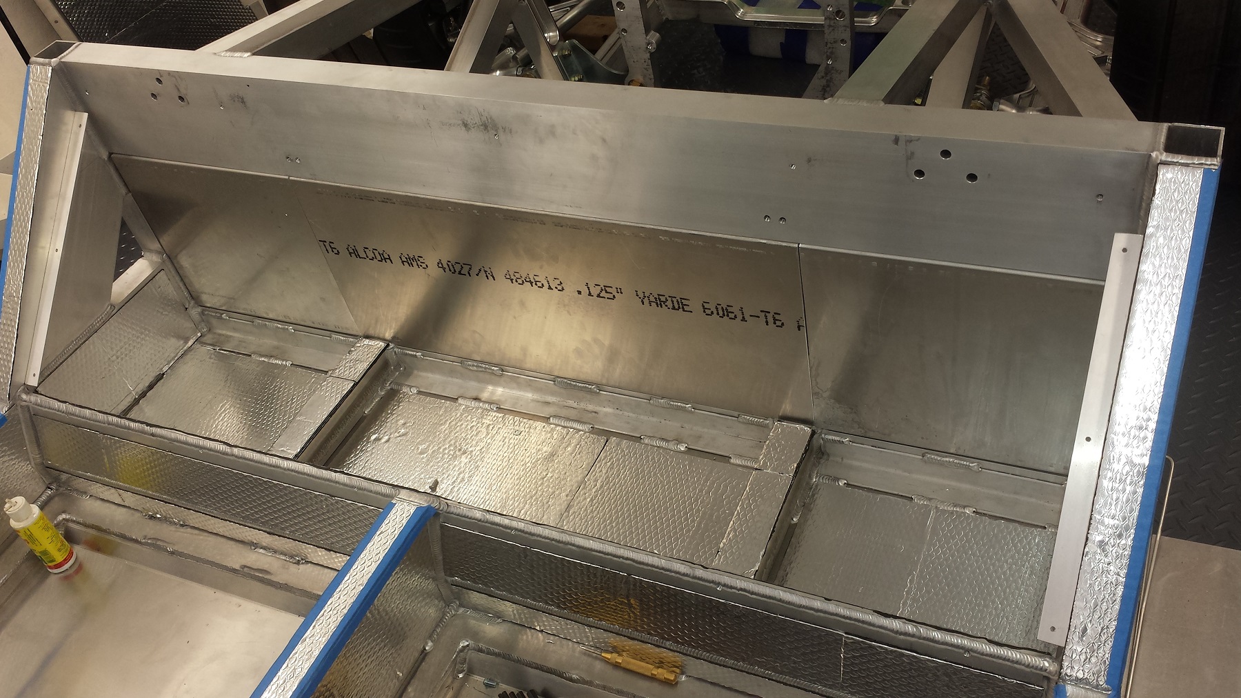

Here are my design efforts on the firewall.
