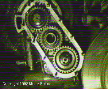

All the ferrari 1980's transverse V8s (308/328/Mondial) also use drop gears....two, in fact..in a longitudinal fashion, though the drive is sent back 180 degrees relative to the crank output. Bevel cut, works pretty well, makes for very easy clutch changes as neither the engine nor gearbox has to come out of the car to replace the clutch.

I'm surprised that 308/328 were transverse engined. Here is a pic of the Testarrosa trans (where is the drop gear, clutch & bellhousing? :huh: ):
Regarding F40, it seems to me that the distance between the bellhousing and centre of driveaxles is about 300mm (100mm more than Boxster) so, coupled with the V8 motor, how did they manage to fit it all in a relatively short wheelbase (96.5") of the F40? By comparison, the Boxster wheelbase is only 1.5" shorter (same as original GT40) and yet it's a tight fit with the flat 6 motor with half shafts angled slightly.
