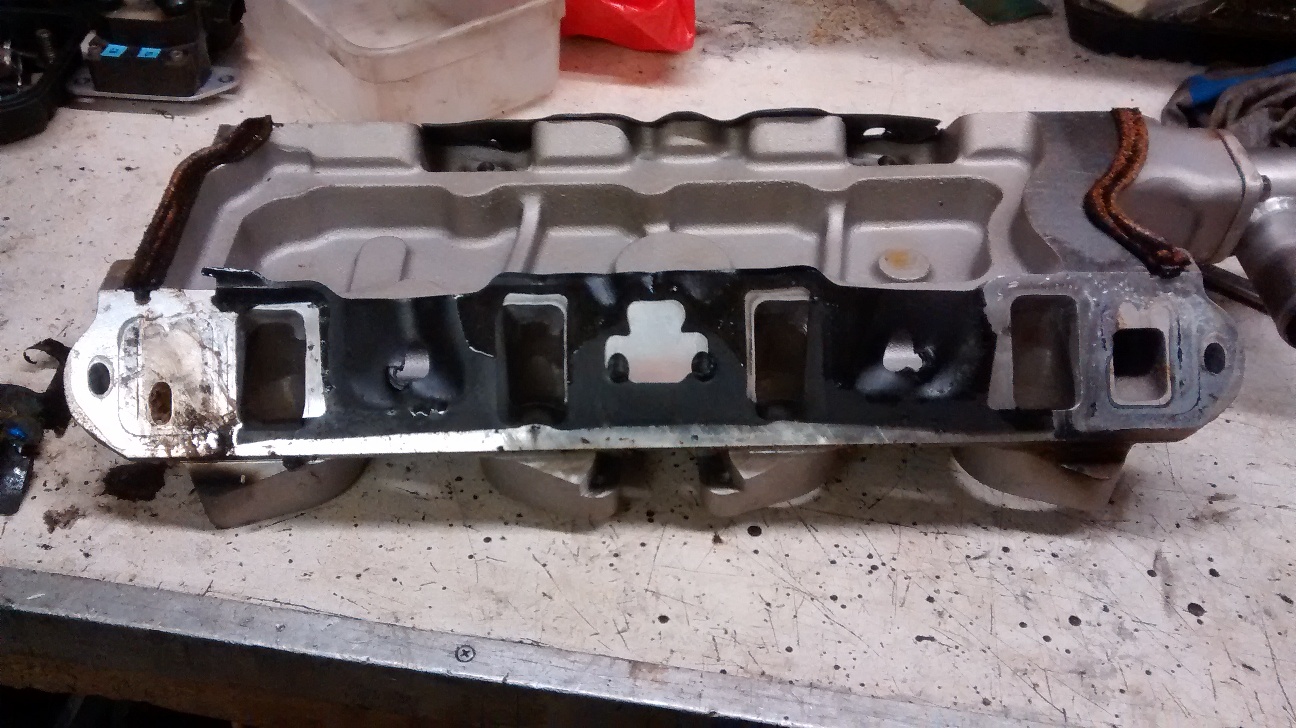

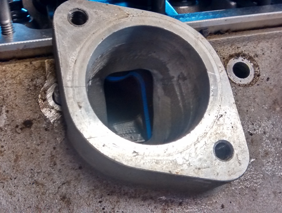

Reading your post, I realised that I’d had exactly the same problem as you on my engine, which has an 8-stack injection system. I hadn’t actually spotted the issue when the engine was running, but it was evident when I stripped the engine to resolve other issues (I’ll post on this when I get a bit more time)<?xml:namespace prefix = o ns = "urn:schemas-microsoft-com<img src=" /><o:p></o:p>
<o:p></o:p>
The attached is the view I had looking down the inlet manifold after removing the throttles and the state of the gasket when removed. The issue was caused by the cork gasket between the block and the manifold being too thick, preventing sufficient clamping force between the manifold and heads. A dry build confirmed this and it was rebuilt with o-ring cord between the manifold & block (the manifold has a channel to take this) and a small amount of sealant on the gasket to cyl head to prevent any movement<o:p></o:p>
<o:p></o:p>
To do the job properly, unfortunately you’re going to have to remove the manifold, which as you’ve pointed is a PITA! I found using a crow’s foot spanner is really useful for the fixings underneath the throttle flanges<o:p></o:p>
Hope this helps<o:p></o:p>

Andy,
Just a note to you about the removal of the intake gasket. I was not looking forward to trying to pry the intake off the engine. So I took Plan B approach. The intake manifold has a water exit/neck at the front of the engine that sticks out from the block I was trying to find a way to lever on this piece. My rear motor panel support is too high to get anything under this piece or any other part for that matter. I remembered that I had several ring gears for the Porsche left over from my teeth breaking incidents. So I took one and put it around the water neck on the intake and used the engine hoist to gently pull the manifold away from the block, which it did. What it showed was the gasket on the #5 port(left front) had slipped down into the lifter galley. Air and some oil was being sucked into the cylinder.
The O2 sensor is on that bank and it evidently was reading lean as all the plugs were black, which says the computer was trying to pump more gas in to the mix. Explains that when I would race the engine without load there was a lot of soot coming out the exhaust and a lot of backfiring on deceleration along with flames shooting out the back. Will have to re phase the distributor as well since there was fire seen under the throttle plate on that cylinder as well(phasing a distributor is for electronic ignitions that incorporate a distributor to "distribute" the spark to the various cylinders).
The bolt openings are too big for the bolts to hold the gasket in place, so some sealant/gasket maker will have to be used to hold them in place while slipping the manifold back on.I will use some bolts with the heads cut off as guides for the manifold. That way i will know they are sliding down straight to the heads.
