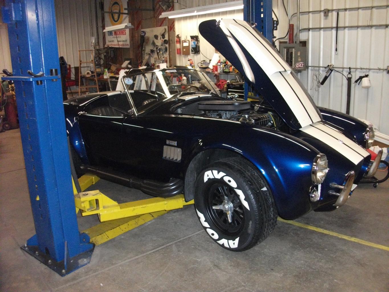

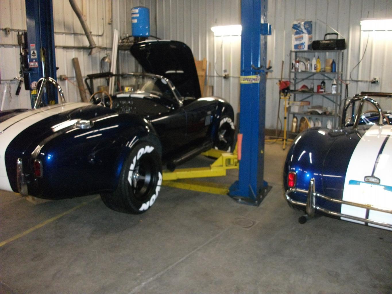

AVON does not supply the blue line. Again can be done with the kits from the tire lettering people (there is more than one supplier for these kits)
Just did a some AVON CR6ZZ with lettering for a customer, AVONs with "AVON".....go figure!

The "AVON" in the photos I posted are 2.5" on 245 front and 295 rears. The customer decided these were "too big" and had us flip the tires. We ground off the raised nibs and lettering that the letters would cover with a Roloc surface conditioning disc, this made the mounting surface flat for better adhesion. The font was what Tirestickers.com had for AVON. Look also at Treadwear for their choices.
When properly applied these do NOT want to come off!
