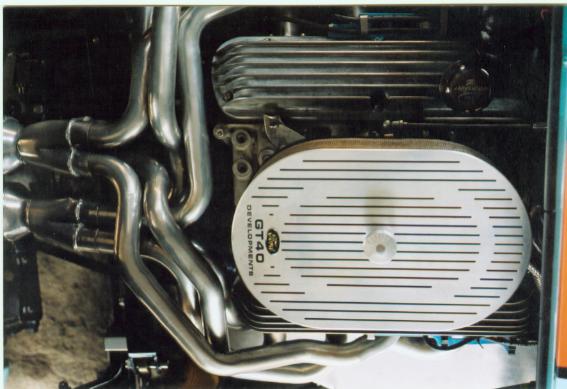

GT40 Developments South Africa sells bundle of snakes exhaust systems - ceramic coated to cut down on heat dissipation - heres a pic of my 40 done by them. Will post contact details for them soon.
