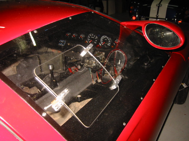

GT40 Australia's own design in elecronically adjustable mirrors fitted. Look pretty Hot IMO and you can see. /ubbthreads/images/graemlins/laugh.gif

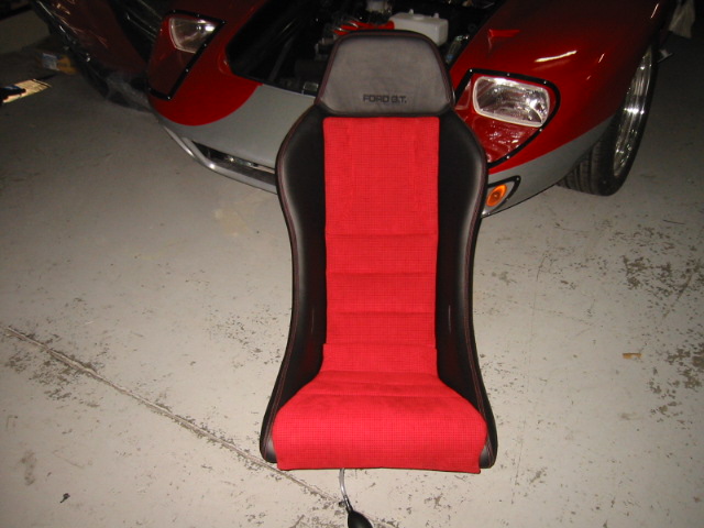

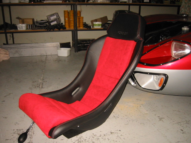

Seats have arrived back from the upholsterer. The little bulb attached to the plastic tube at the bottom of the picture enables you to adjust lumbar support.

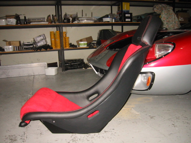

last one /ubbthreads/images/graemlins/laugh.gif

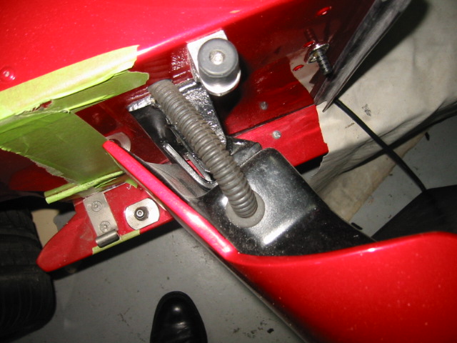

(BTW, how are you going to route the speaker cables thru the door hinge area - I have postponed my stereo installation as this bit looks too hard at the moment.
Kind Regards,
Peter D.

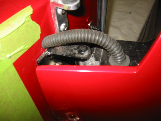

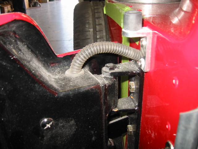

[/ QUOTE ] Peter, the speaker cables and mirror control cables are routed through the door above the top hinge. see Pics.

Hope these help /ubbthreads/images/graemlins/laugh.gif

Peter Delaney
Re: GT40 Australia #48
Thanks Pete.
If I had the presence of mind to run the wiring in much earlier, that would be the way to go (Dave Harris has a very similar setup, but goes into the doors on the front inner edge).
I would have also figured some way of getting at the door hinge mounting nuts under those panels as well (not too late for you). I am thinking here of eiter :
- 30mm sealed tubes, glued to the steel side wall around each nut, then coming thru the kick panels (& sealed around). That way, you could preserve the integrity of the kick panel seals (essential to keep fuel vapour out of the cockpit), but still have access down the tubes to the hinge mount nuts if (when) you need to do any door alignment adjustments.
or
- Seal off the rear areas around the hinge nuts from the fuel filler tube area with a wall between the steel side panels & the kick panels & cut out sections of the kick panels to make access hatches.
BUT, I am stuck with having the inside kick-panels already well & truely sealed & stuck in place. It would be a nightmare to remove these panels, so I am thinking of maybe running some very small & neat external surface ducting from the front under-clip area, across the bodywork behind the filler necks (under the clip), & then down to a point roughly where your cabling comes out, & from there, a flexible duct into the door like yours. For the moment, that's the only way I can see how to do it without removing the damn kick-panels !

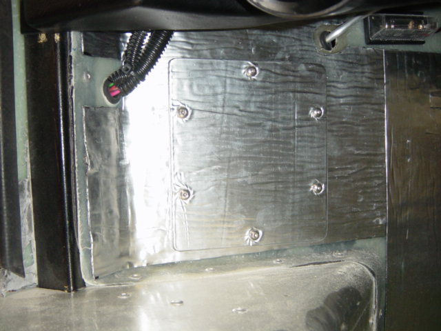

Hi Peter - That's what I thought you were referring to!
I'll try to attach acouple of pic's of the panel without the carpeting on it. there is an Access Panel that screws into the kick panel to allow you to get at the fuel filler connections and door hinge nuts. The wires are just fed thru a drilled hole that the carpeting covers up. The panel is covered in "fat mat" sound reducing sheets so it might be hard to tell. The cover plate is just an aluminum plate and the screws go into "nutcerts" (or perhaps better know as "rivnuts"?).
let's see if the pic's work, if not I'll PM you.

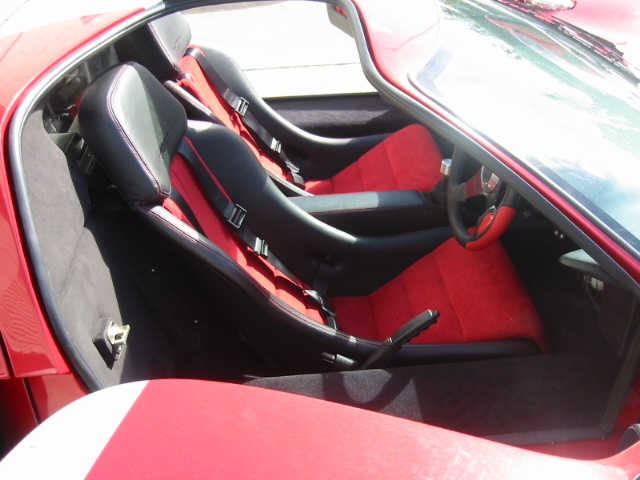

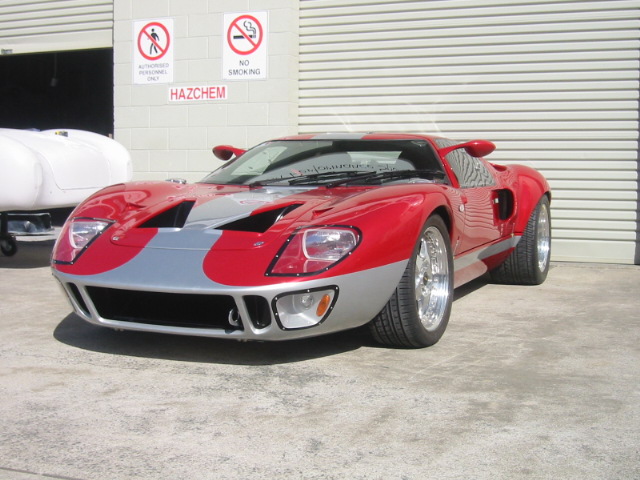

The car is now all but finished /ubbthreads/images/graemlins/laugh.gif /ubbthreads/images/graemlins/shocked.gif. And thanks to this wonderful forum I have been given a contact name at Qld Transport. Any Queenslanders want it it will cost $$$ /ubbthreads/images/graemlins/grin.gif Latest pics.
