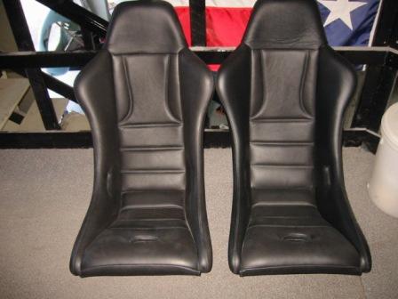

They will be the GT40 Australia seats, available in various trim finishes.
Here are mine which I'm looking forward to seeing 'in the flesh' within the next two weeks (Shipping and Customs permitting).

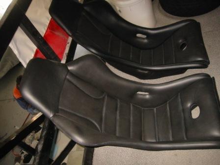

Another picture.
If you want to measure them, you can come and help unload !

Di, my wife and I dropped into GT40 Australia last week to be fitted to the seats. First time actually sitting in our car. /ubbthreads/images/graemlins/grin.gif Moveable seat rails worked perfectly, but major problem /ubbthreads/images/graemlins/frown.gif with my helmet on there was not enough headroom even with the lowered floor. Seems I have a long body and short legs. Di unkindly mentioned Neanderthal.The problem was solved by removing the seat rails.Fortunatly, Di is tall and I am a shortarse so we found a seat position that we are both comfortable with. /ubbthreads/images/graemlins/grin.gif We both felt very comfortable in the DRB race seats, they are snug, with good lateral and lumber support.In fact I did not want to get out and sat there making VROOOM VRRROOOOOM noises while the crew went for coffee. No idea what they were giggling about. /ubbthreads/images/graemlins/blush.gif

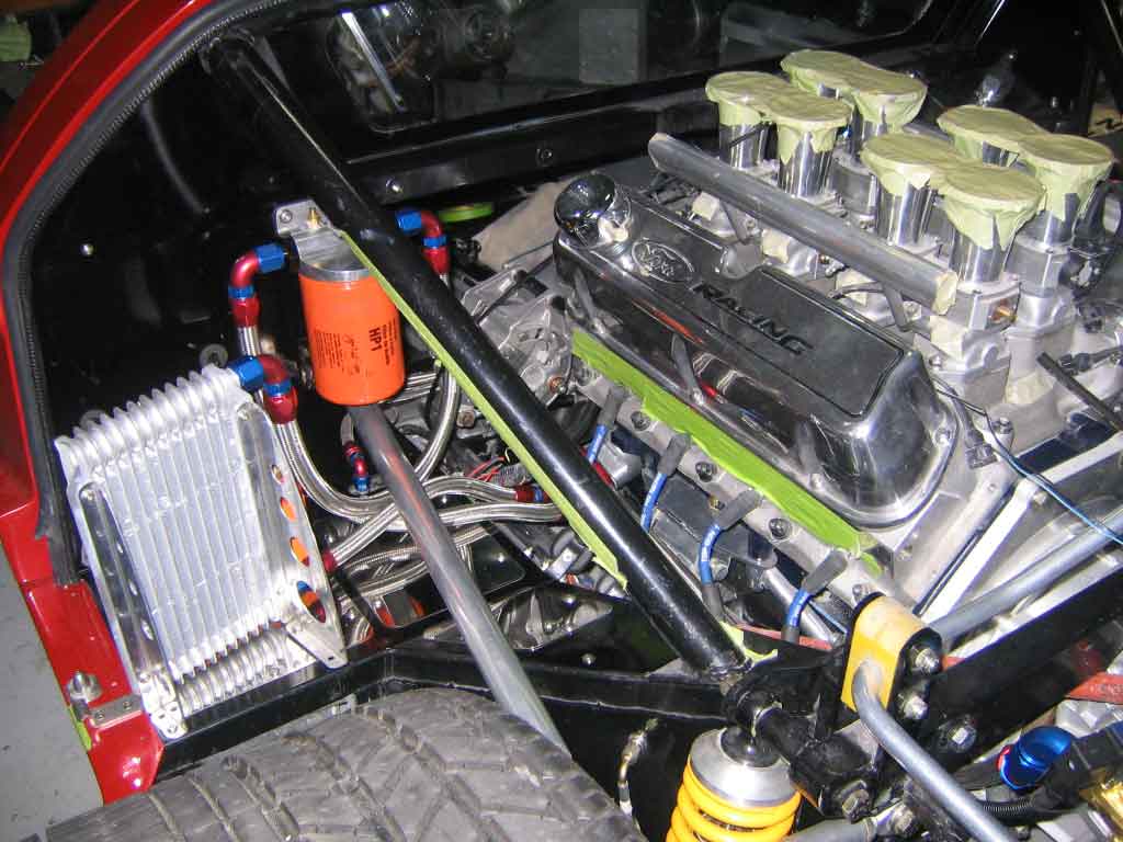

/ubbthreads/images/graemlins/smile.gif /ubbthreads/images/graemlins/smile.gif /ubbthreads/images/graemlins/smile.gif /ubbthreads/images/graemlins/smile.gifA HUGE step forward today. Turned the key and fired up the engine for the first time today. Too many celebratory Chardies to write more except it sounds AWESOME /ubbthreads/images/graemlins/grin.gif More Pics and if I can figure it out,sound in the next few days.
Re: GT40 Australia #48
Pete,
Congratulations on getting her fired up! /ubbthreads/images/graemlins/cool.gif
That long wait is almost over! /ubbthreads/images/graemlins/laugh.gif
What's with you Aussies and those orange trumpet filters?
Some sort of wierd sock fetish? /ubbthreads/images/graemlins/tongue.gif
Pete McCluskey.
Thanks bill, the orange filters look crap, but are very good
and the car is in a very dusty enviroment at the moment.When I get it home I will put some "Pretty" filters on it which will "Knock your socks off" I have attached sound of the engine. Click on attachment at top. This was recorded on my mobile phone and transferred to my laptop so the sound is not flash /ubbthreads/images/graemlins/frown.gif but it gives you an idea. /ubbthreads/images/graemlins/laugh.gif

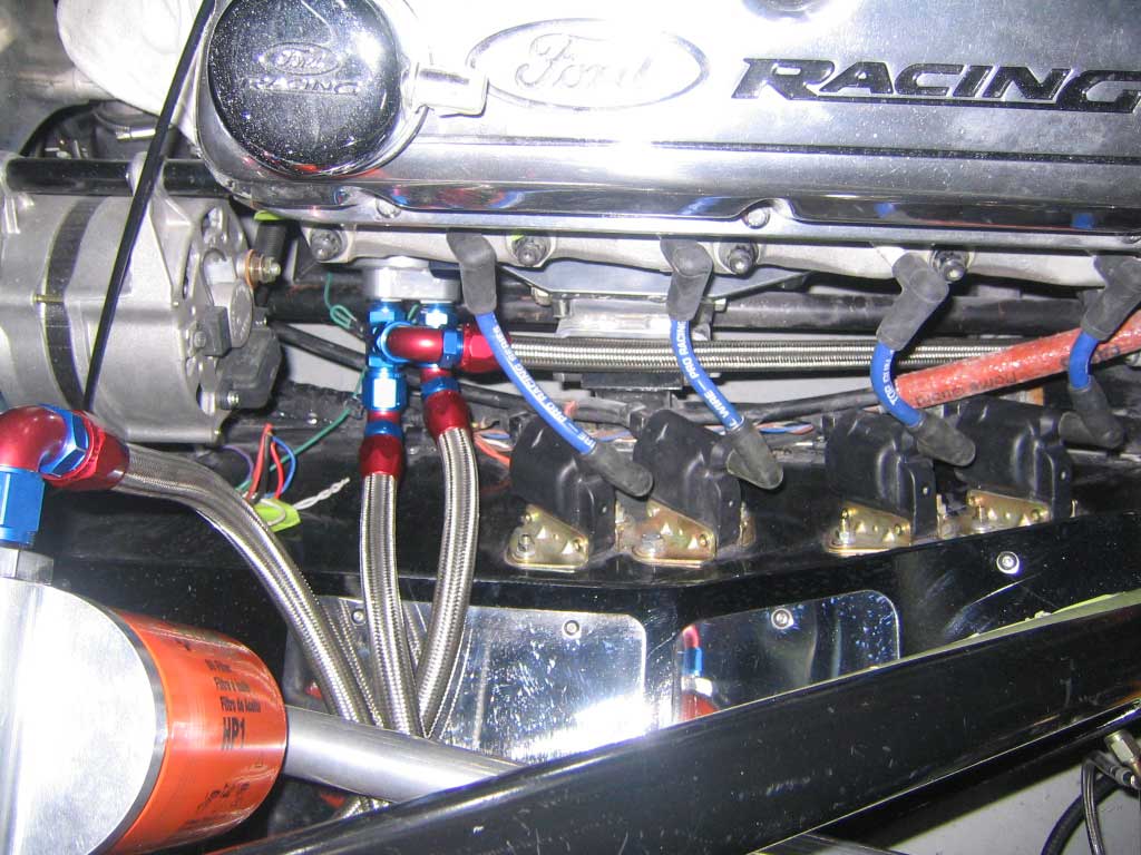

Yep, sounds like a ford, or our eager staff are waiting to serve you /ubbthreads/images/graemlins/grin.gif /ubbthreads/images/graemlins/grin.gif
