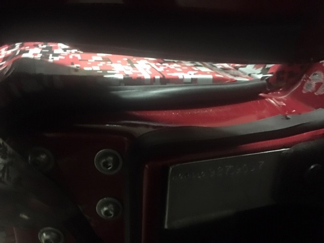

The top part of the image is the front clip and the bottom is the door on the passenger side; the seal you can hardly see here is the same seal in the images below. The seal is clipped on the front clip

This is the same image with the door open looking from in the car.

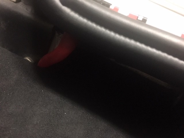

Weather stripping forming channel

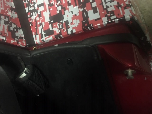

Lower part of channel; notice the brass drain tube
Bottom of drain tube

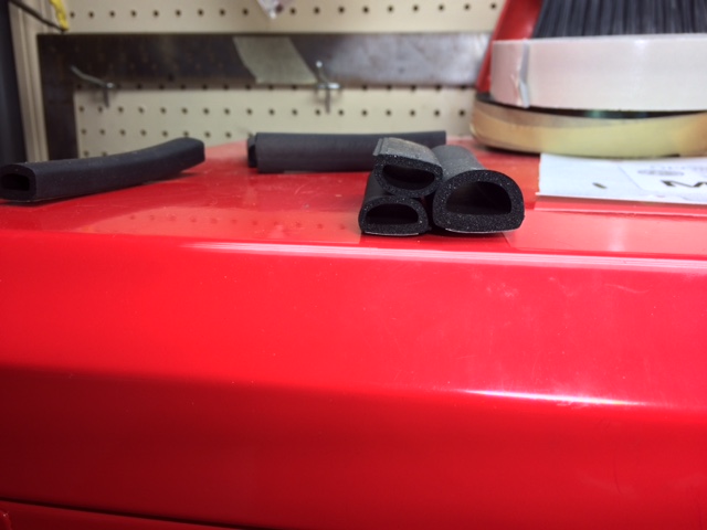

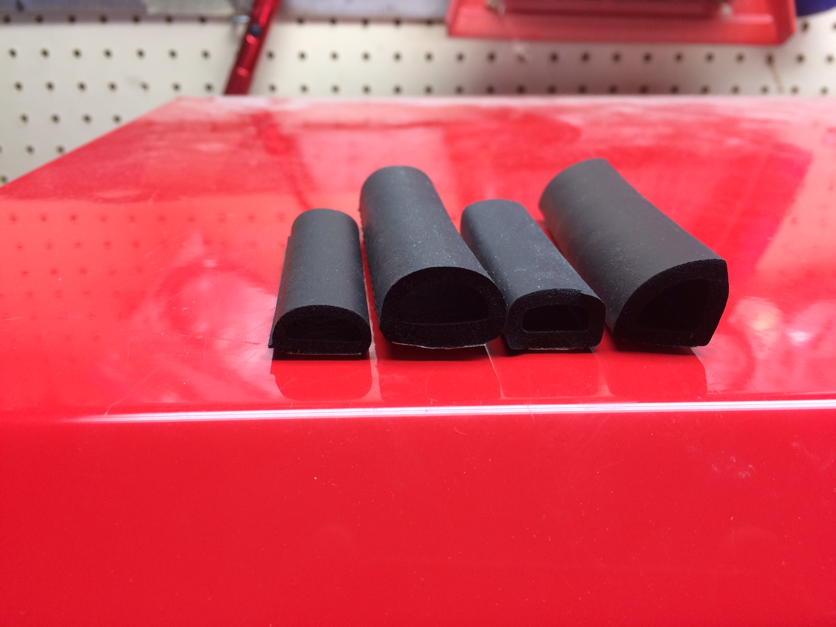

In keeping with this subject, I'm still having door seal issues. I took one door with the standard seal from Mc Master (2nd from left in picture) and on the passenger side mounted it to the car, and on the driver side to the door. I could in some places see light coming under the seal on the driver side. The most alarming experience was washing the car for the first time. As expected I placed a catch pan in the driver seat. It accumulated a lot of water because attaching the seal to the door offered no rain gutter. So a gutter system is a must or else bring a swim suit.
Attaching to the main body has given me the better seal and the gutter, however the 90 degree corner at the front of the door near the window is tearing up the seal as the door is opened and closed. I wish I had noticed how close that section of the door was to the body...I would have sanded some of that corner down.
I have four types of seals in the picture. first left to right, a smaller EPDM half moon, 2nd the recommended EPDM half moon, 3rd a rectangular rubber seal and 4th a triangular EPDM version. I'm thinking I'm going to need seals on both the door and the body, but the trick will be not to make them too thick and go for a seal to seal set up vice compression against the body or door. I see this a lot on OEM cars so monkey see monkey do.

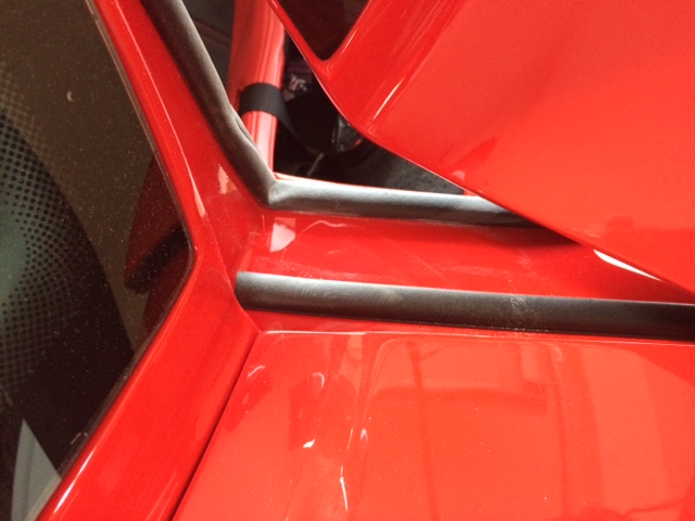

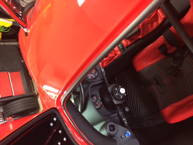

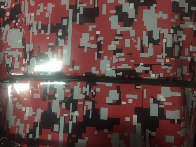

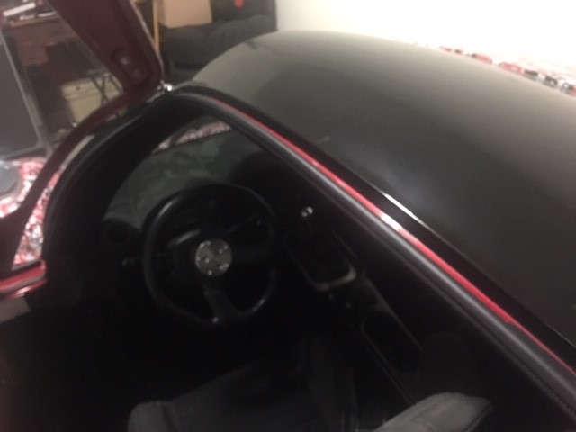

Well, I have come to my conclusion on sealing the doors. From the picture in post #9, I tried four differing shapes and sizes to create a weather seal. I had the best luck with the one on the left, Mc Master part 93085k14 5/8 x 3/8 Style E half moon sealer. I tried the single style half moon strips, and I had some sealing issues. I wanted a rain gutter so putting it on the body versus the door was a bit of a conundrum, out of site or rain gutter. I decided to try a smaller version of the half moon and put a strip on both the body and the door, a seal upon seal contact versus seal to fiberglass, similar to an OEM car. This has given me the best of both worlds. The strip on the body acts as a water tray and since the smaller strips are not as thick, they compress easier and I think it is giving me a pretty decent seal.
Now there is an area on the door which deserves your attention. Its the 90 degree corner between the two hinges (it was torn off by the door). Watch how close yours comes to the body when you open and close the door. I sanded that corner down some more to prevent it from taking off my strip. By running the two strips along that spot, I was able to avoid that corner as well. The two strips along that front edge gives me a seal on two parts of that front lower door. You can see that the two small strips stacked one on top of the other is slightly taller than the single, but it compresses easier than the single and that took some pressure off my door catch (too hard to open). Also, when putting it on the body, you can control the mating position to meet the door. I ran a water hose and got good results, but I wont commit to a full up rain storm....your on your own for that one.
Good luck which ever way you go.
