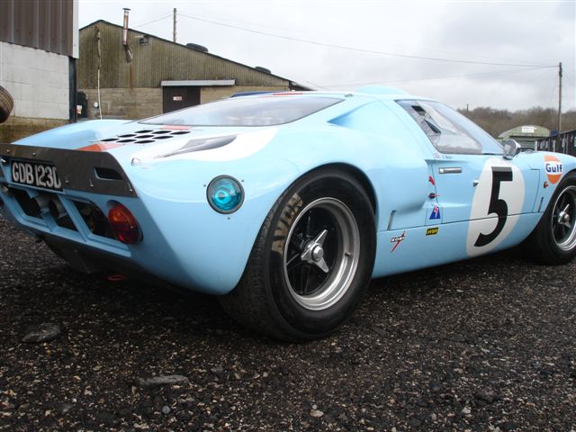

Glenn M
That weight for the Southern GT Carbon Fibre rear clip is an on the car weight, i.e. painted with glass all lights and rear spoiler etc.
Glenn
