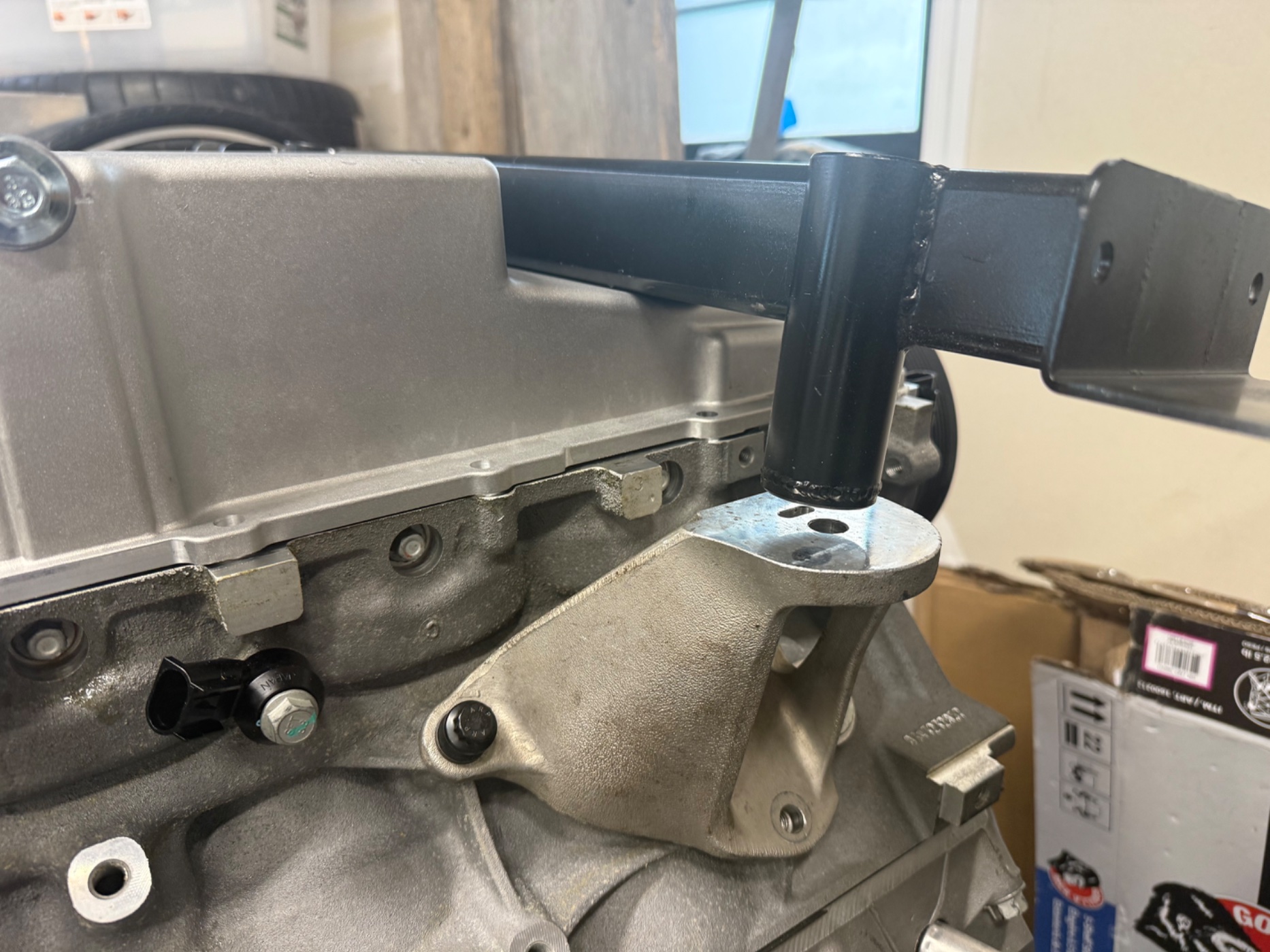

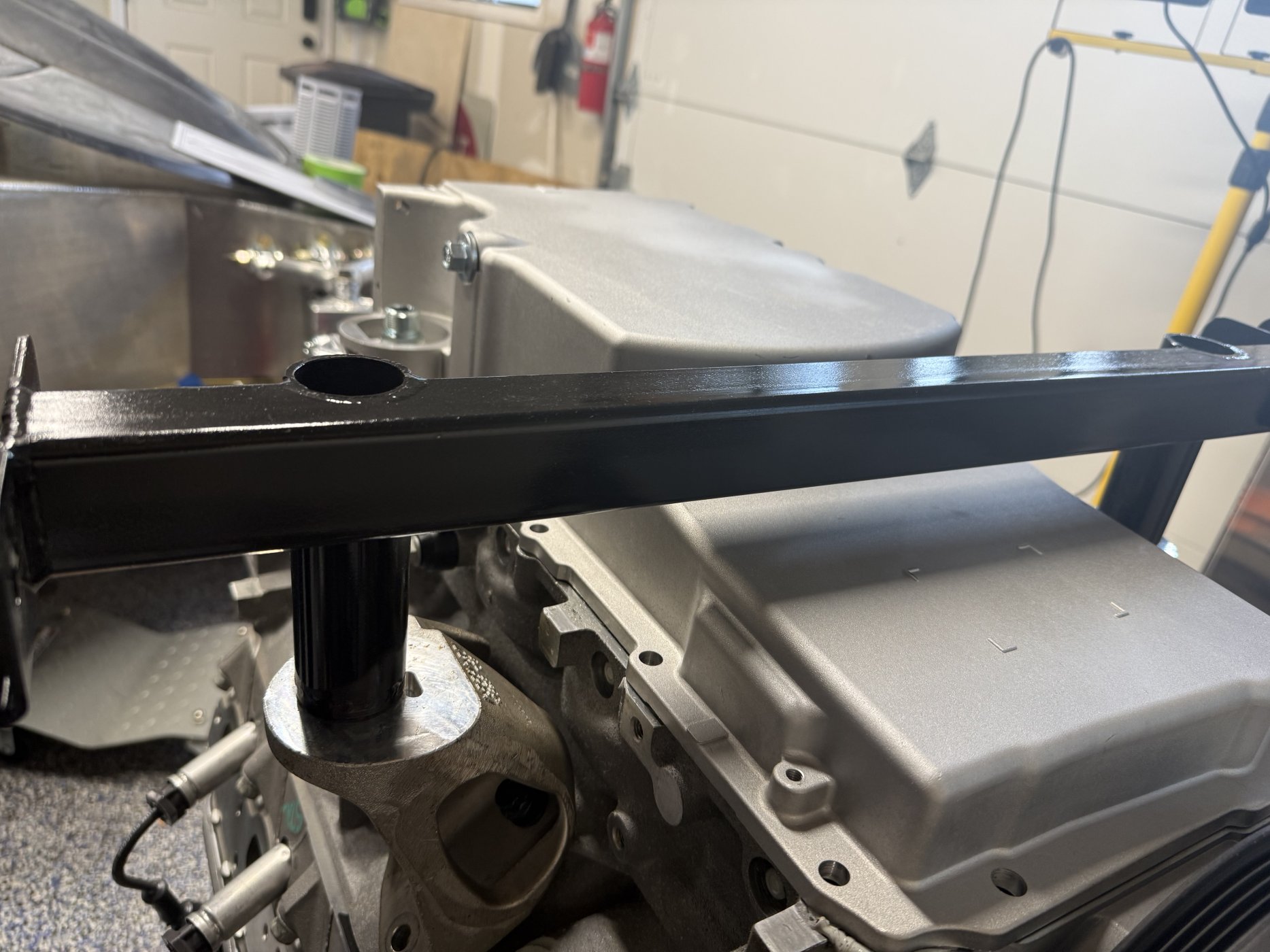

I’m not trying to be dense, but what am I missing? I got the low profile pan (12598186) and the Corvette mounts and the frame mount still has a huge gap. Do I have the right frame crossmember mount for the SLC?

Hi Jeff...I am Tom in Denver and I am about at the same place and have the same mounts....I will mock mine up today (I have an LS9) but maybe it will tell me something that I can share with you.
I had to add 1/2" spacers between my crossbar and the motor mounts in order to get the motor to sit level. It is detailed in my build log on pages 3 and 4. I do not remember if I also had issues with the oil pan hitting or not.
Can’t quite see the pan type you’ve got on your install, though I can see a snug fit with the crossmember. You have a Porsche (?) transaxle, so I’m not sure if leveling would work the same for the Graziano I’ll be installing.
Ken Roberts
My LS engine crossmember mount shows the vertical round tubing extending 2 3/4" past the horizontal square tubing. Your picture looks like yours is approximately 2 1/8".
You wouldn't be the first that received the wrong engine crossmember. If you purchased a OEM corvette oil pan and the OEM C6 Corvette engine mounts then it must be a wrong crossmember.
