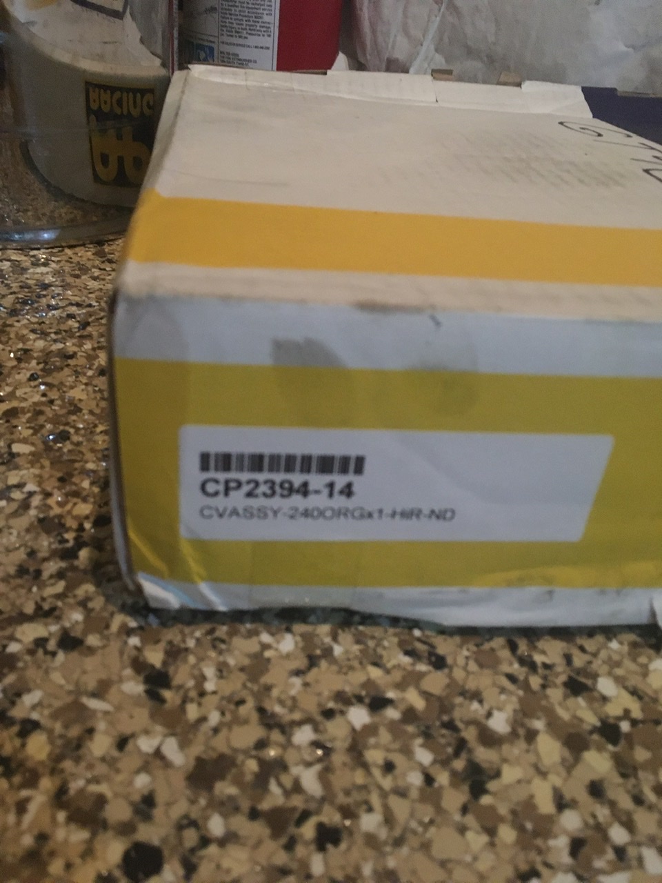

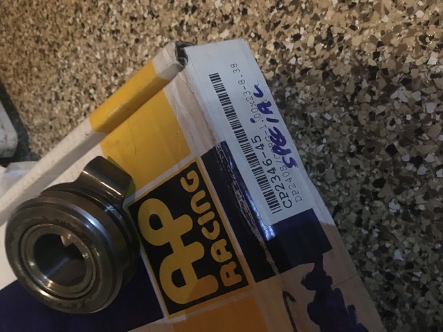

I had a Renault clutch which slipped. I checked on the best Renault upgrade clutch but the best was only rated at 280 ft.Lbs so I went with an AP clutch that I got from Mick at SGT. They are rated by AP at 340 ft.lbs. I have the part numbers somewhere or give Mick a bell. I had the original GTD flywheel drilled and tapped tor the AP cover. I also fitted Chris Coles's uprated release bearing and carrier. I tried a lot of combinations of slave and master cylinder to get the lightest pedal with full release. I ended up with a 3/4" master cylinder and one of Chris Cole's sleeved down slave cylinders which he does on an exchange basis. To get the correct set up with a small amount of free play (a few thou) and full release I removed the Renault clutch rod and pin from the arm and replaced the pin with an ht bolt and made up a new push rod of the correct length from an old ht bolt. However I believe Mick Sollis does an adjustable push rod which would save time and make subsequent adjustment easy.
PS the slave cylinder bolts are 7mm size - an odd size but you can get them if needed.
