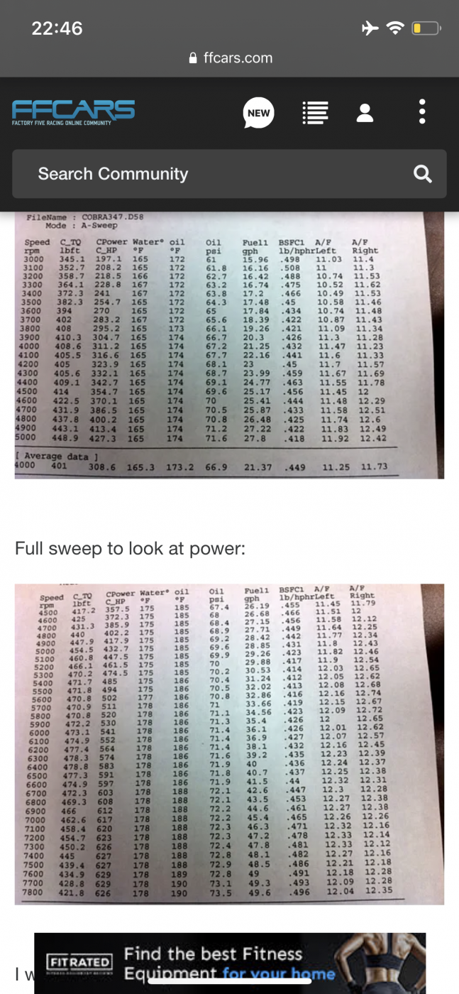

Should be way more power than I’ll need but perform well for the street too. Thinking probably 650+Hp 500lbft and the ability to Rev to 8k without issues. Will also fit within better emissions regs being pre ‘92.
Good bang for its buck but you suffer as it’s a 9.2 deck which is just annoying. Would’ve done the build with a 4 bolt 8.2 ideally but so difficult to find an old good one, although the 9.2 is much easier for race parts availability!
I know it will fit as fell in love with pantera1889’s car on here!
Many say it’s too much for a GT40 but I’ve never been one to follow the norm, below 5000 from dyno graphs I’ve seen with similar setups it should perform just like a slightly more powerful 347.
example below on a 10.3:1 341ci
