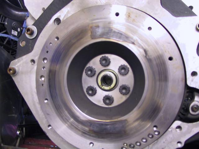

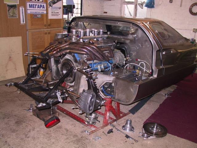

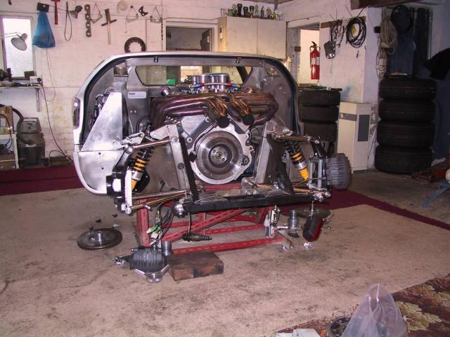

CAV pre 100 clutch / flywheel change ( obviously necessary )
Veek, I had to abort a clutch change on my 016 because, at the the time, I didn't have a proper/sufficient means to support the car and engine with the cross member removed. My CAV is mono #6 and I have to say, with the cross member removed (to allow the 016 to move rearward) it was awfully sloppy at the rear suspension mounting points on the chassis (no weight on the rear suspension, just the weight of the engine on the mounts). In my new garage I now have a 2-post lift, a 4-post lift and an overhead crane on rails so I'm in good shape and will do the clutch replacement over the winter.
Net, I think you have to take the weight off the suspension, support the chassis appropriately, and support the engine appropriately before you start to unbolt that cross member....
