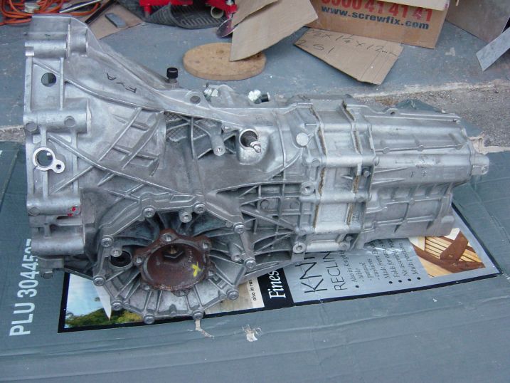

Wondering if anyone can ID this trans ? Thanks in advance

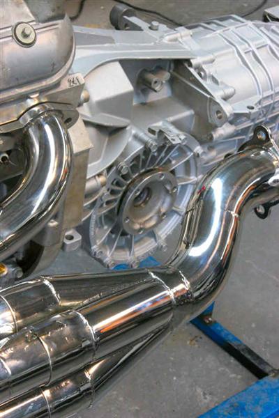

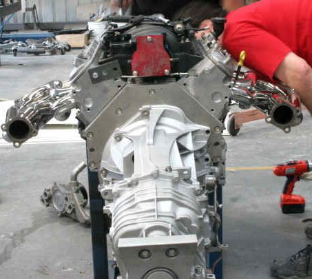

OK, you've got my attention. What's the story behind the pictures?? I've been waiting to hear about someone doing something with a boxter transaxle.

It is the early 5 speed Boxster that is nearly identical to the 5 speed Audi model 012. The 6 speed Boxster in your link is not the same as the Audi 6 speed (01E). That Getrag link is nice as it lists torque ratings of each model; too bad they don't go back to earlier models on thier list.
Andys
hey all, (first post here, been watching for about a year or so)
according to an audi freak I know who is a german parts dealer in germany
The 650 tranmission is the quatro one from the RS6 audi
and the boxter 6 speed is the 380 one,
I haven't seen this in real life though
there should be one thing mentioned about the 650nm though, you can put it through, but only in the AWD set up it is used to have, blocking the rear diff would effectivly put all the torque through the front diff and that will give way before the front diff of the 01* does.
grtz Thomas

The Boxster and 996 transmissions are often cheaper than the G50's... especially the early lighter-duty 5-speed Boxster unit. However, Porsche does not sell most of the parts for the Boxster & 996 transmissions. If you can run one "as is", and maybe replace a broken one for $2k some years later with another used one, then hey why not. A new factory rebuilt unit is something like $4000 with 2 yr warranty. This is why almost no one else is rebuilding these. The main bearing seems to be a problem, otherwise fairly trouble free if not overloaded. 996 Carrera makes around 300-320 hp depending.
The bellhousing is larger in diameter and has different bolt spacing from the G50's and G64's -- not at all interchangeable.
Note that the 996 turbo & 996 GT2/GT3 trans is totally different from the above. Those are evolutions of the G50/52 and G64/51. These are still G50-compatible for mounting at the bellhousing end.
