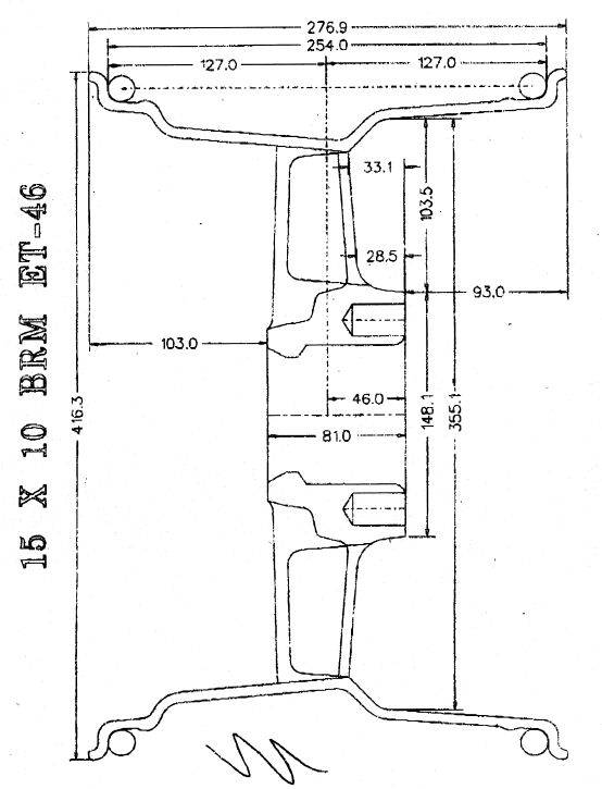

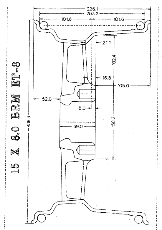

Mk1 wide arch
8x15 with 3.75 inset
9.5x15 with 3.75 inset
One piece BRM
Inset measured from inside bead to mounting surface.
